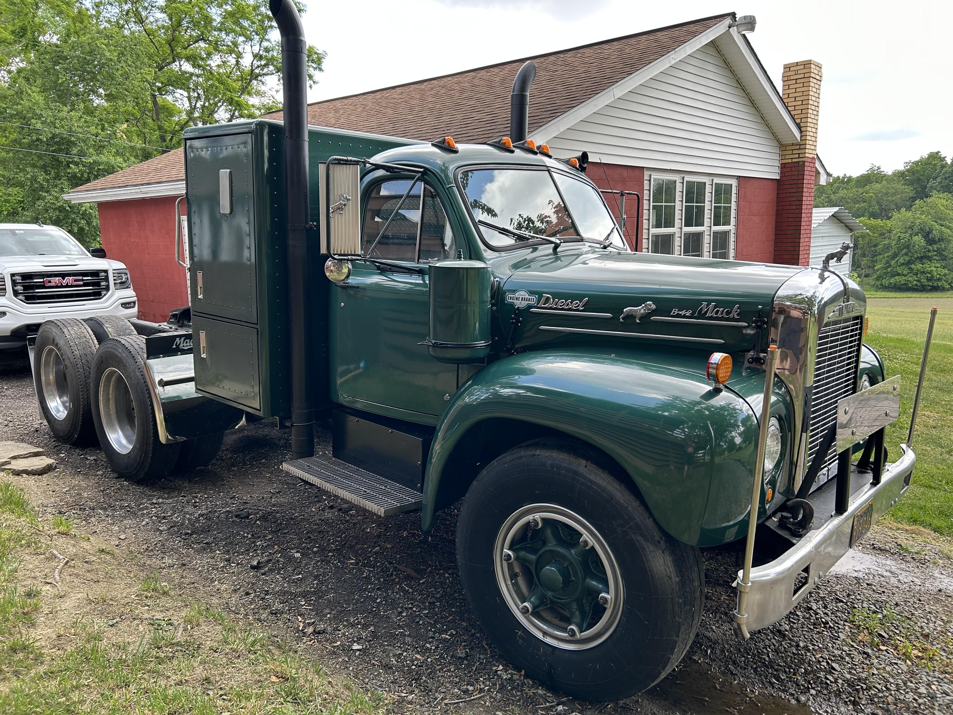

Adding a sleeper to a b model

ThanksVlad and Bob it’s a work in progress next project I want to do is gut the oil bath filter add a dry element and add a chrome riser pipe to it and get rid of the old oil filter housing and I got a spin on filter assembly with a bypass built in so it’s a little cleaner under the hood
If your going to be a bear be a grizzly
Thanks Harry I think on the air cleaner if I gut it block off where the dirty air comes in on the back and seal it up then cut a hole it the top mount a pipe through it then get a filter that will slide and seal on the pipe so dirty air will come in the middle of the filter and clean will be on the out side
