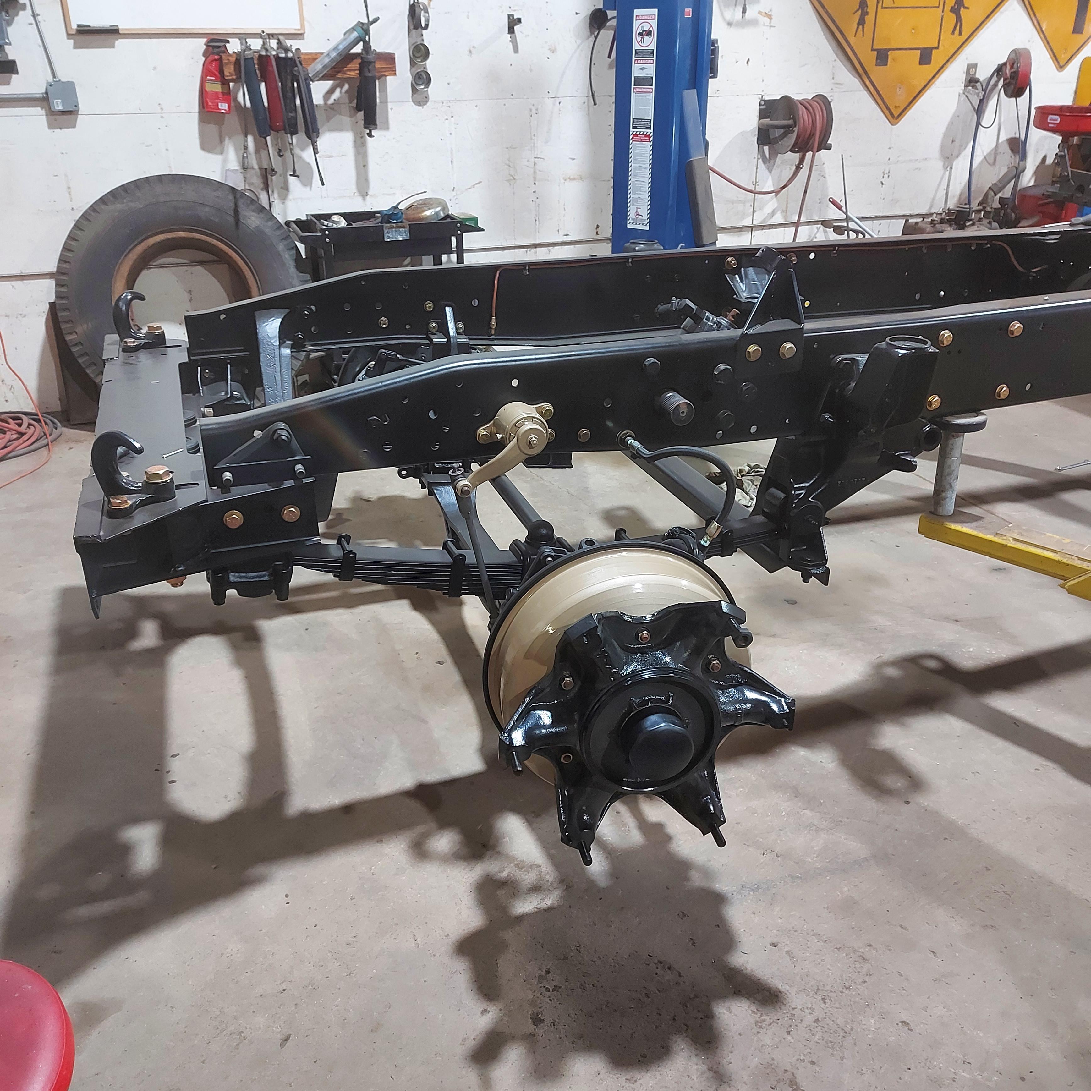

wow that frame looks amazing awsome work if I may ask what are you using on the front ? budd ? hub pilot just wondering
If you check out some of LTK's other projects, you'll see that everything he does looks like that.  Quite the artist.

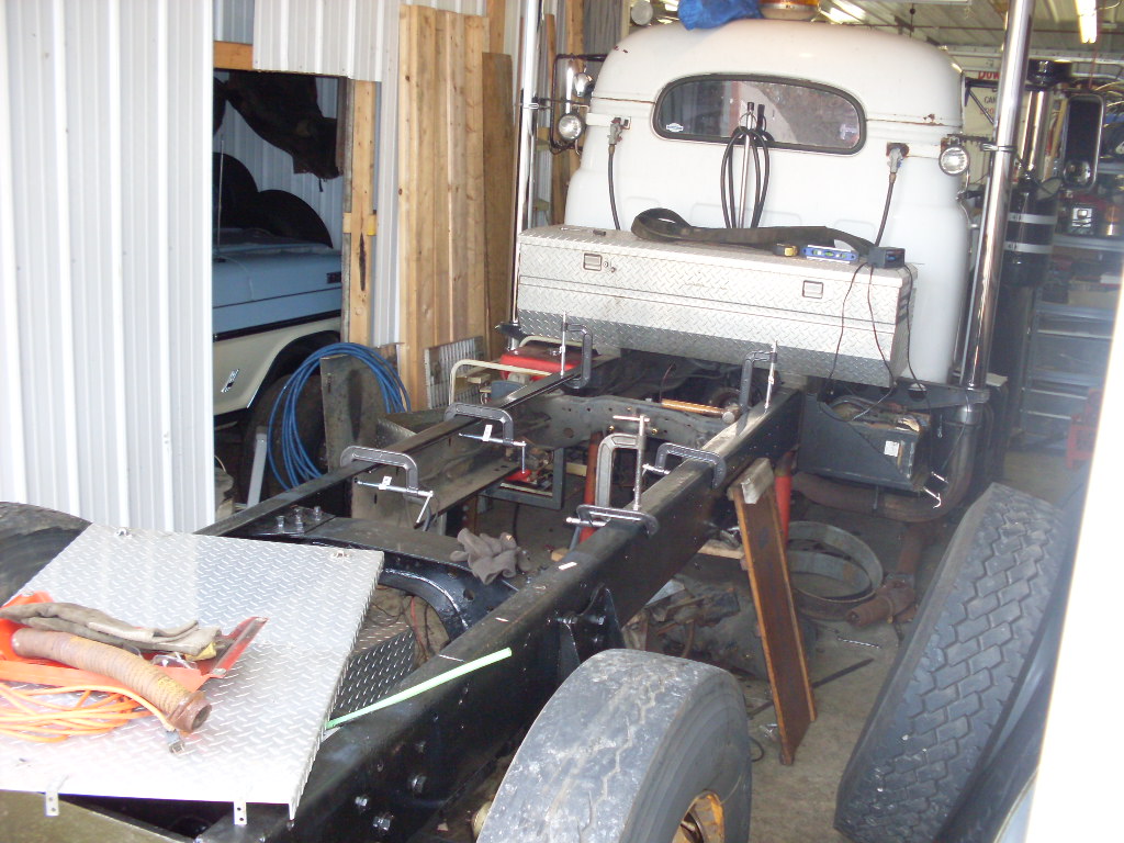

the cut off I used in the rear I think was international there was nothing left of the truck so I don't know and neither did the guy I got it from but that frame slid right over my frame I just squared it and drilled holes through both and bolted it together

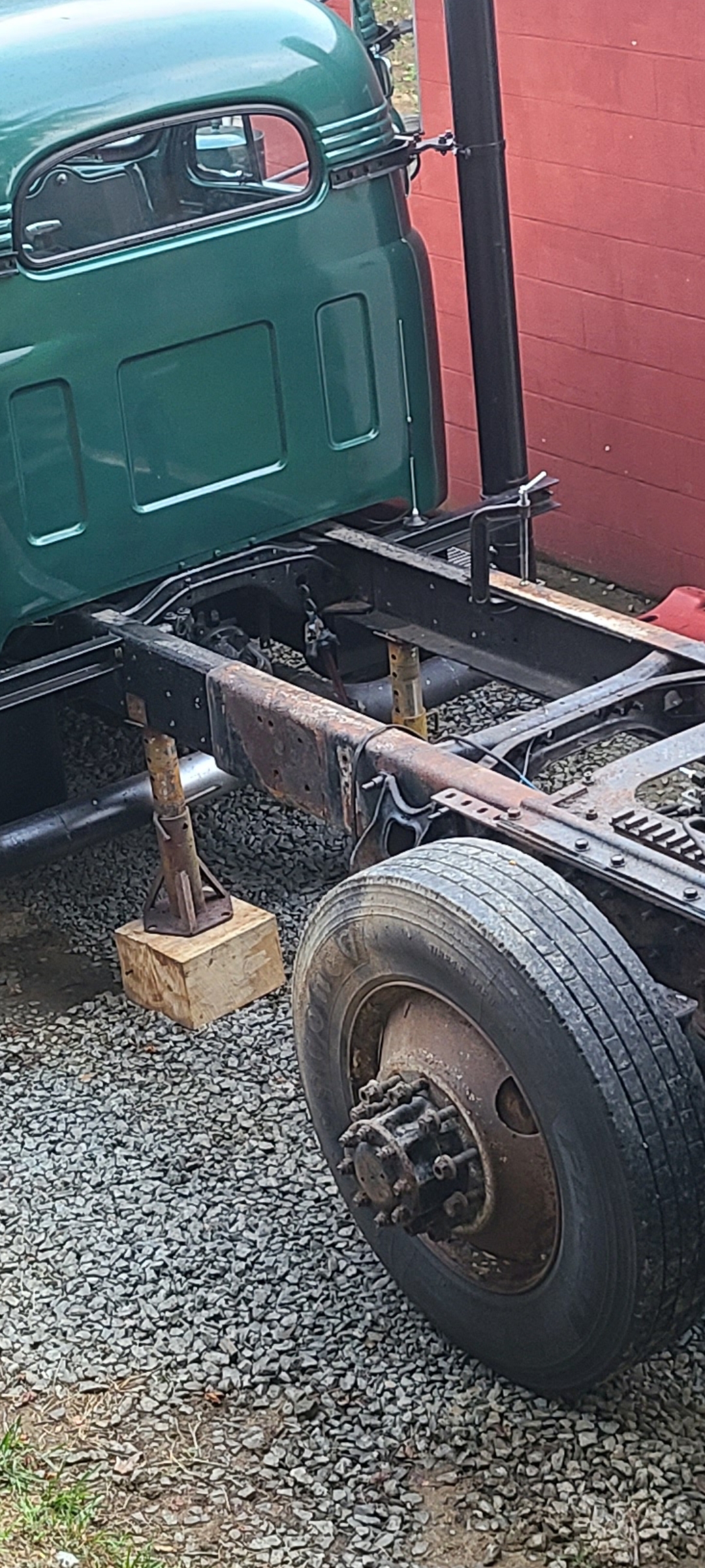

Hmmmm, it never even occurred to me to just graft the frame from a newer truck to my Mack like you and Mean Green did. I just swapped the suspension and bolted it to the original frame. Not sure which would be easier but both ways work. I see you have a late 60's/early 70's Ford pickup in the other room.
I was stretching it so needed to use the new frame.  Mine was only 150" single axle.  Not much room for anything on the back!  Lol.
I originally was going to butt them together but they ended up a perfect slip and I had enough to overlap 5ft.
