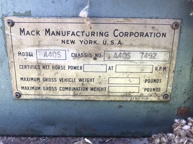

Based on the pictures you posted in the other thread it looks like the axle may already have S cam brakes which is good.
Crawl under there and get some pictures of the tags on the axle and the carrier, center piece.
Changing the gear ratio is not that hard or expensive.

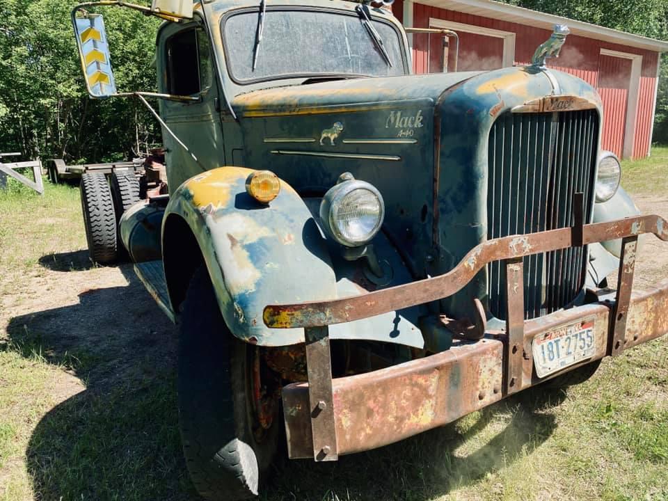

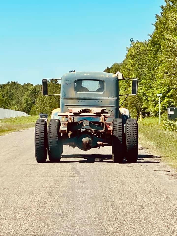

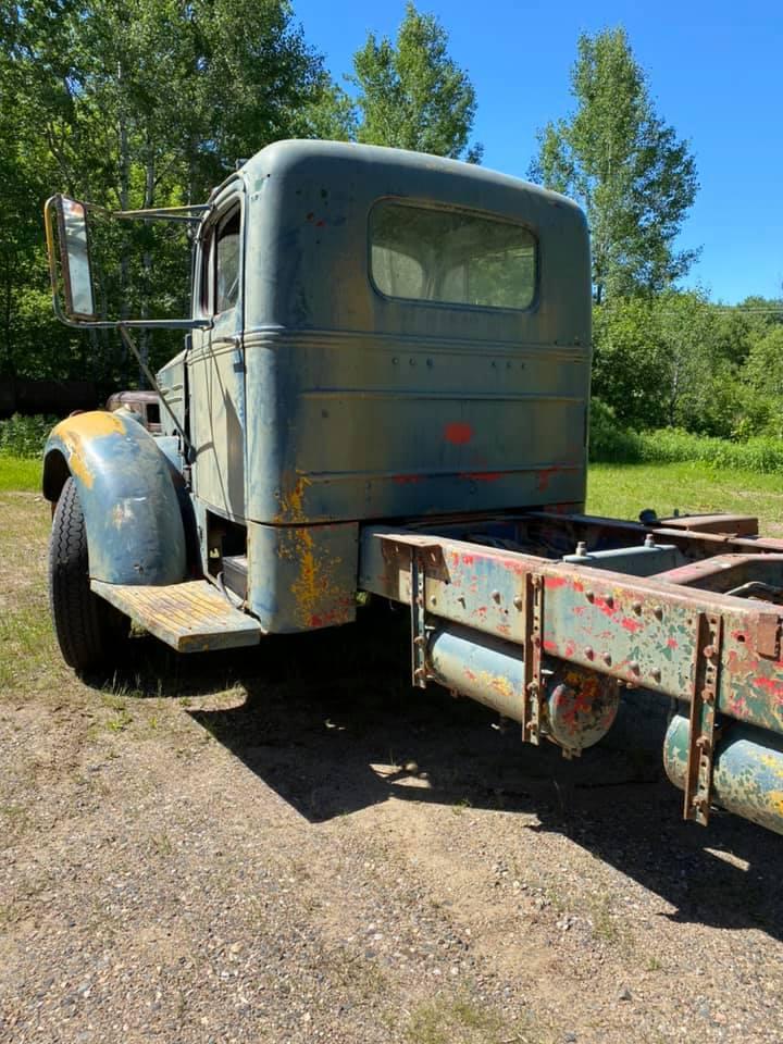

Drove it home today to my in-law's shop.  About seven miles, took it REALLY slow.  Runs like a pup, the tires are very bad.  Temp tank up on the passenger mirror to bypass the old tank until I can clean it.
Learned a few things about it, it is the EN 377 with a Triplex, which makes me happy.
The Montana title says 1952, not sure if that is relevant or not.

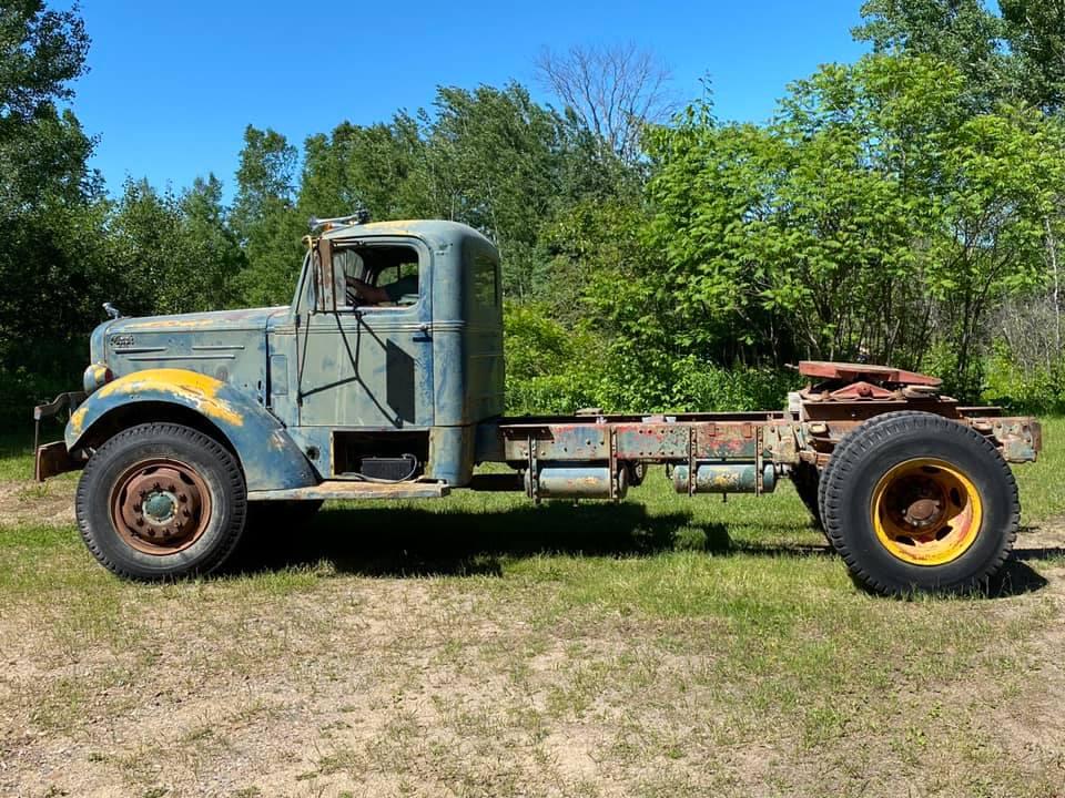

Wheelbase is 180", which is a nice length.  I am officially searching for a vintage sleeper box (for storage, not sleeping).  Hopefully 24-48" range...
Photos coming...

I have the battery box cover that is off in the photos.
I think we are fortunate to have one in this shape for a family project.  Not to down play how much it needs, but to be able to drive her home is a great start.  Taking it a bit at time and keeping it driving.
