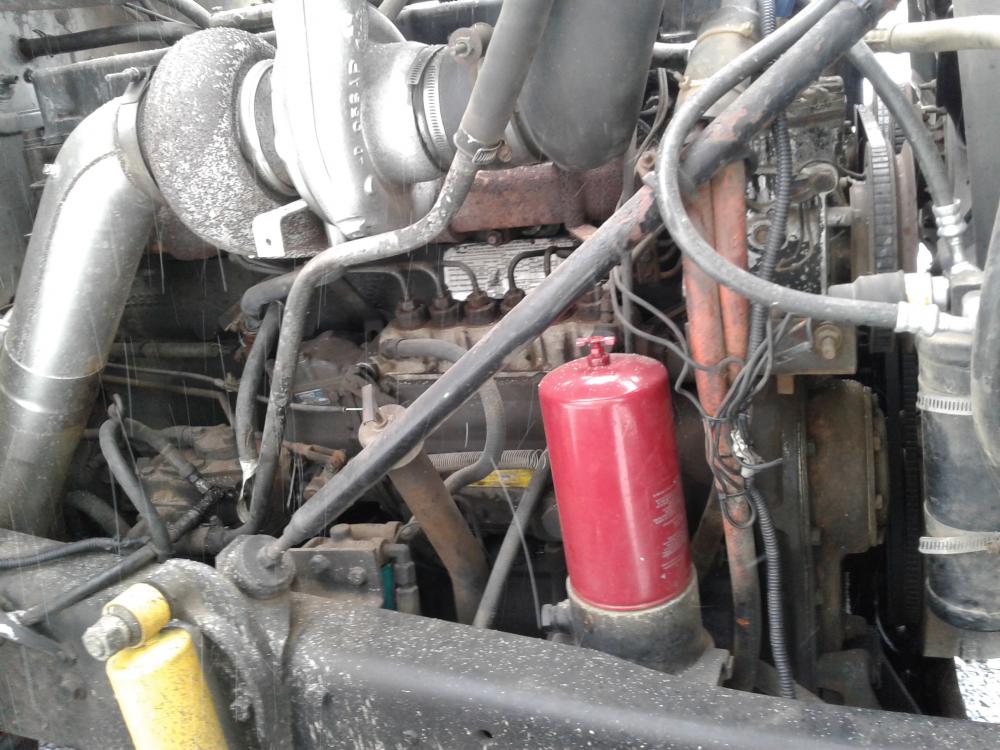

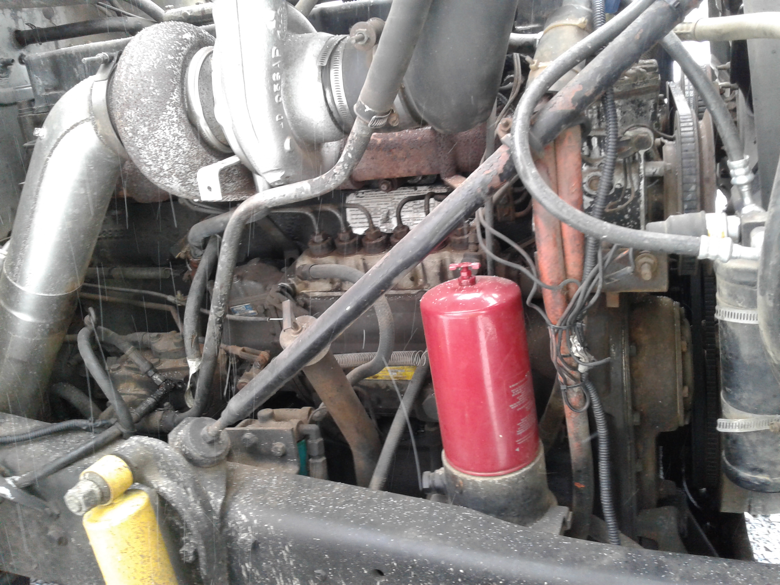

I went to what once was Reading Mack yesterday they didn't have this filter either  It didn't show up in their system??? I have a question about this filter mine looks like it is upside down.. or is the petcock supposed to face up?
Edited by 6368
