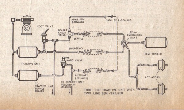

how does this three line system work
When Leyland fully imported some of the bigger trucks here they re did the whole braking system as it didnt comply and I have seen photo's of a pile of brake lines and air tanks on the floor beside the redone trucks
I have asked a few people what the three line system was and no one has been able to explain
Paul
Paul
totally British.... had to get some help as my brain cells, so dug into an old Atkinson manual and found some photos on-line, let's see if this make sense..
Red (Emergency) fills the trailer air tank and releases the brakes, it is a permanent feed to the trailer and why the brakes come on when the line is released. Yellow (Service) it feeds the trailer brakes when the Service (foot) brake is pressed (why you have two lines going into the brake chambers, one Service, the other Emergency). The Blue (Auxiliary) provided a Secondary brake by the use of a hand operated lever or Dead Man as it was more commonly known, this braked the drive and trailer brakes and not the steering axle

there were a couple of twists between spring brake trailers and regular actuators for getting them home when failed, also, pulling a european trailer involved a bit of re-plumbing of the blue line.... but too many years have passed and too many pints of beer consumed to remember all the details.
