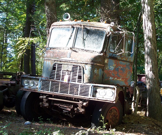

22 hours ago, Freightrain said:
Looks like it has brakes on it.   That's what I'd like to find for my truck.
You have no brakes,Larry? Lol....or just no front brakes?  Al
