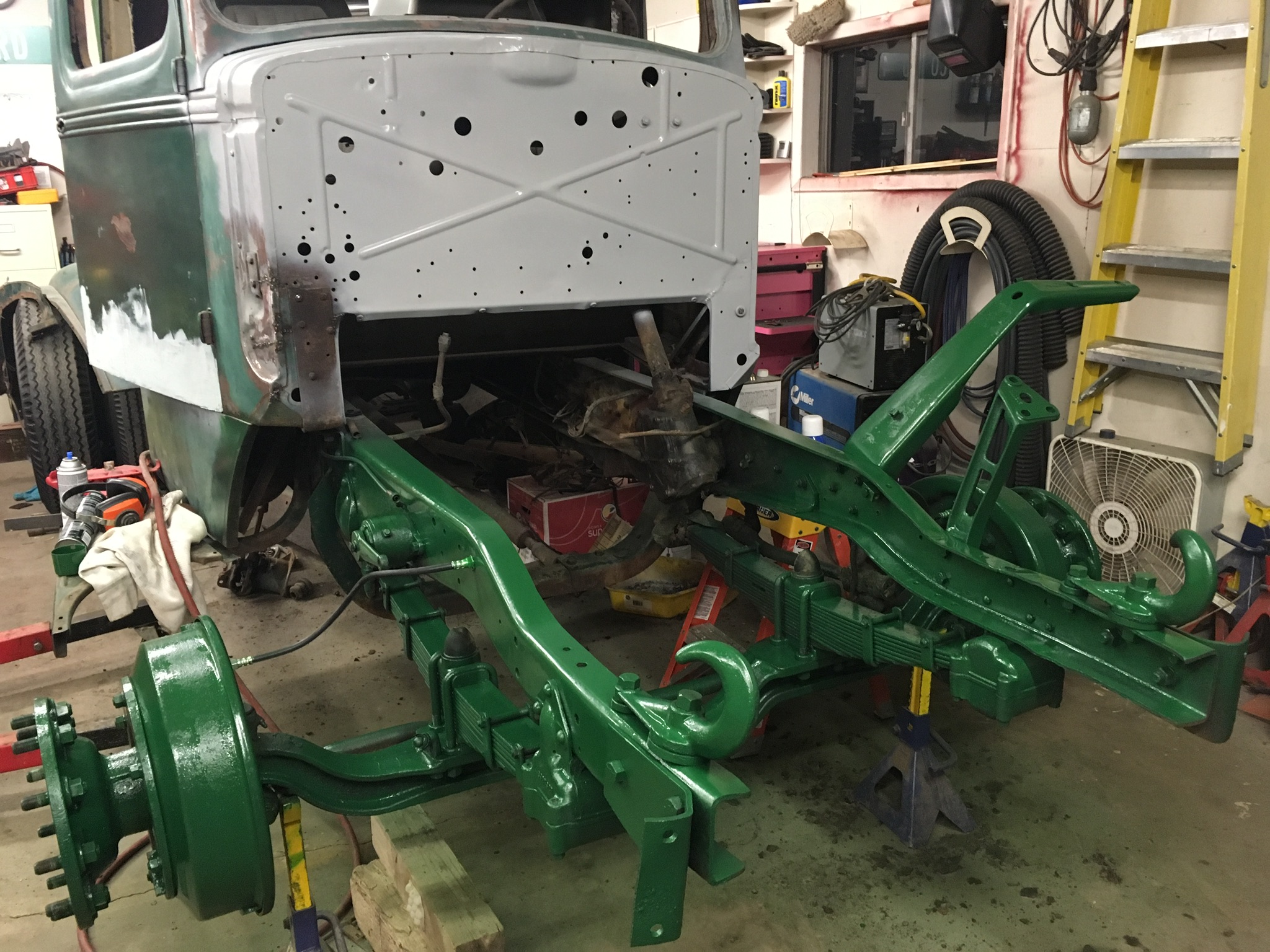

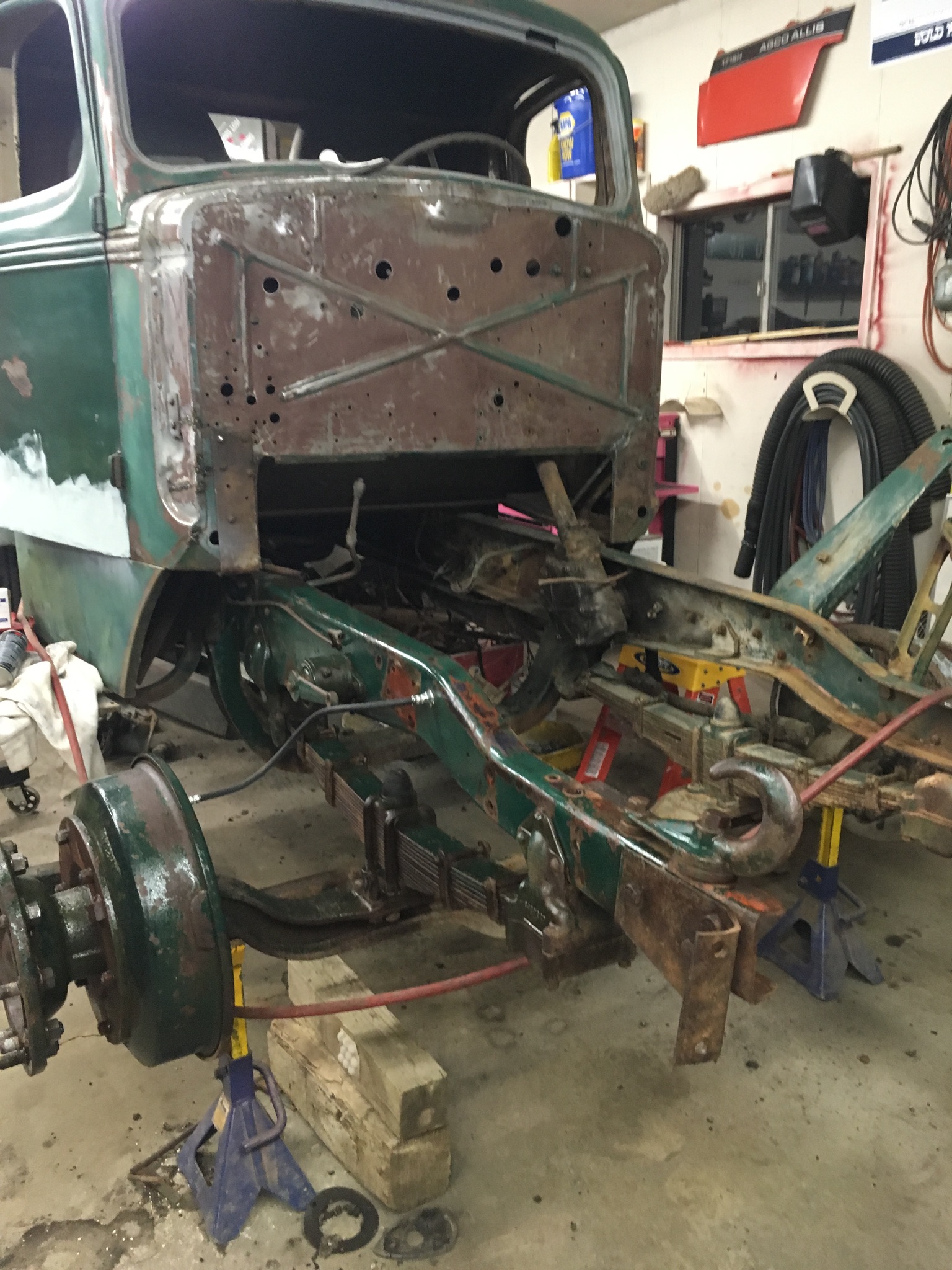

This is the updated photo of Gus as of 1-13-2017...I'm welding some cracks in the firewall and saving the 800.00 to have the radiator re-cored.. just ordered rubber isolator for Diesel engine modification... working as fast as we can,  but the lack of available parts is concerning... if anyone knows where I can get doors.. please let me know!   These are the parts I am hunting for:

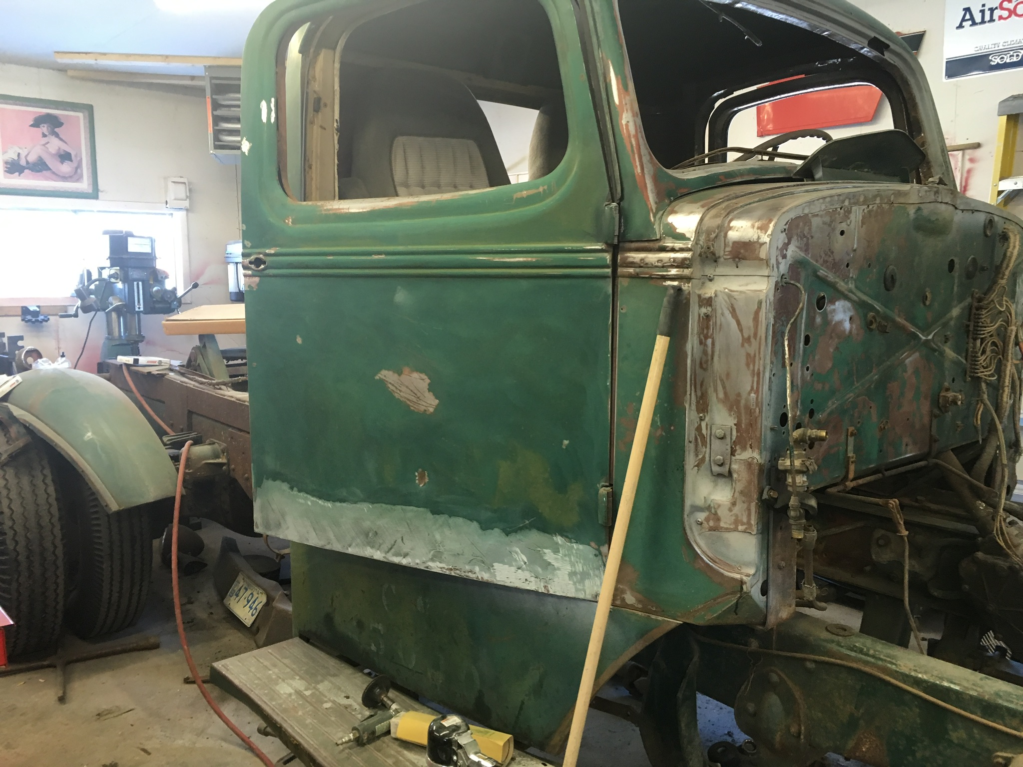

You have a mig welder you can make patches for the lower door sections. Fairly cheap and easy to make up. As for the glass, it is all flat pieces, If you have the regulators , roll them up and use heavy cardboard to make a templet of the glass  to fit in the channels. Both door glass is the same.  A good glass shop can cut them for a tenth of what it would cost for used glass.

On Friday the engine mounts will be here, and we will be welding the new engine brackets together this weekend.  Then the 4cyl diesel engine and transmission are going in.  The next step will be to order the driveshaft, as the original is too long!   Brake booster will be sent off next week, as I think I have enough pennies for that project.  Then the radiator issue...I have to try and fit a charge air cooler in front of the radiator...more modifications...while trying to preserve the original foundation for the old motor which will go back in some day!

I have been looking for youtube videos on how to reskin doors, ..however, I think I am going to attempt patches first,  thanks Paul!

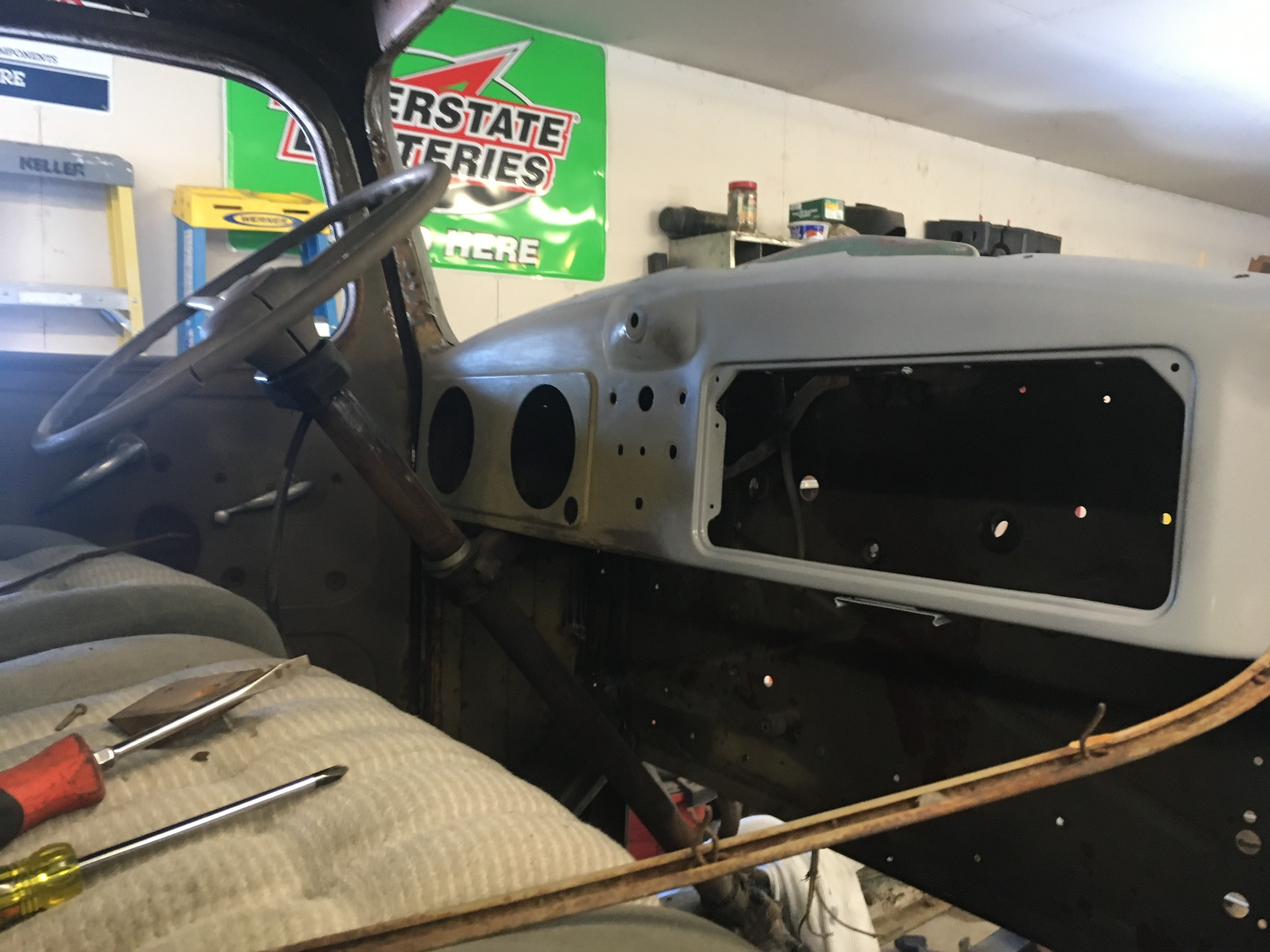

Tonight, I finish welding the cracks in the firewall, and the cab corners...prime and prep the firewall and the front part of the Chassis, and finish the paint...I will post before and after pictures.

The patches are easier. Pick up an inexpensive flanging tool form Eastwoods and you can use the lower   patch sections from a 40's to early 50's Ford or Chevy pick up. they are flat like the Mack and you can always shorten one end to fit you door. You only need to do the lower 6 or 8 inches. Biggest thing to learn is to do spaced tack welds so you do not warp the panels. Piece of cake.:)   Paul

Thank you for the tips!  This is a huge learning process!  Everyone on here has been great!  I am posting before and after pics of the front chassis tonight.  Paint and prep started!
