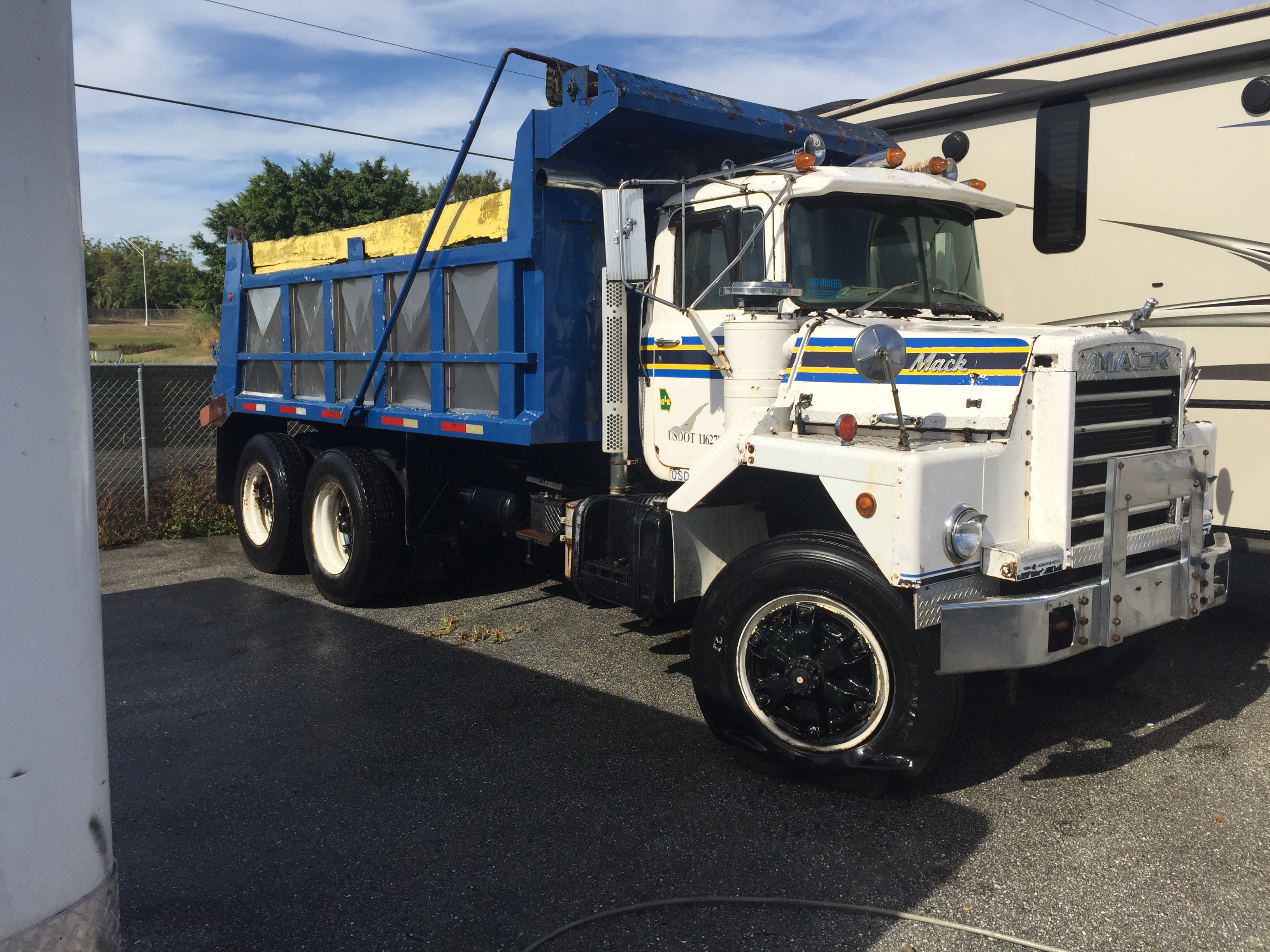

 Hey guys and gals long story short I am the new owner of a 1974 Mac dump truck. I'm a decent shade tree  mechanic  but still don't know if I'm taking on more than I can handle . This truck starts and runs  in the PTO works does have some rust and definitely could use tires all the way around .  Trying to figure out if I want to fix it up and keep it for a side job ( hauling or what not ) or if I should sell as is (  I have had some pretty intriguing offers ).  Honestly when I came in to ownership of this vehicle I was going to simply junket or party now  Luckily I've ran into a few old timers that did tell me a little bit about what I have . But would appreciate  any knowledge you would like to share . Thanks

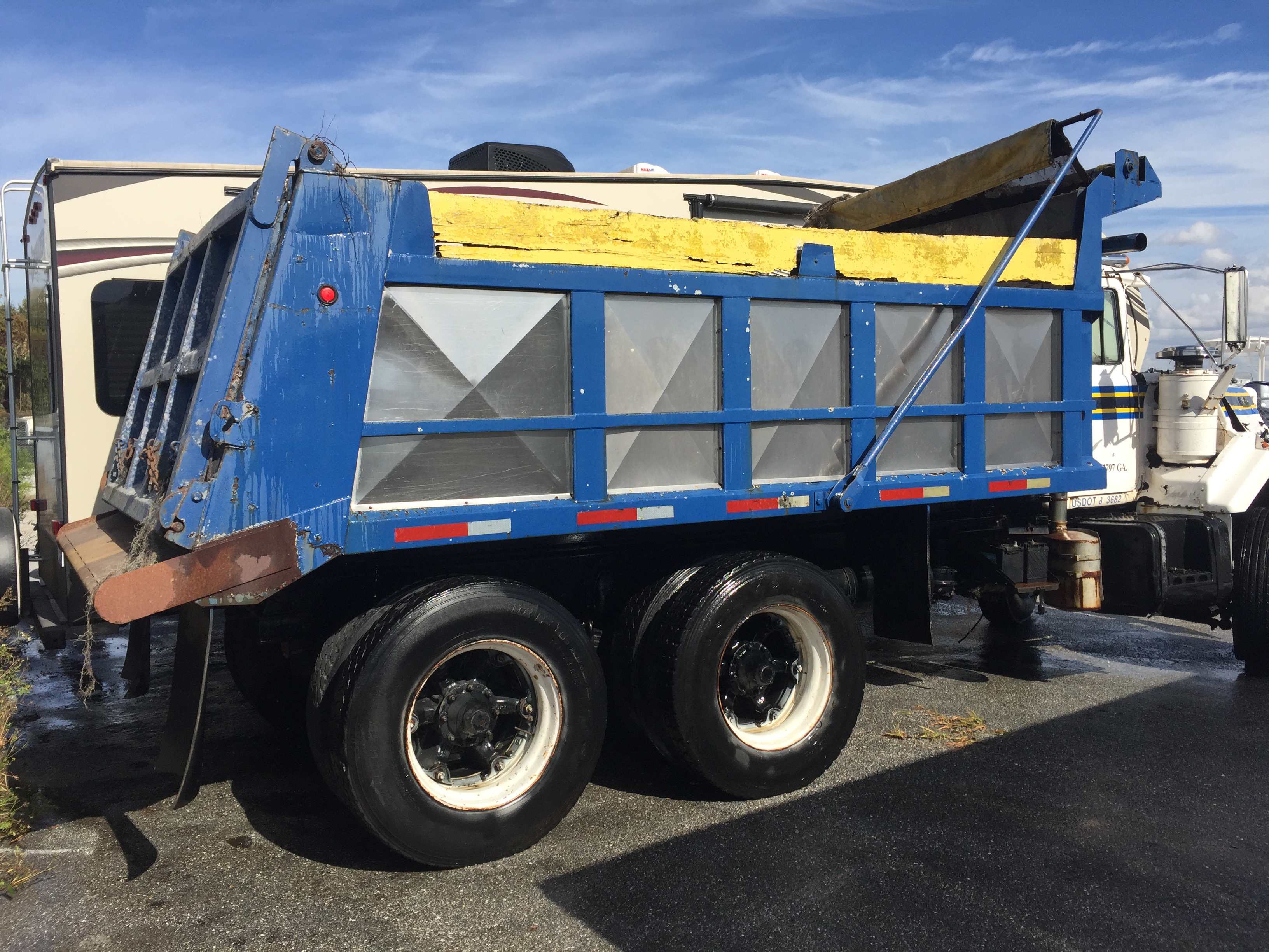

Awesome site truck With out seeing it in person real hard to give decent advice It  either has 44 or 55 rears by the look of it Can't make out the rear suspension Camel back I assume I also assume It has a 237m with 6 sp trans !
I sure wouldn't part it out! You got good history there!
Edited by fjh
wow excellent find....looks ready to work already   i would fix it up and use it.....its probably not going to be the fastest rig on the road,,,but in florida you probably dont have too many grades,,,,that would be the only problem with a 237..you could probably get 5G,s easily as is..good luck,,,,and welcome aboard.bob
Looks like a good unit, would be hard pressed to fine another like it. You could make a decent buck working it. Its definitely not something to part out. Plus pars are easily available for it.    Paul

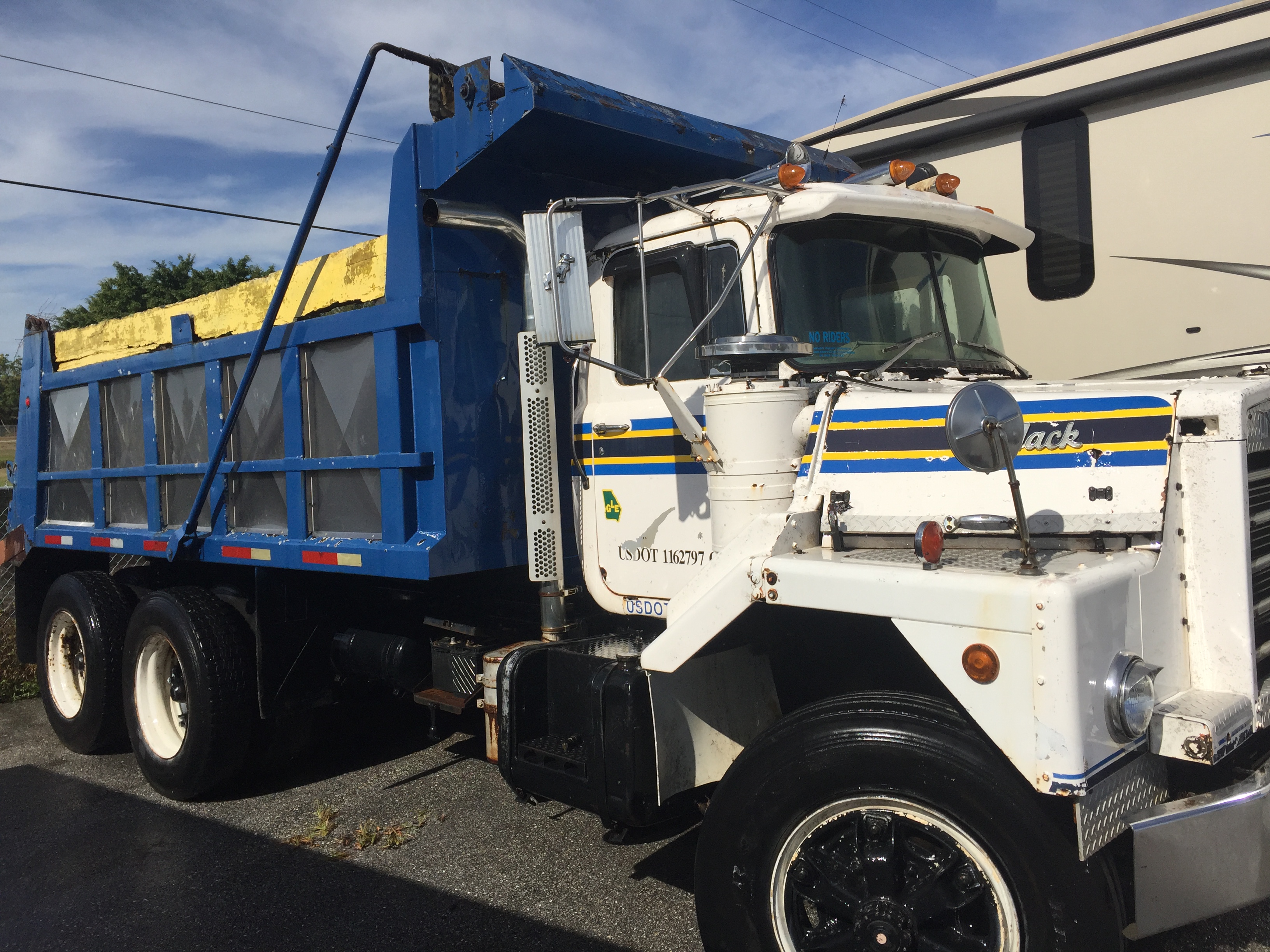

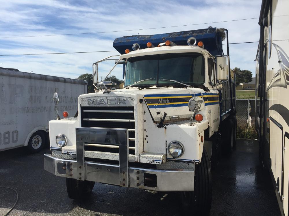

Oops, I see it has a silver bulldog, might not be a Maxidyne (237) after all, and if it's not, it would have five on the left stick with reverse and two, three, or four on the right stick.  Pretty unusual by '74, though, most were Maxidynes by then.
