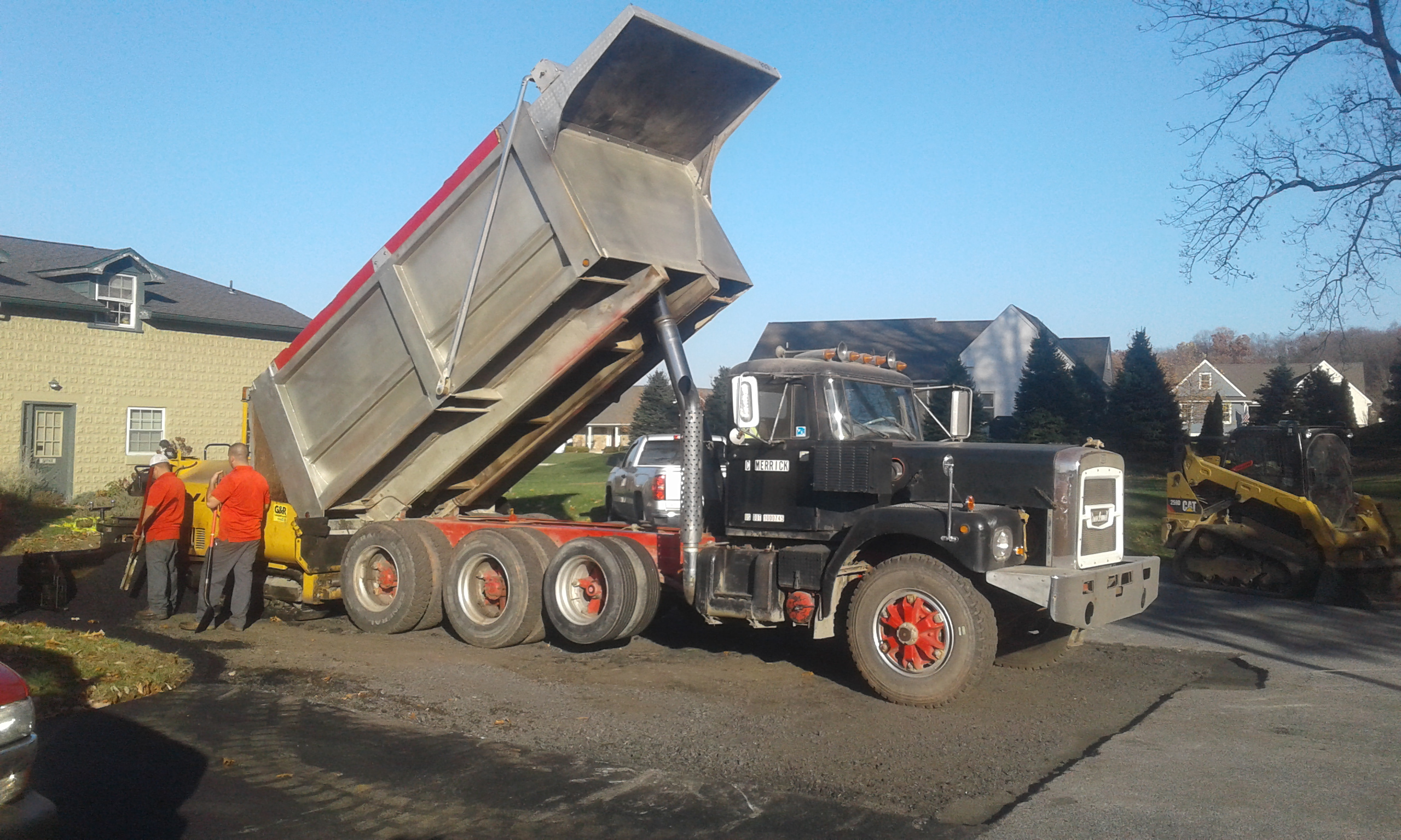

I really like the look of trucks with tall 12 x 24.5 rubber.  How heavily spec'd of a truck did it take to option the larger tires and wheels?  Were they available on lower GVWR trucks too?  For example, could you spec 12.00 rubber on a R or RW with a lowly 38k or 44k rear end?  Or is that too light to justify the bigger tires and wheels?
Did they have to make any special accommodations to the truck to fit them?  Do they use larger spring blocks under the front springs?  Or is it just the larger wheels that give those trucks a noticeably taller stance?  I've always been curious.  Thanks!

It certainly does give this truck a "let's get down to business" look, doesn't it?  I like the look.  I agree with jhancock that for work, use the right combo of specs for the application, but for a hobby truck, this looks great!  I'm also not a big fan of spokes on the front of a Superliner (all other trucks should have them, however!), but in this case I think the bigger rubber and higher stance does work with the spoked wheels.....
I would venture to guess that that truck must have an 18k or larger front axle, my rw713 has a 12k and I run 12r22.5 rubber on the front of it  but the pictured above truck has at least another 4 in. of clearance than mine.......the smaller fuel tanks makes that thing larger than life......definitely creeper friendly!

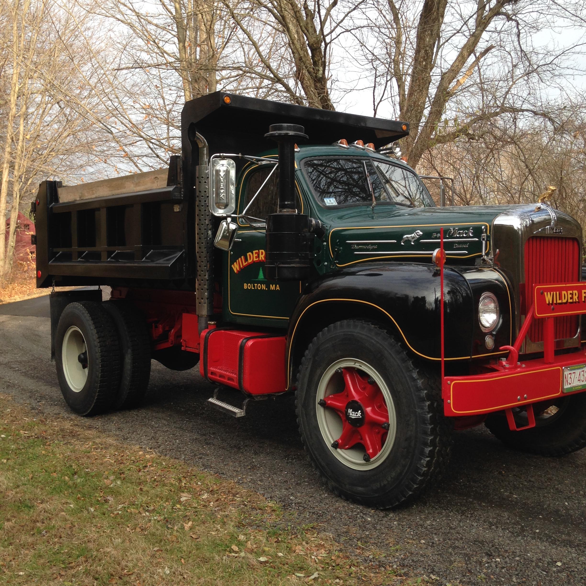

Thanks for the correction on the sizes.  I'm just gleaning all this stuff second hand from photos like the one I posted.  It can be hard to make out tire sizes in photos, of course.  Yup, it appears they are 12.00R24s... not 24.5s.  Whatever they are they look awfully good.  I like 'em on Bs, Rs and RWs.  Course, they'd probably look good on about anything.
So you're saying that you could've theoretically ordered that big rubber on a truck that didn't necessarily need it?  Just for looks?  If that's the case, what would be required to fit wheels and tires like that to an ordinary truck?  Just curious.
