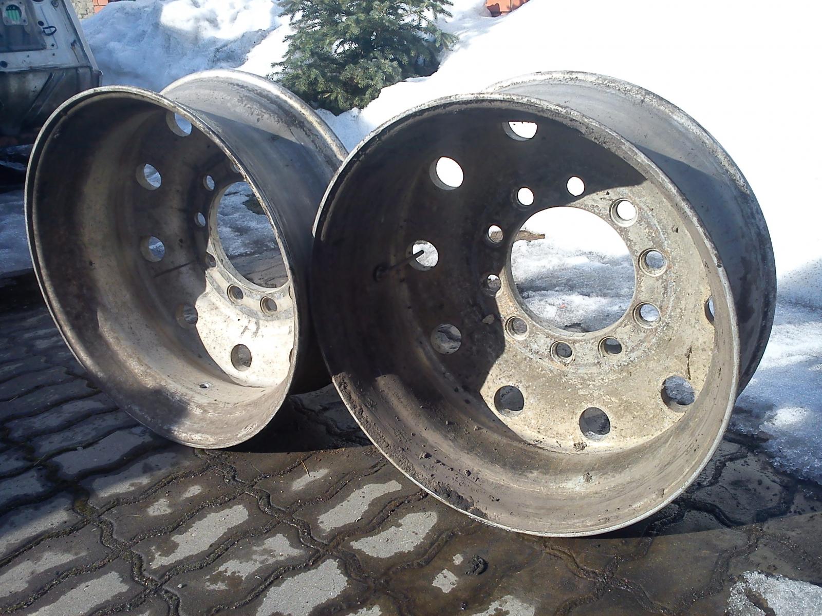

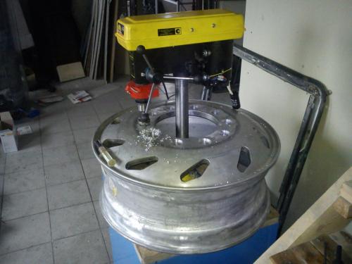

By the way re-drilled the holes in the hub-piloted wheels to put them on studs.
Had to increase the hole's ID and made 45 degree tapered cavits.
Put those wheels as the inner rear ones.
Long while ago I asked on here of how to do it and Mike Superdog said me "You can not put hub-piloted wheels on studs".
Now I know he was almost true about that.

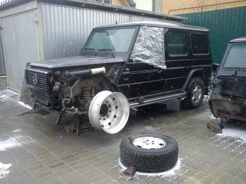

Not so bad Ray.
There were no real lug nuts, just 19 mm bolt heads. I took the extra brake disk off Mercedes, cut it around with a lathe to form a seat surface for Alcoa.
Than bolted that part onto the existing Mercedes disc with Mercedes wheel bolts. Then put Alcoa with common bolts to the disk through the holes I drilled for.
Had to block Mercedes interaxle diff to not weld it up when spinning, had to remove the rear prop to get the vehicle unmoving.
Than had to block the front diff for the same purpose and jacked the other wheel.
Car did about 50-60 mph during the work, got 1000+ miles on it and spent 50 liters of gas. It's G500, 5 liter V8.
