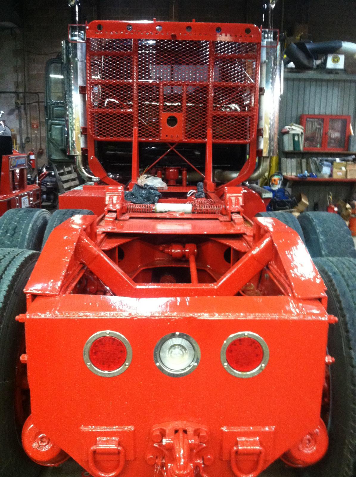

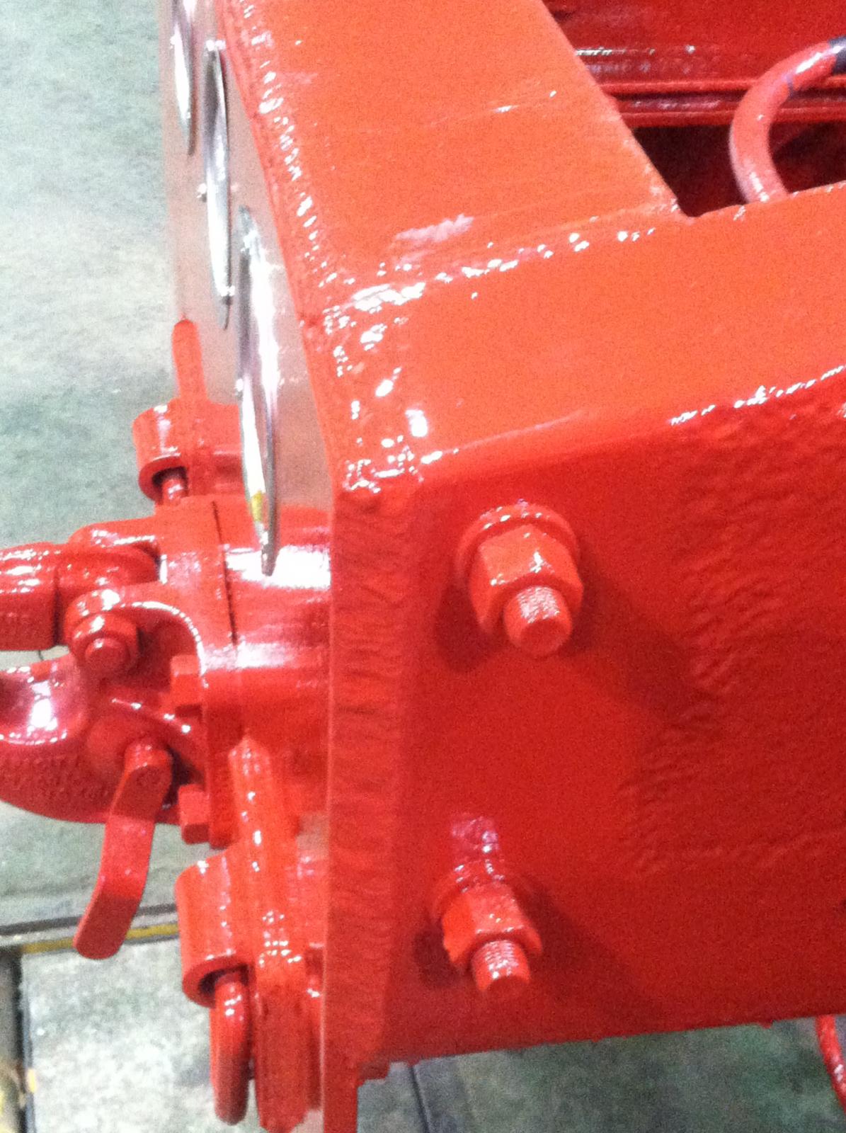

This is not a bolt-on, mine is all welded and a very nice job by previous owner. It is heavily braced, has a 40ton pintle hook with plug on the side underneath.
Jack that is a Buyers pintle hook. I have the same one on my R model/ It is actually a 45 ton.
Rob
Yeah, that was me...GVWR of the trailer I am going to pull is 4800#!!! I cant imagine even lifting and moving a 33 X 24 peice of 1 1/2 in thick piece of plate steel! Much less the size of welder and number of passes to weld the 1 1/2 plate! I am not going to pull a dozer! My stuff will be 3/8ths inch plate...braced (welded) behind with 1" square tubing (triangulated) for an effective thickness of 1" plus! (for all you engineering types)!...AND bolt on, tying in the strength of the rear crossmember!
