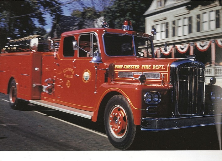

This is my 1958 Ward Lafrance, It was in service for 32 years 1958 -1990 , thats because it has a 671 DETROIT IN IT AND IT PISSES PEOPLE LIKE 1958 F.W.D. OFF SO THATS WHY I AM YELLING SO YOU CAN HEAR ME !
MADDOG93:
Is that the Ward LaFrance that was in service in Alexandria, NH for several years? I know that they had a Ward LaFrance like that and a 1957 Mack "B"; both came from Port Chester, NY. I saw the Mack
when it was in service in Alexandria.
bulldogboy
Yes it is I drove both the Mack [1981] then the Ward [1991] up there from my dept. I have them both in my barn. Bought the Mack in 2000 then the Ward in 2004 they have been together for 45 of the 55 years together. only 10 years apart when the Mack left first. My photo to the left is on the ramp at Alexandria !
I have a photo of the Mack when Alexandria had it for sale. Later, I saw it in Harvey Eckart's book, "Mack Model B Fire Trucks". Glad to see that it was saved. You drove it to rural Alexandria? Must have hurt to
leave it behind. Alexandria liked having the Mack in their department.
bulldogboy

Like it was said , If you can't drive them then at least you can look at them when you open the doors. Here are two of my fire engines in the barn, 1958 Ward Lafrance and the 1957 Mack B-95 both X Port Chester New York and then another 15 years or so in Alexandria N H. They have been together now for 55 years. Bulldogboy look on Gregs list to see the 1957 FWD that was in service in Alexandria at the same time frame. It must have been in storage for at least 10 years.
