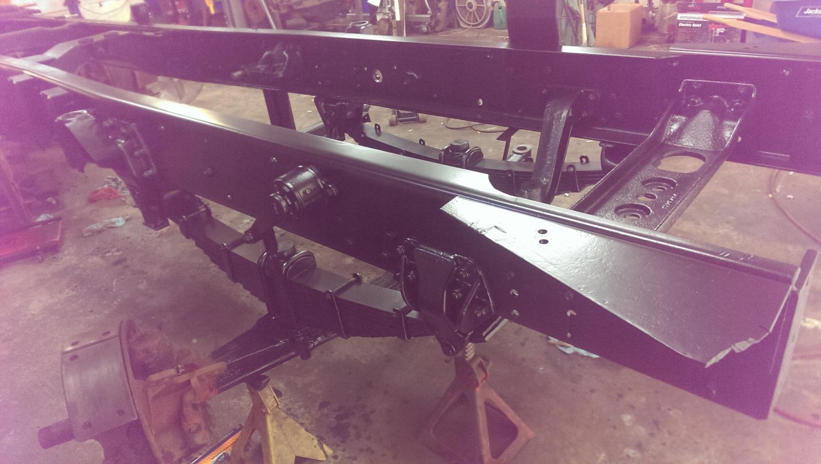

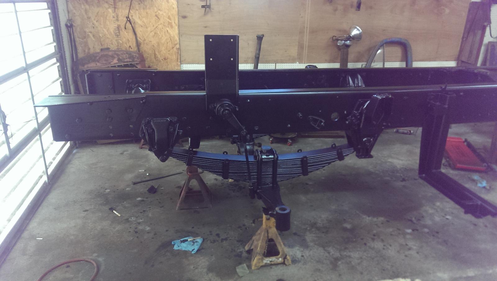

Another B81 build
mackmb212 replied to mackmb212's topic in Antique and Classic Mack Trucks General Discussion
Yes there has been some progress, I been having problems uploading pictures. I got the engine painted and put in the chassis.I took a road trip to Massachusetts and bought a vary solid cab and perfect hood and a bumper. I also had a good friend of mine Paul and his dad come down and fix that broken piece of my trans case. The last few pictures are of what they did. There is no weld just pins. -

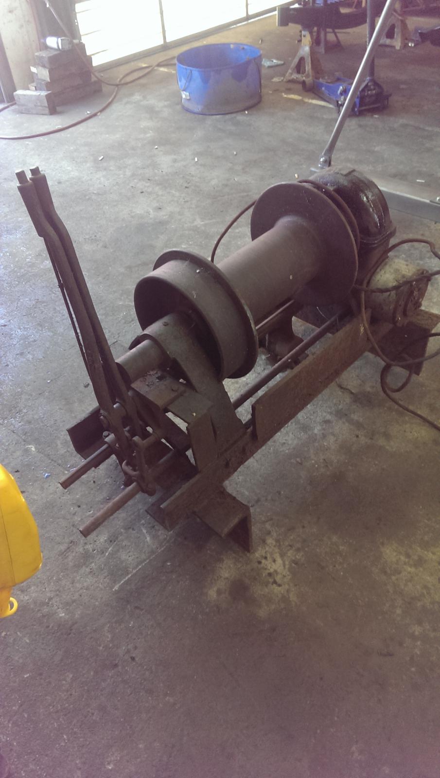

tulsa winch info

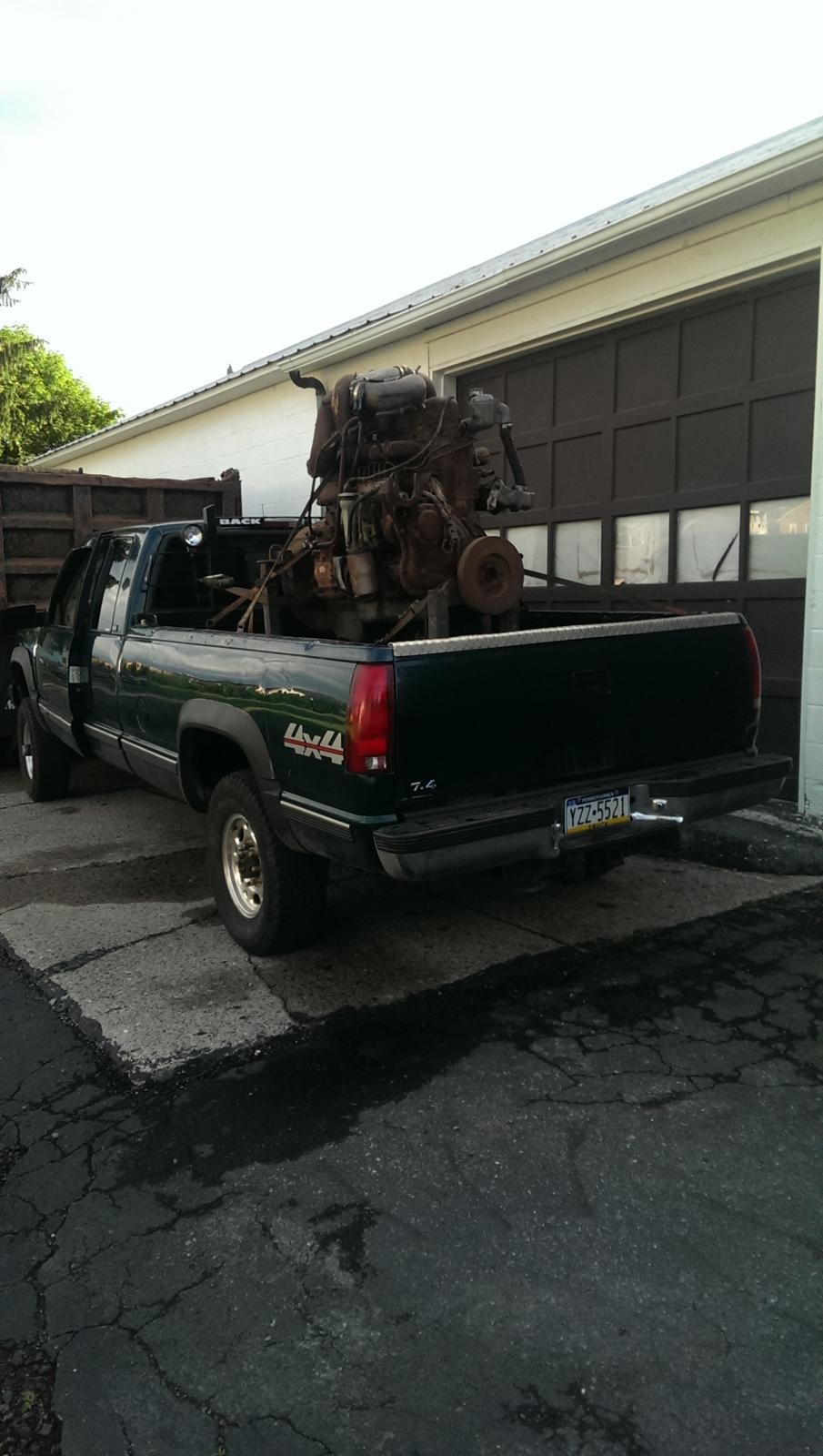

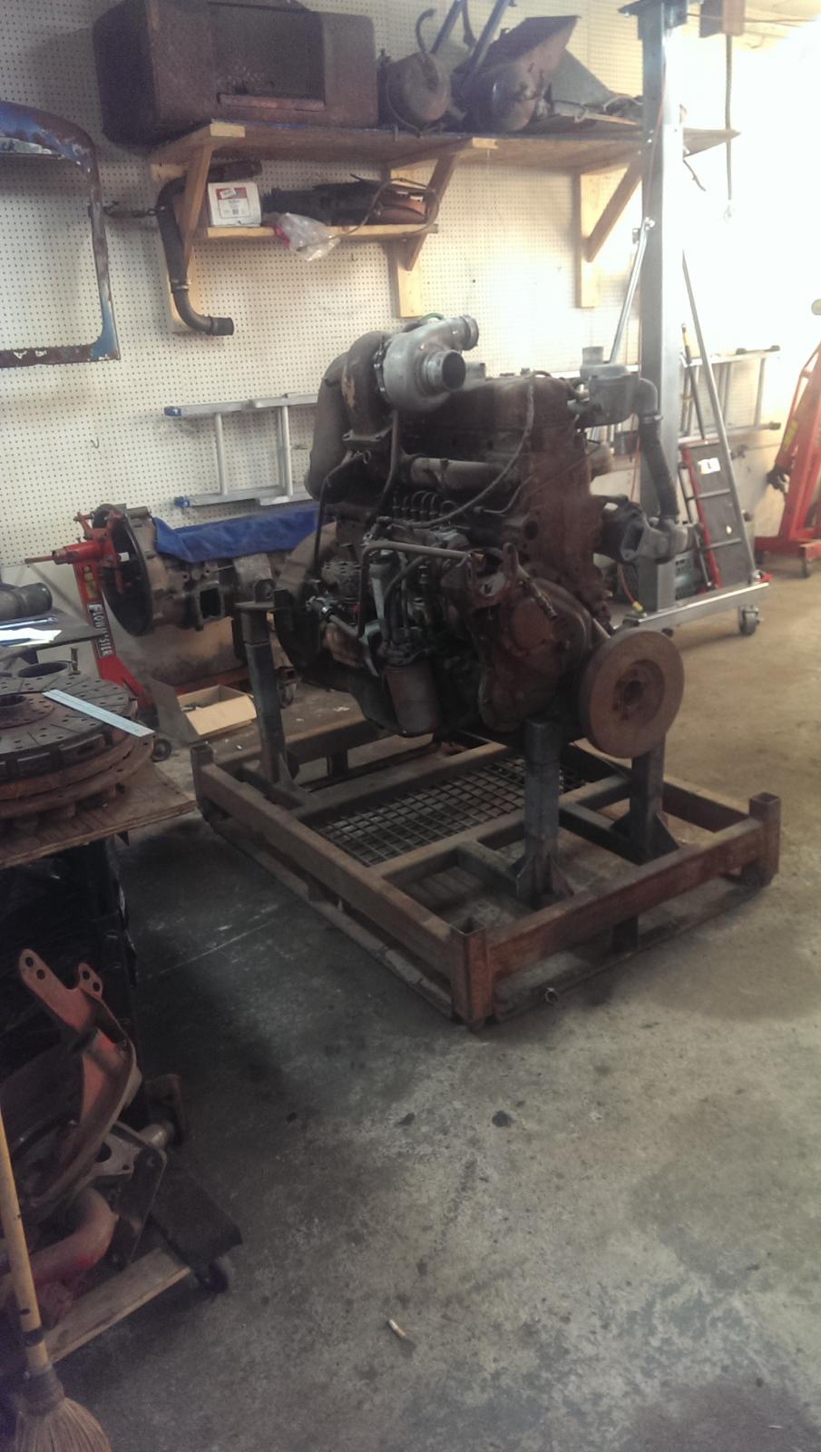

Another B81 build
I wanted something with a little more power and the head gaskets were bad and it took about 45 seconds to show oil pressure -
Another B81 build
the picture of my pickup with the engine is the 237 I did put the 711 in the pickup as well and hauled it to the big yard in the sky. -
I been looking for a winch for a long time now a finally got one. What I am looking for is information on them. This one has 23L stamped in the top to the gear housing. I have been looking around the web and on eBay for information like operation and what leavers do what on it, the capacity, ect. I never really seen a post on here with this topic discussed. If anyone had a rope reel laying around for one of these I would like to buy one.

I'm happy to report that I been making good progress with my truck, in the restoration and with finding parts. I finally got some paint on the frame and working on getting the engine and transmission painted.I found a 237 with a Jake brake to replace the 711 and pickup up a Tulsa winch. -
