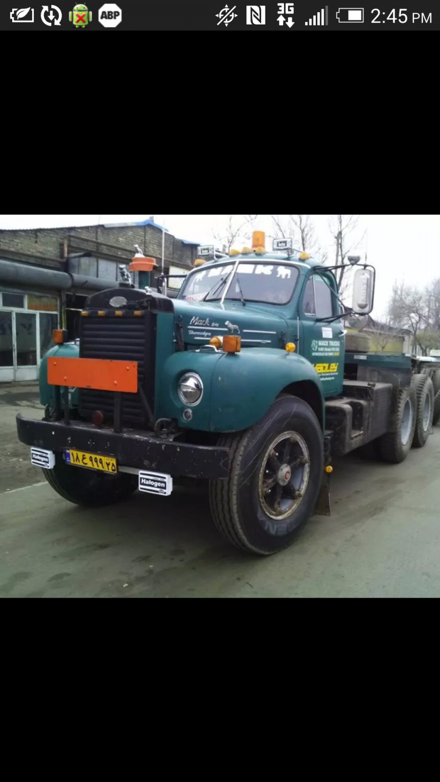

  6. could this be what you're talking about ? I found this on Facebook and was wondering what it was.

  8. At the end before it drives off the cliff it sounds like it has a detroit in it ???
