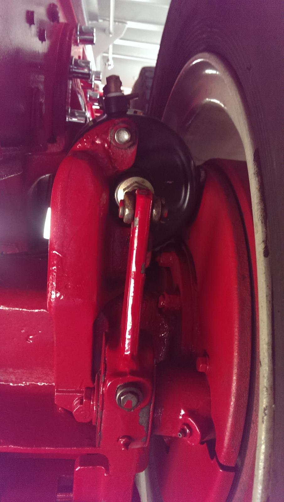

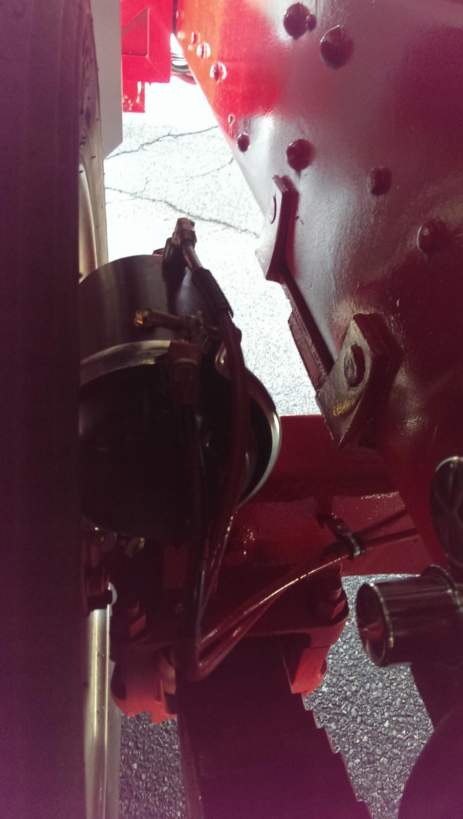

  1. This is something I'm currently working on as well for my b81 the only problem I found so far is the maxi chamber I have has 2 ports on the service brake side one will be sticking almost straight up but the other port will interfere with the inspection plate for the brakes but only on the driver side. Here are a few pictures from a show I went to.this is a b81 dump

  9. A friend of mine bought a b61 dump and it looks to have 44k rears but the brackets look to be the same as mine and I'm pretty sure the truck has there's maxi chambers on them I'll take a few pictures when I get down there
  10. here is what I found today. Maxi chambers I have to find out the diameter yet though. I'm guessing these will give enough brake power and then a parking brake as well.
  11. Well I haven't made too much progress on my truck but I'm back on the project. I got the drive shaft out and the trans out last night. I was working on the front axle back in the winter and discovered I need king pins and a deal fell through for a set of 22 in hubs. I am also trying to figure out what to do with the rear breaks, I would like to put modern cans on the truck and the smallest one's I can find are 24/24 chambers but there a little to big in diameter.
