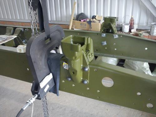

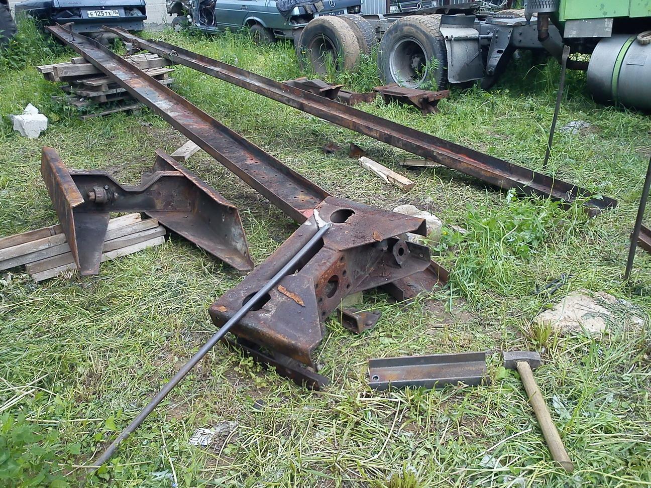

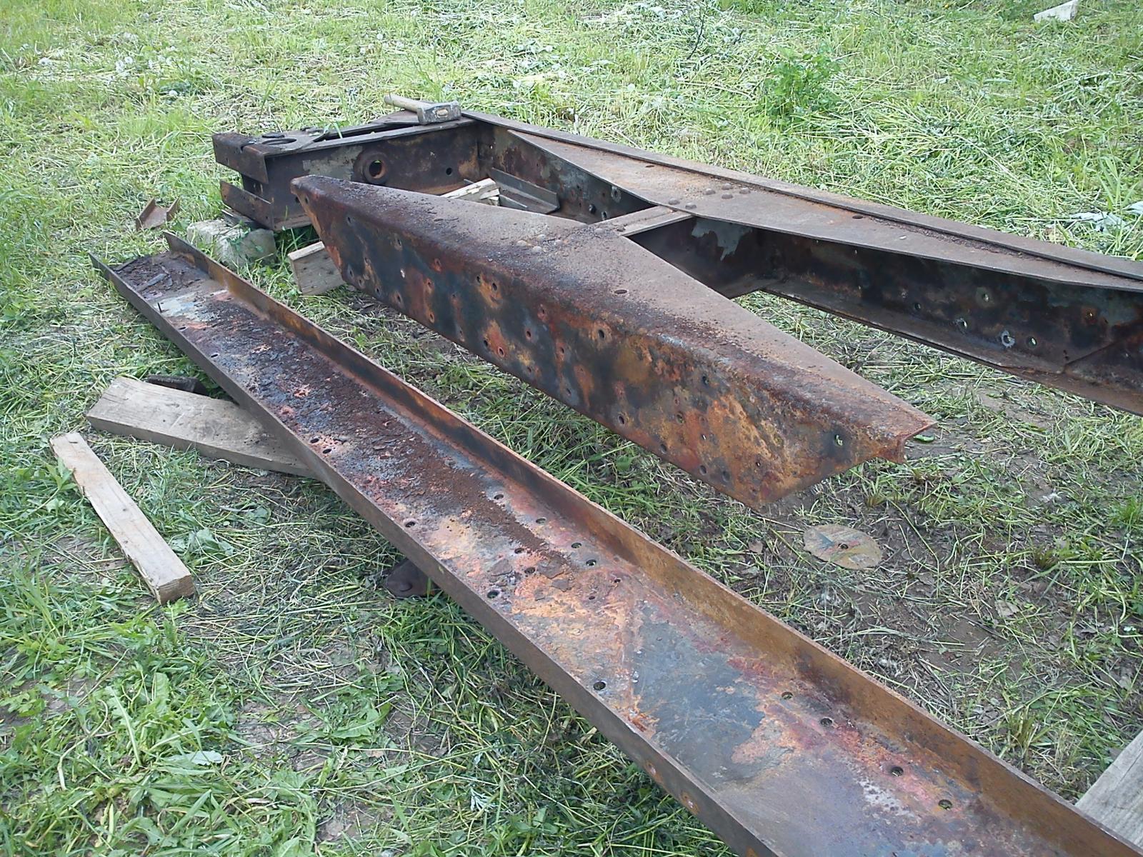

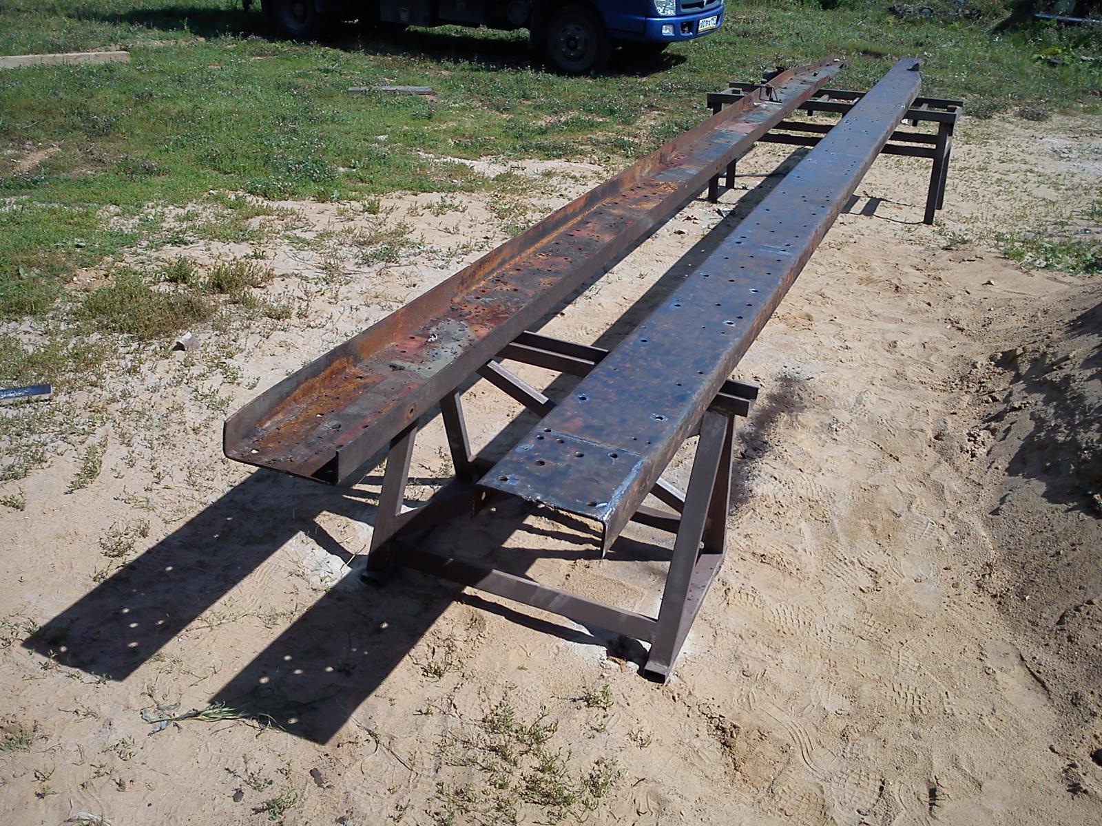

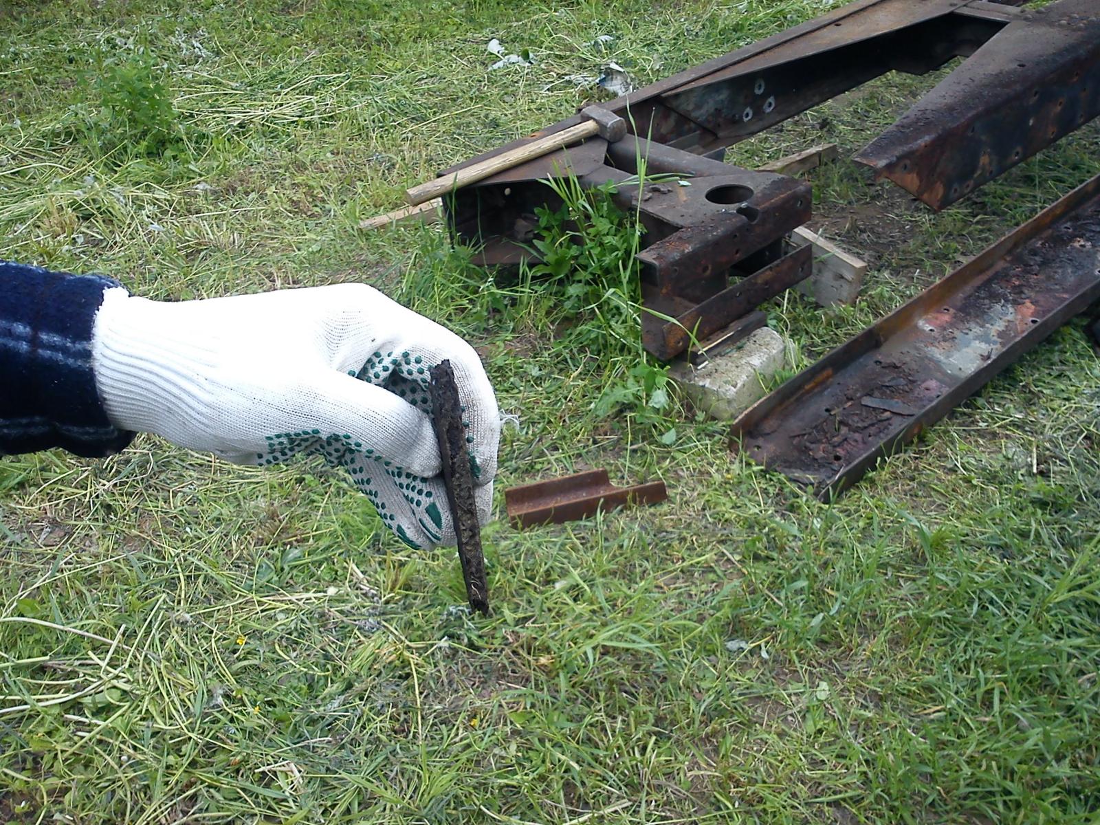

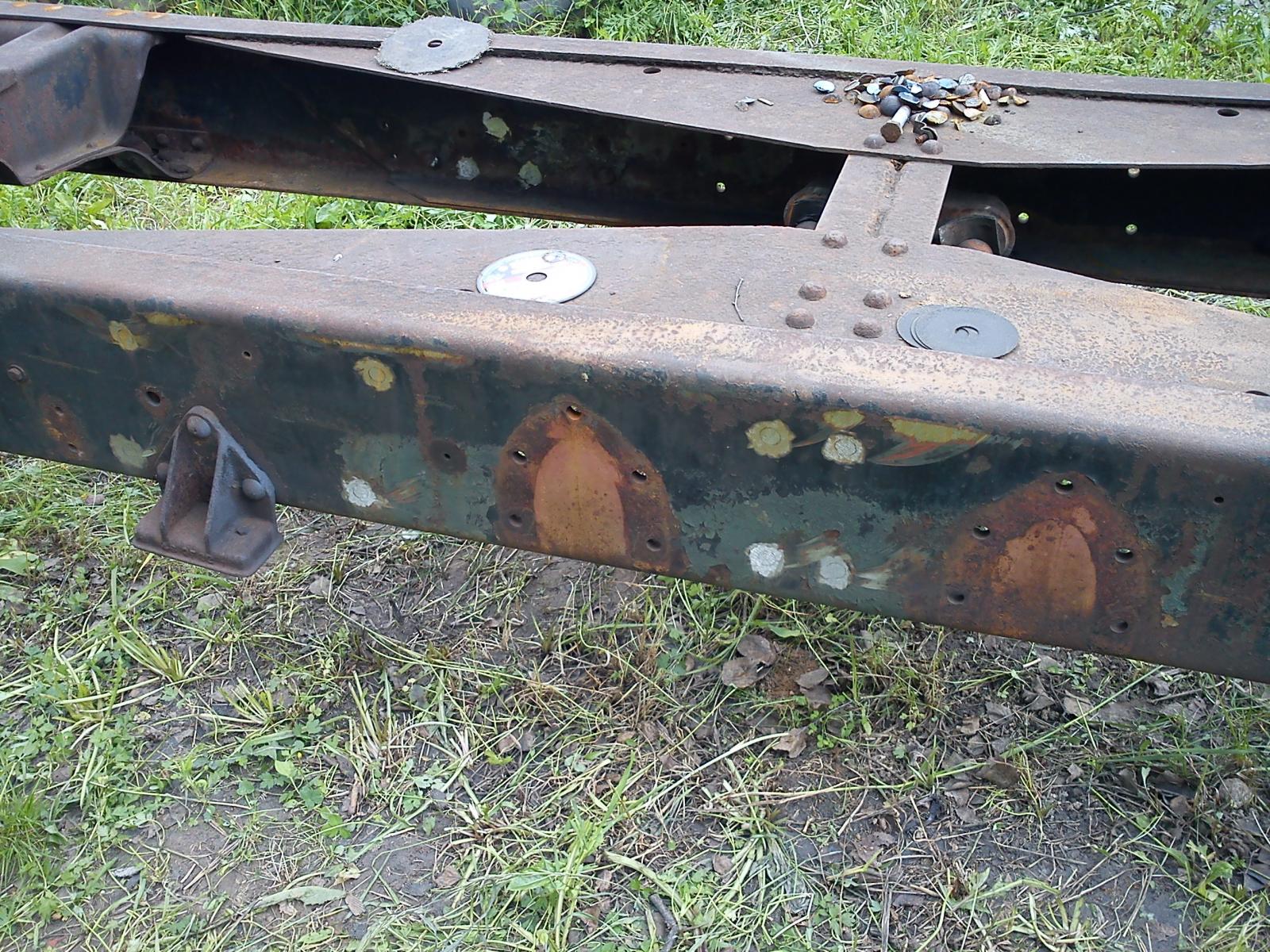

I did two frames apart, clean them up, sand blasted and pressed in all new rivets.
So, step-by-step.
I was afraid to start this work because of need to assemble all pieces back. I needed to re-rivet the frame with no experience of how to do it.

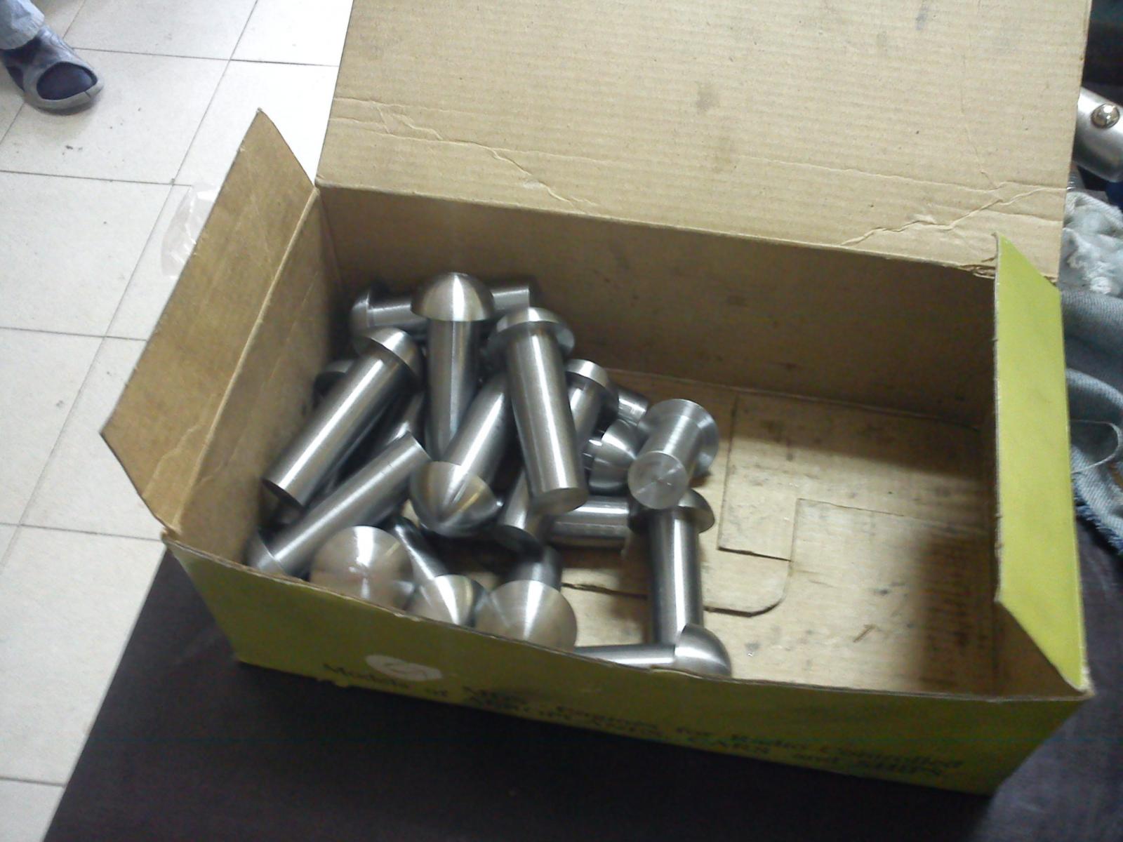

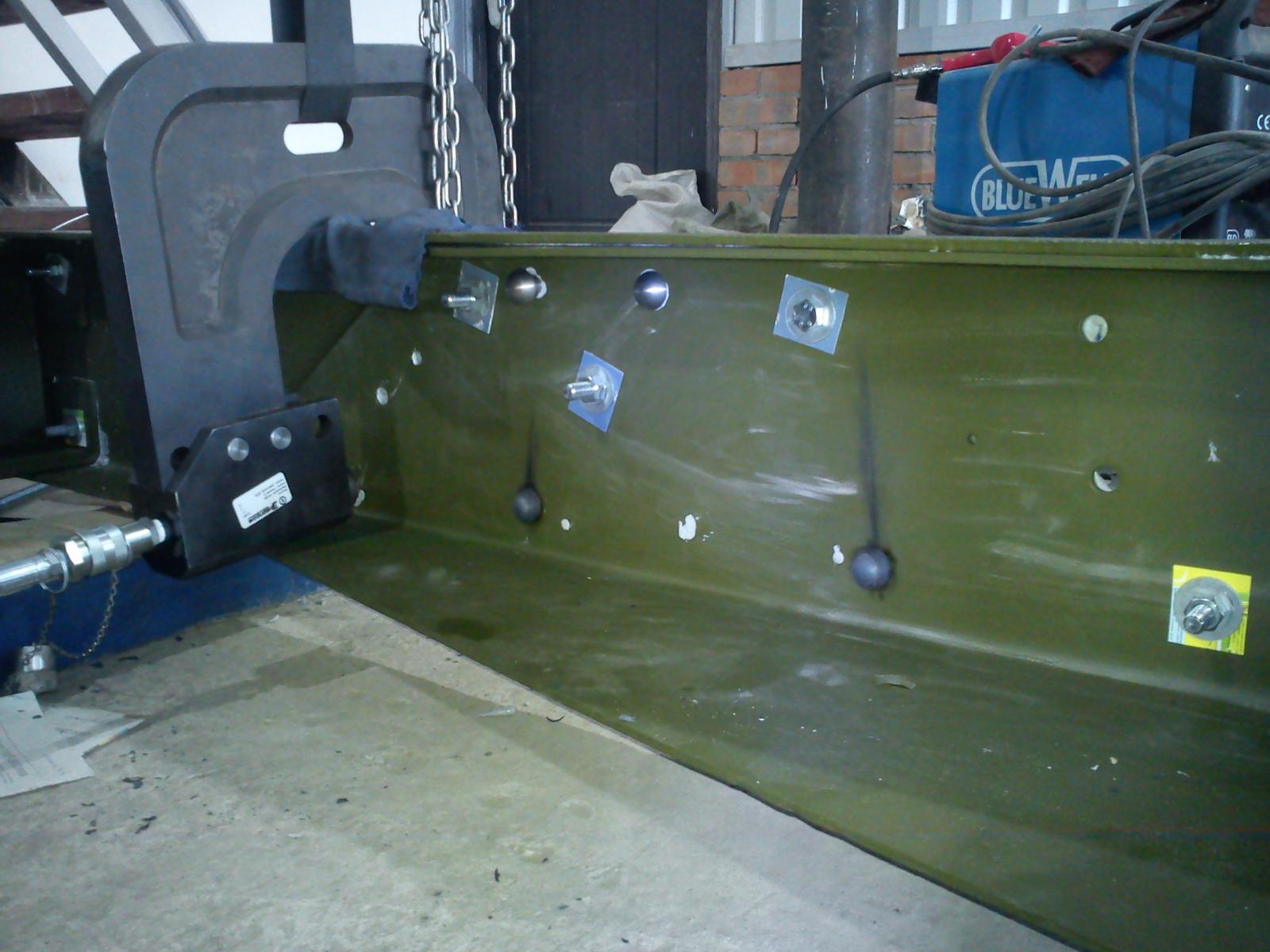

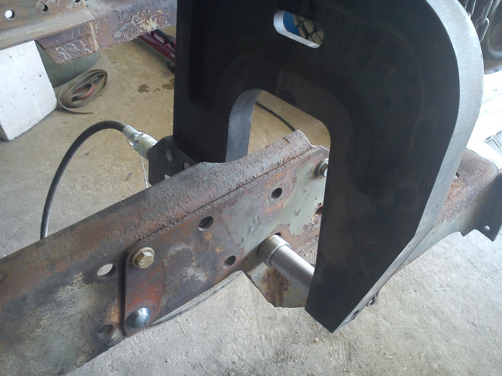

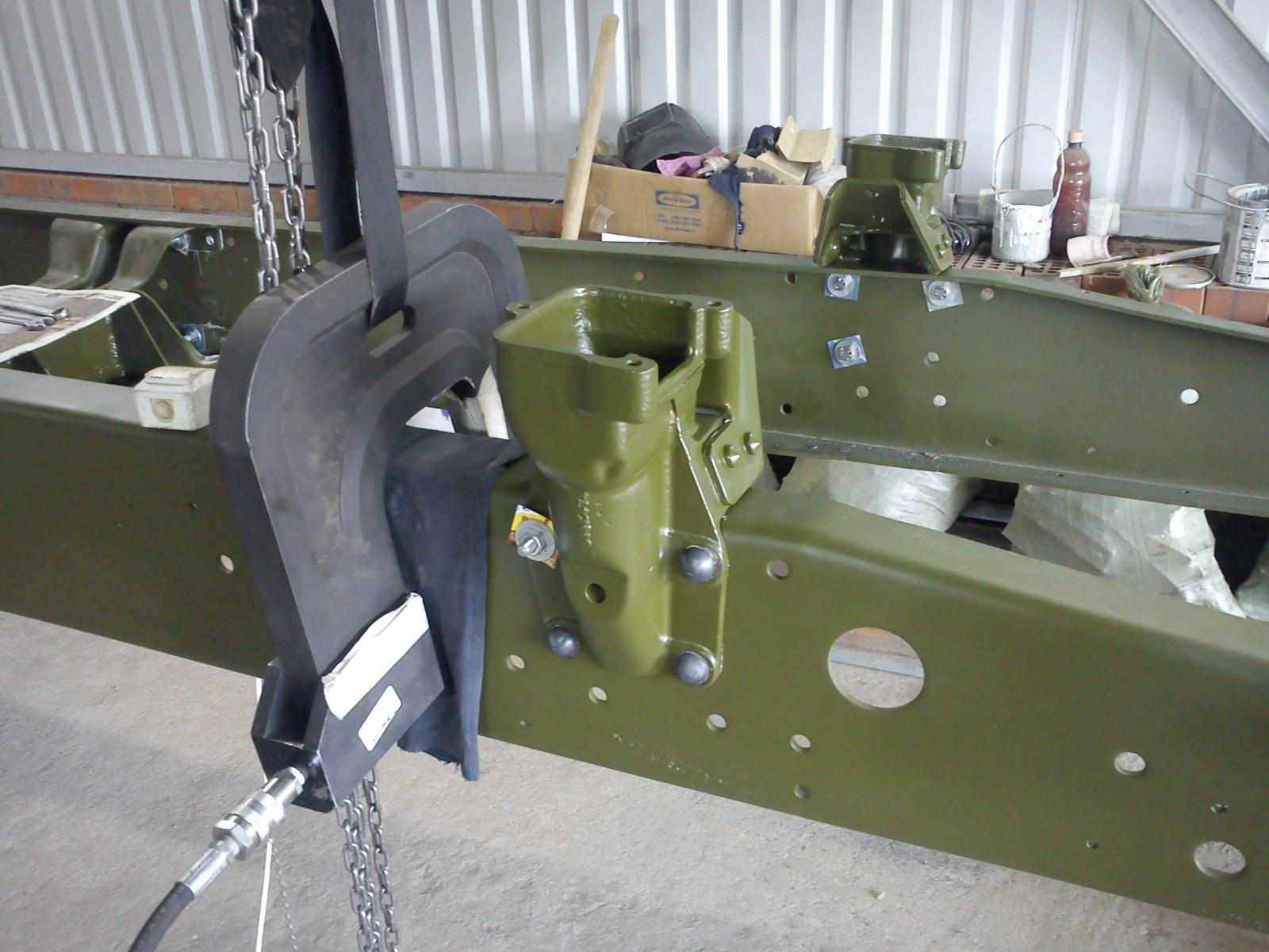

Discussing with most friends gave me a fact that nobody have it done before. I googled "rivet works" (in Russian) and found out that I need U-press and rivets of soft steel to heat them up to red light. Started to look for the U-press, found a firm, ordered, waited for 2 monthes and recieved.

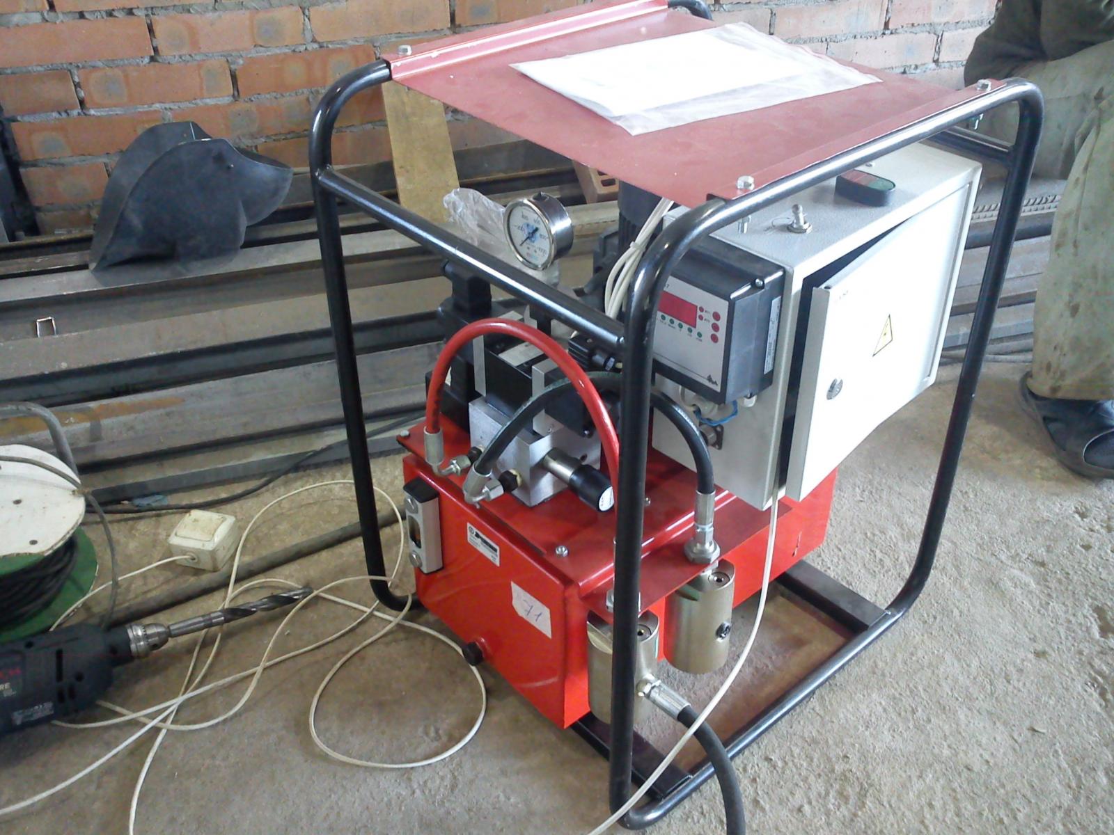

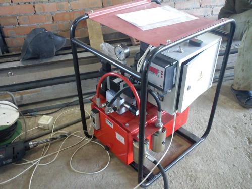

Test rivets got me the mind I need fluid supply power station instead of the hand pump the firm sold me with the press. I asked and they gave it to me for a lease. Had to take it 6 times for a week during the work.

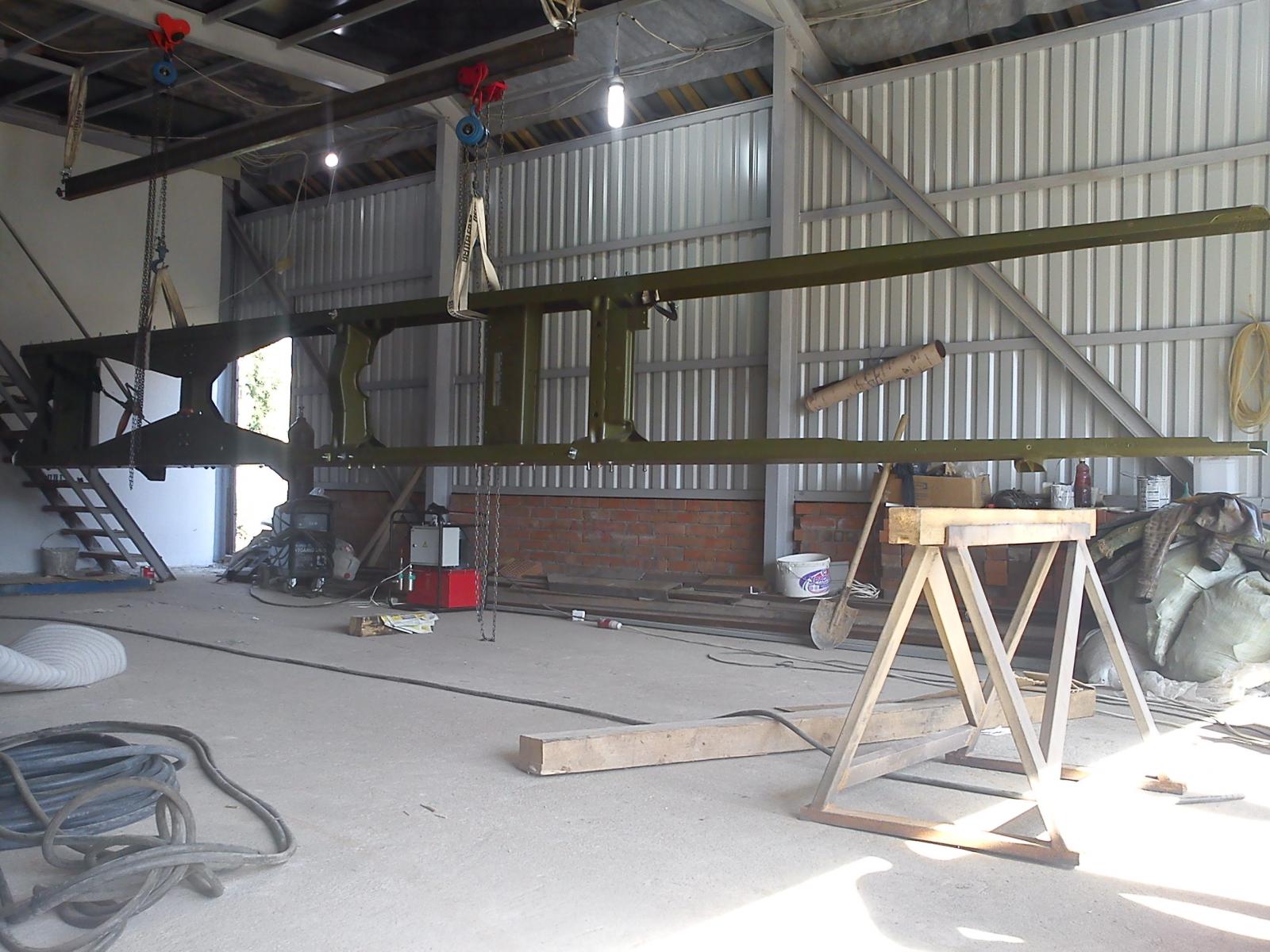

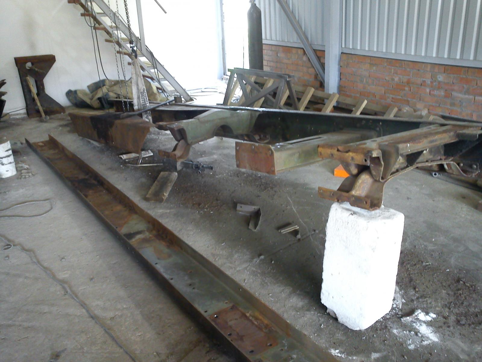

There were 2 frames I wanted to make one good from.

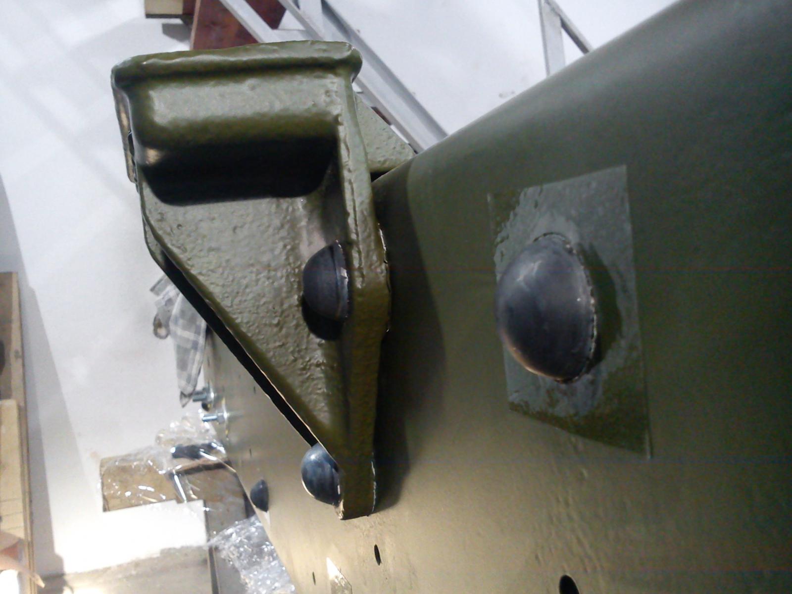

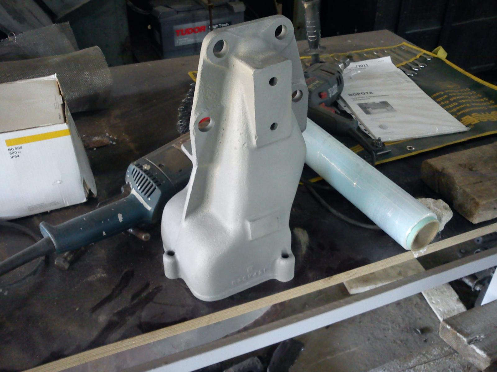

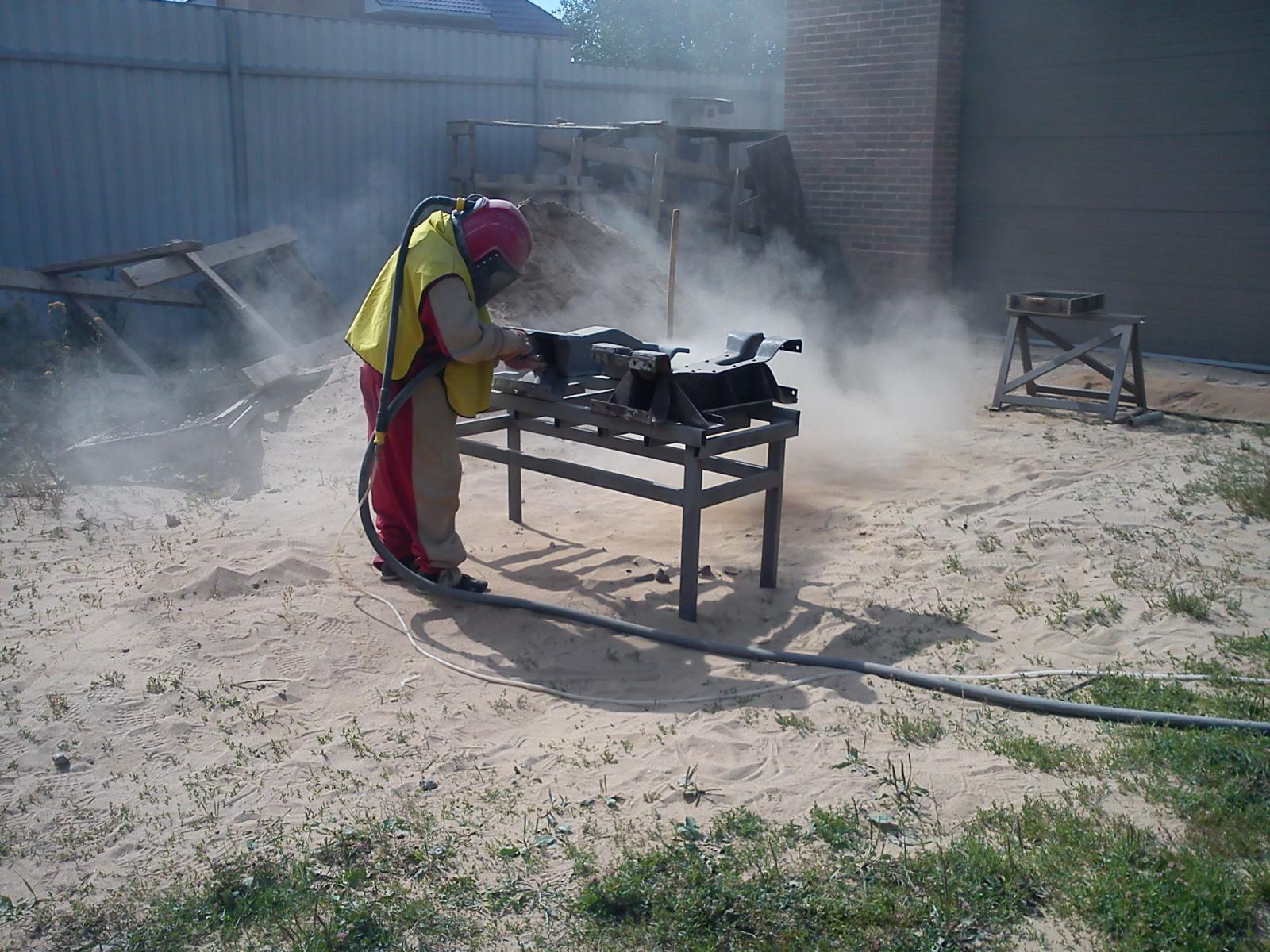

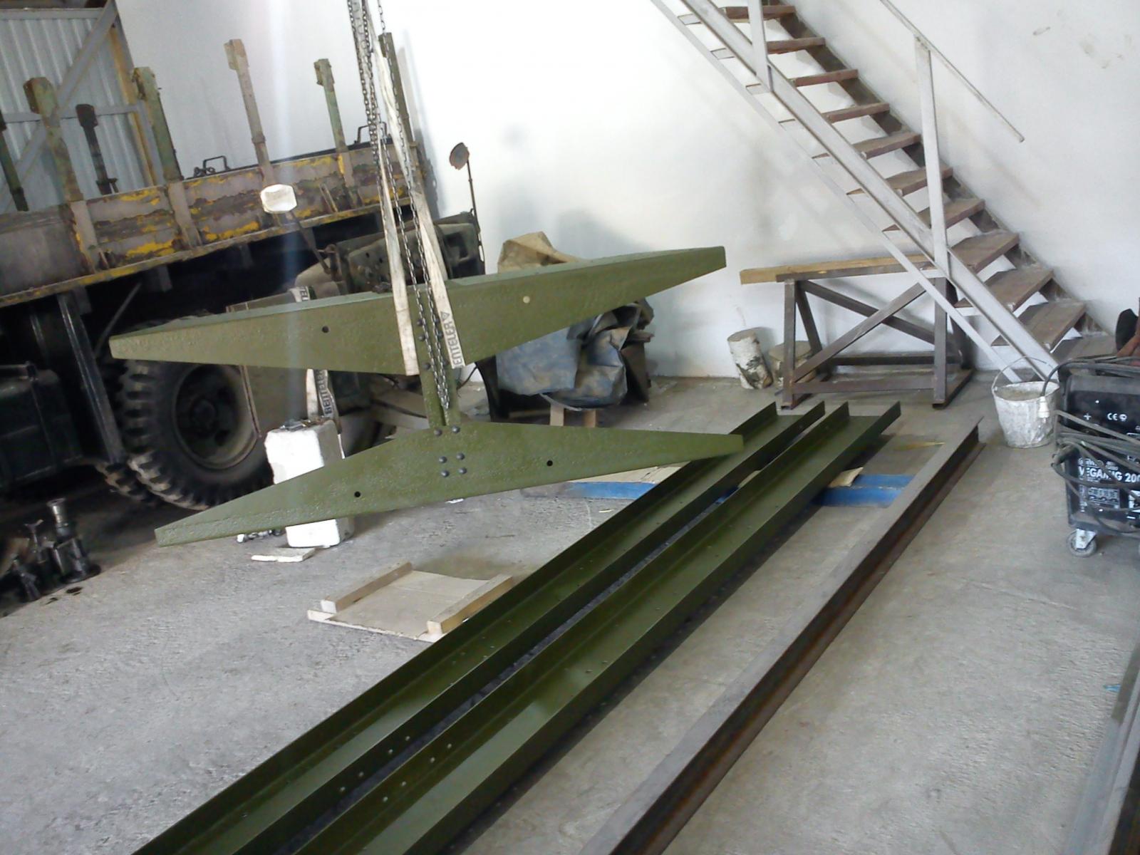

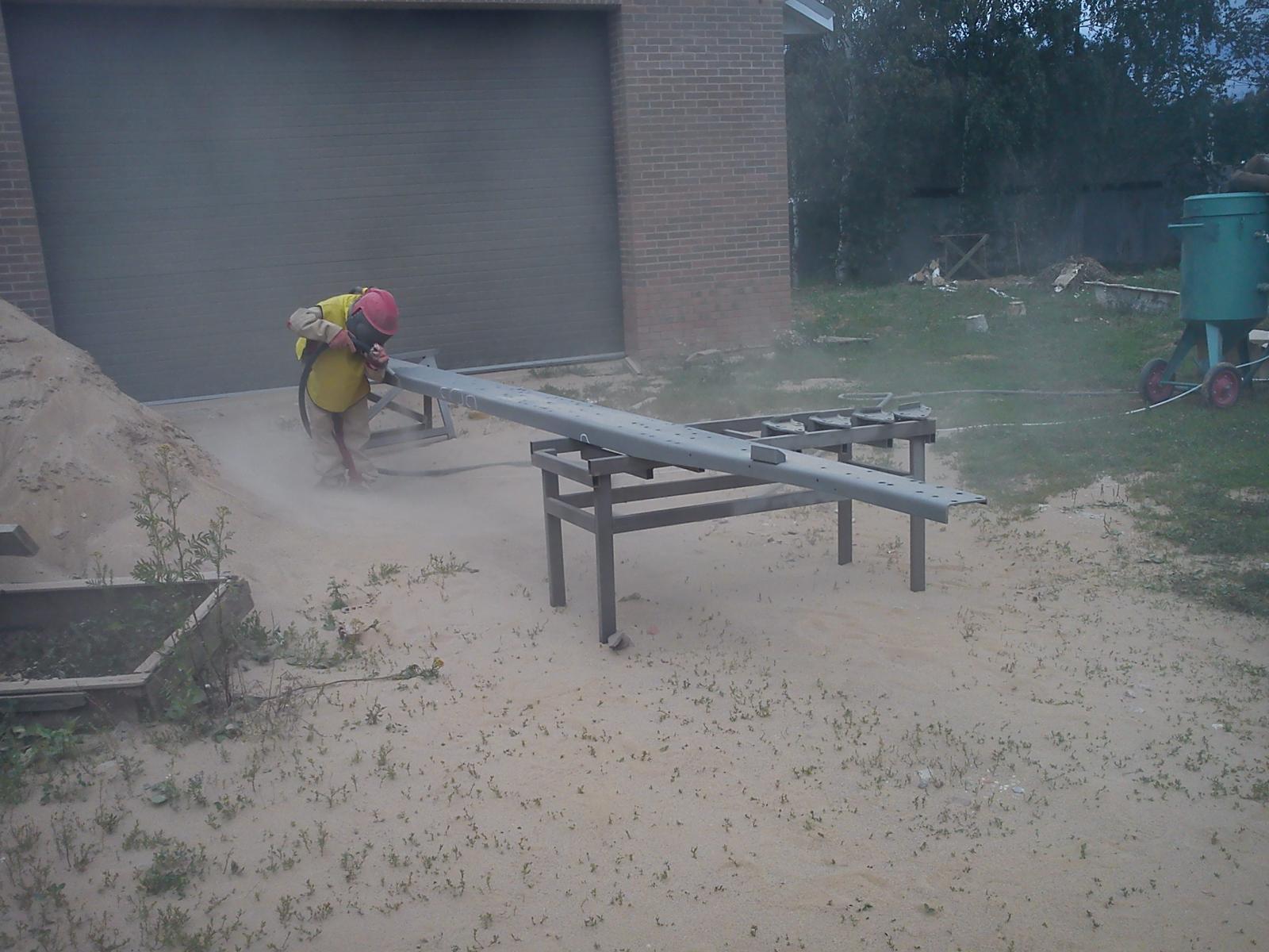

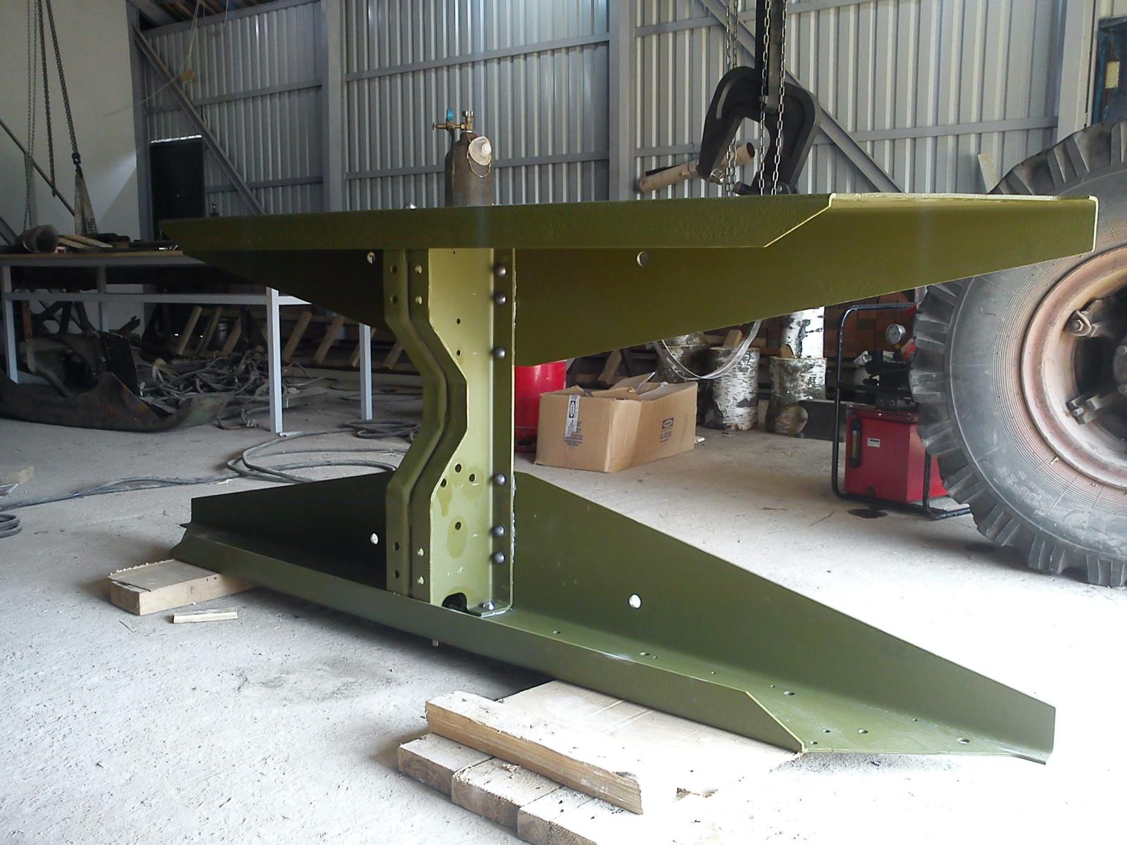

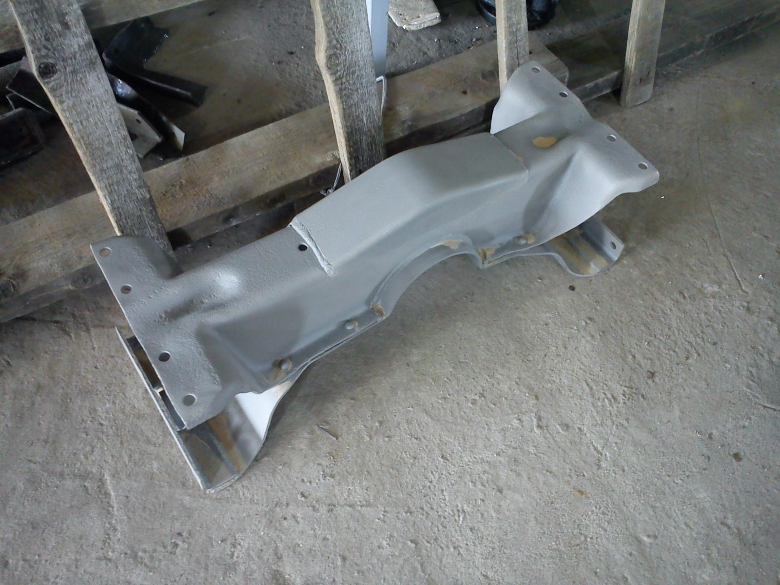

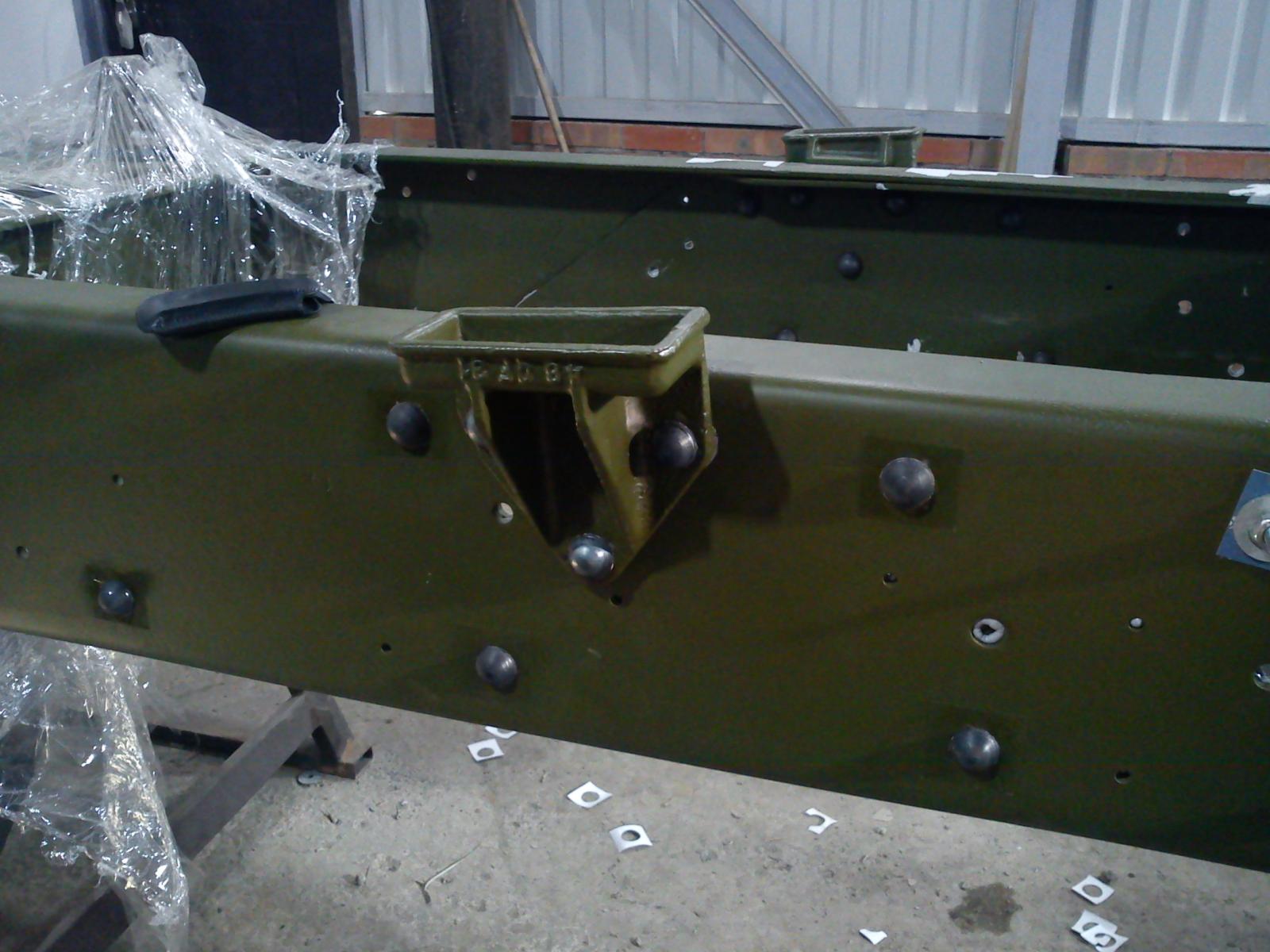

As I told I was afraid to part everything out without shure I can get it back. So I started on the first one in early June, after recieving the U-press. I took out a "butterfly" (bogie) crossmember, blasted it sand, painted at friend's shop and started to press rivets in.

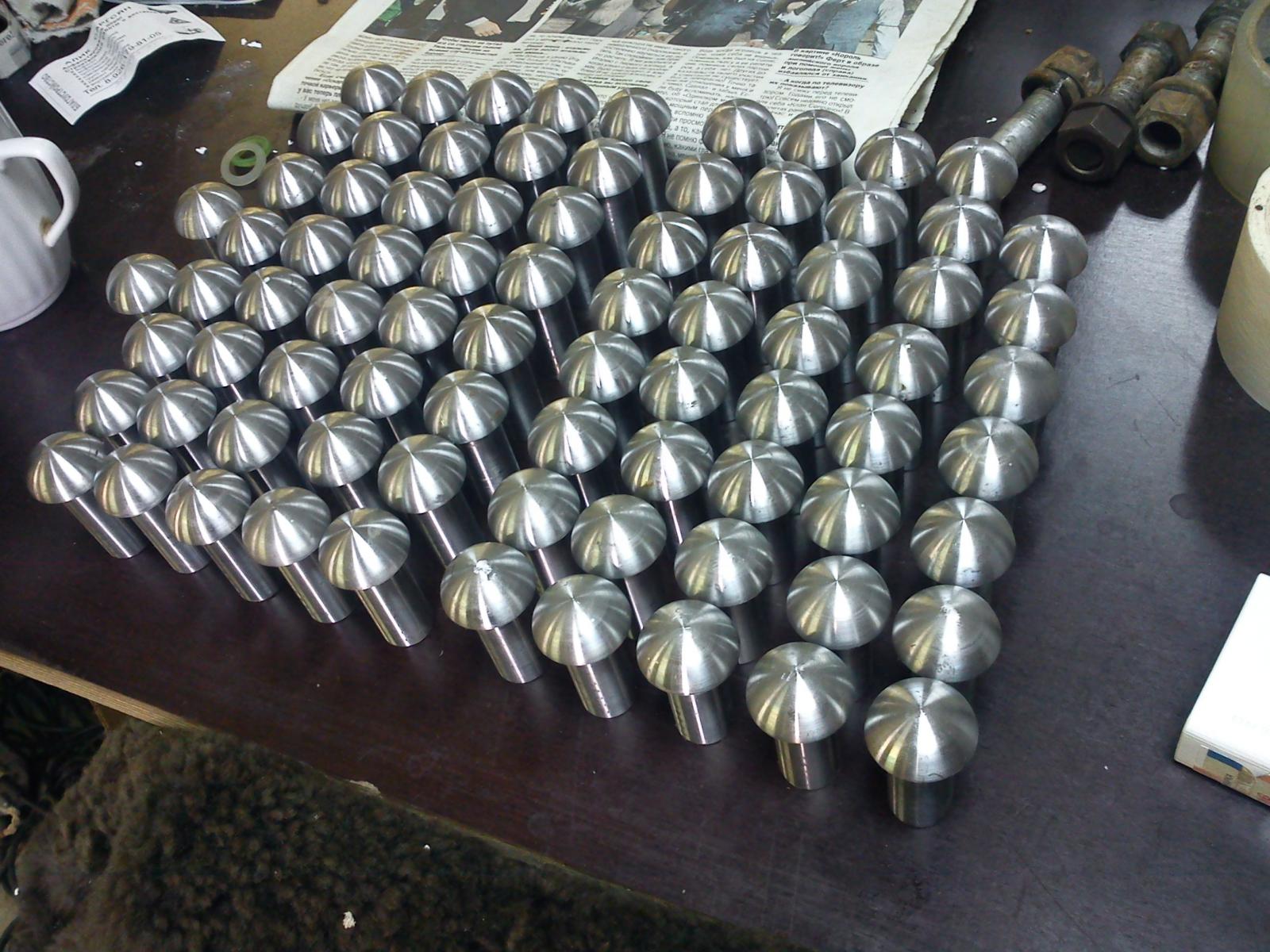

Forgot to add, I bought 12 meters of 40 mm OD soft steel wire and ordered nearly 150 rivets of different lenghtes to fabricate of it.

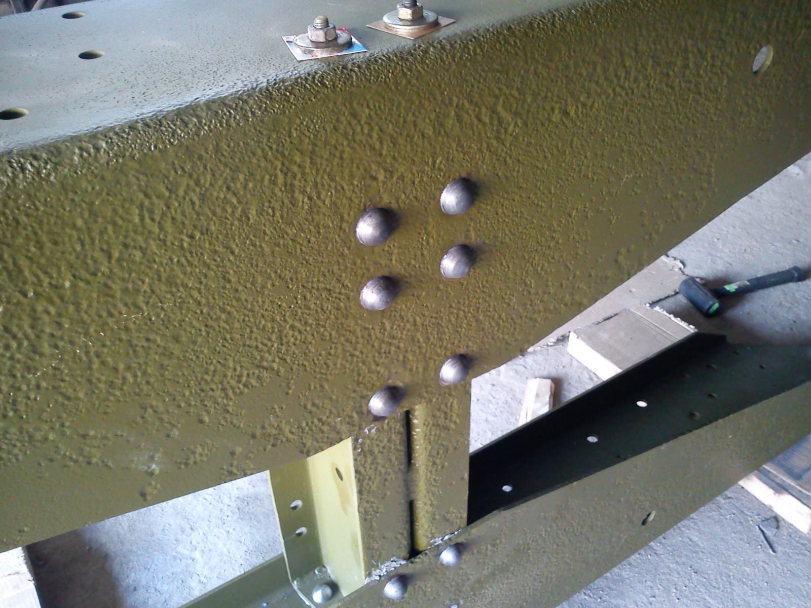

Original plan was to clean up metal parts, paint and rivet them. Due to a heat influence I waited a paint burned off around rivet's heads so planned to re-blast assemblies and repaint. To my surprize and great pleasure paint got Ok after riveting, it made my way easier, without overpainting. Rivet's heads only.

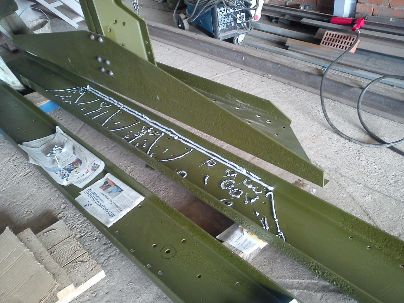

I didn't end up with posting yet, have to part the tread out.

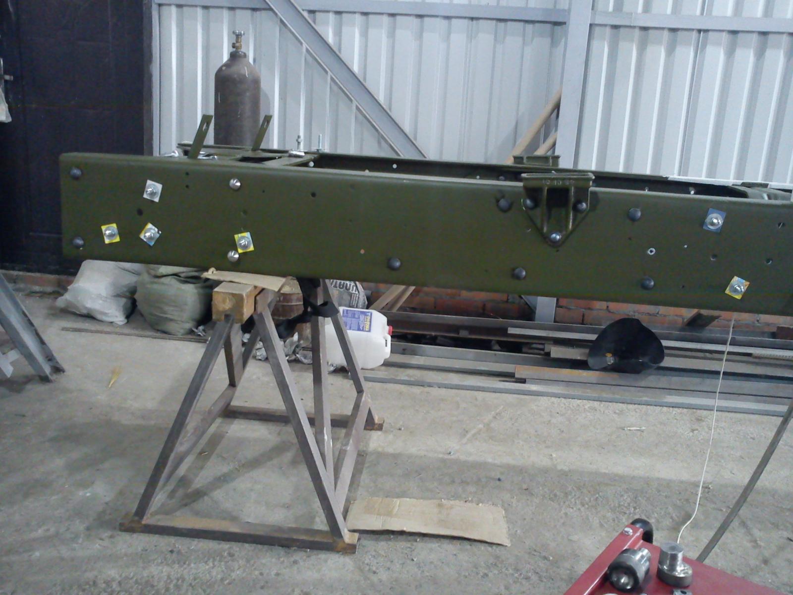

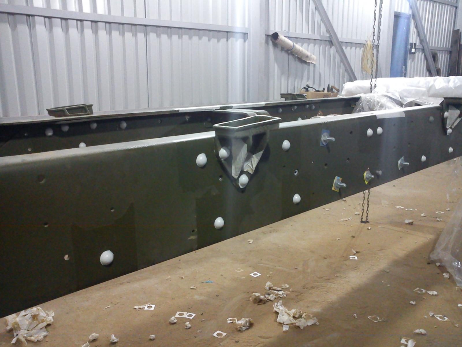

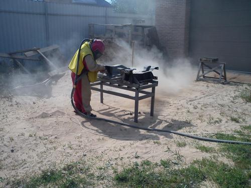

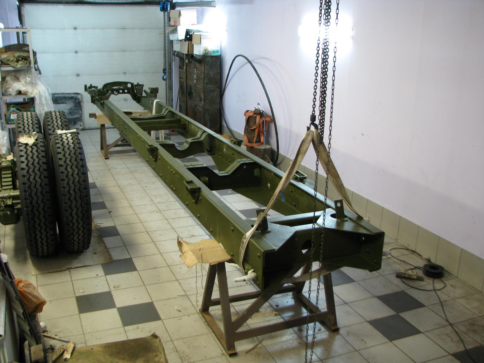

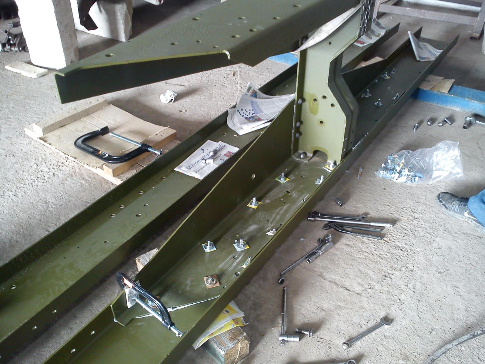

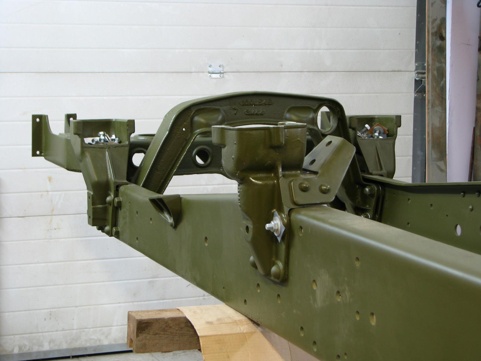

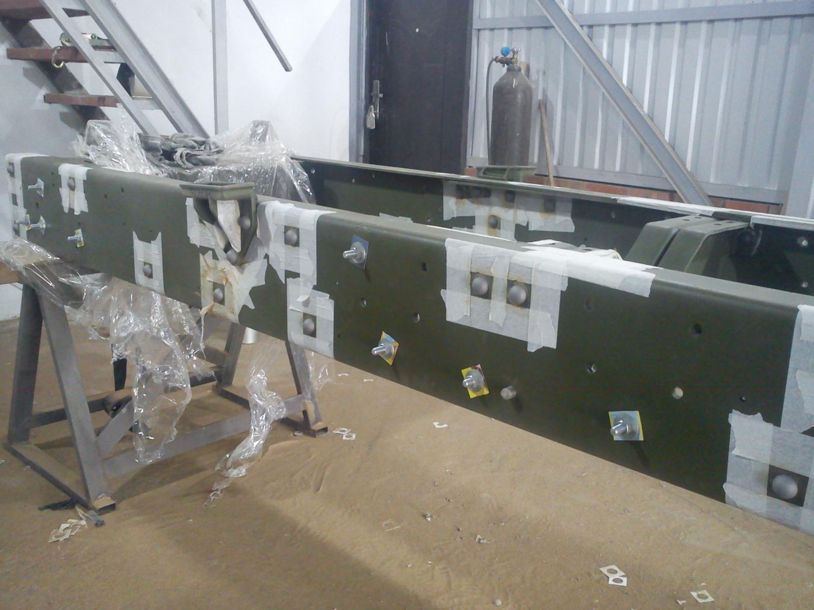

Too unpleasurant step was sand blasting of ready rivet's heads. Had to mask them around with plastic film and paper band.
Primered them and coated acrilic olive drab as everything else.

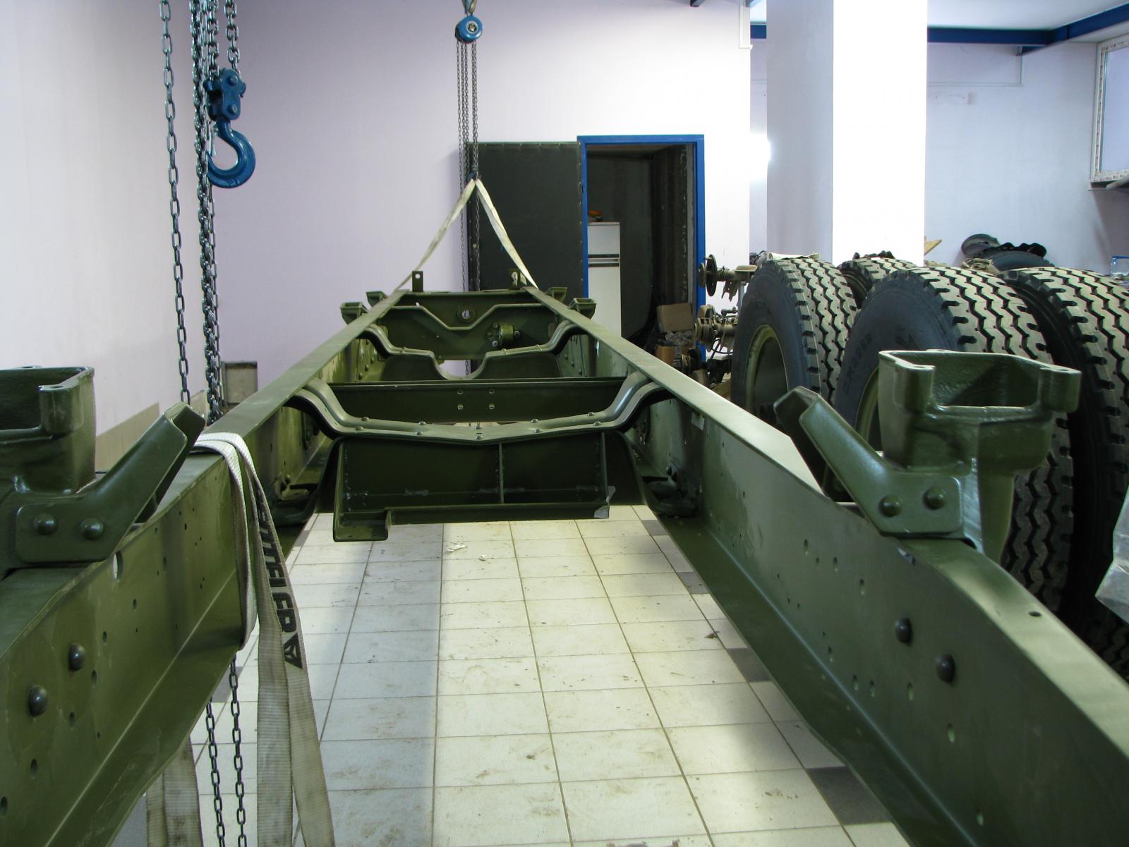

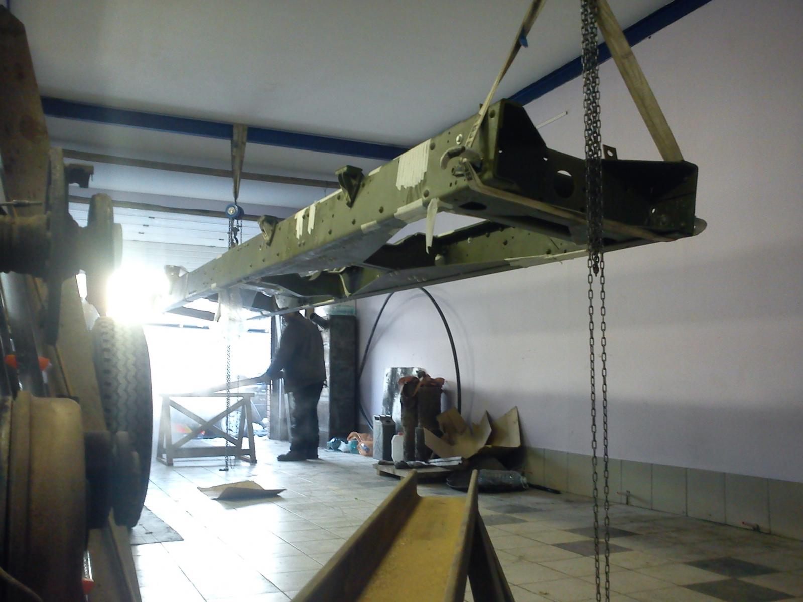

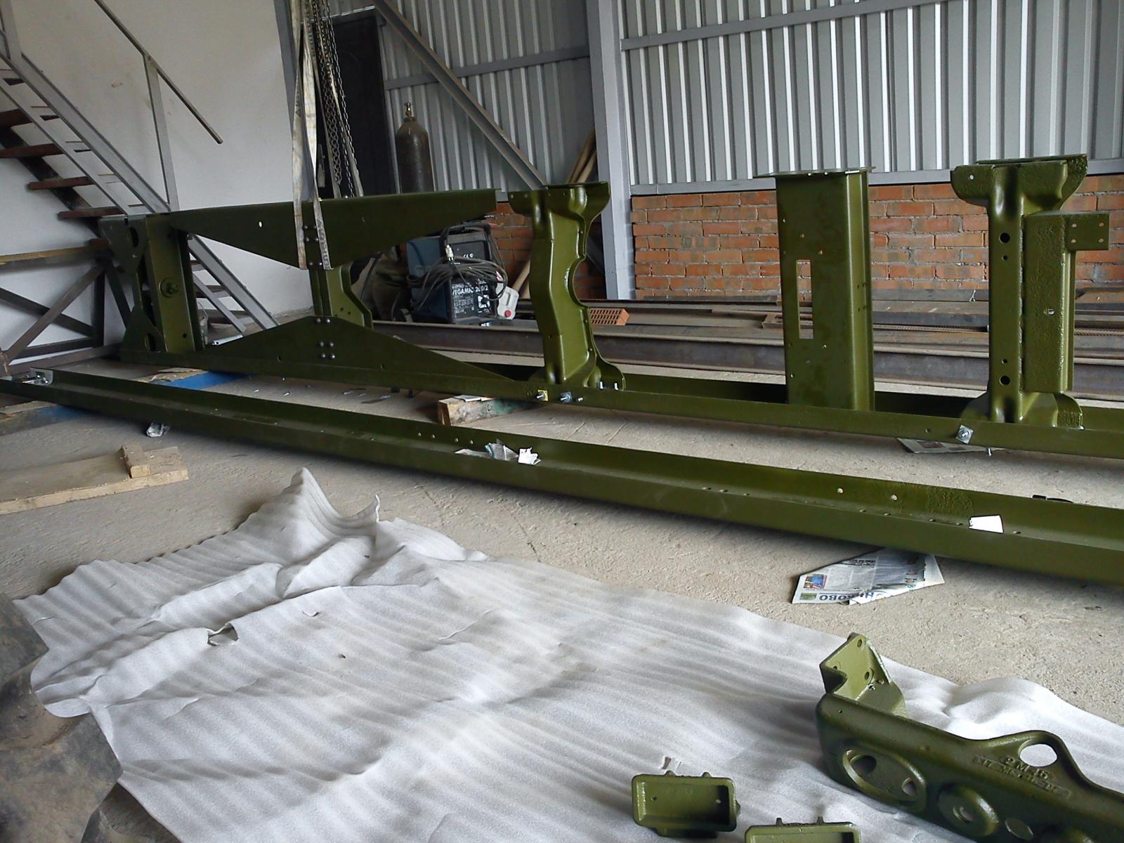

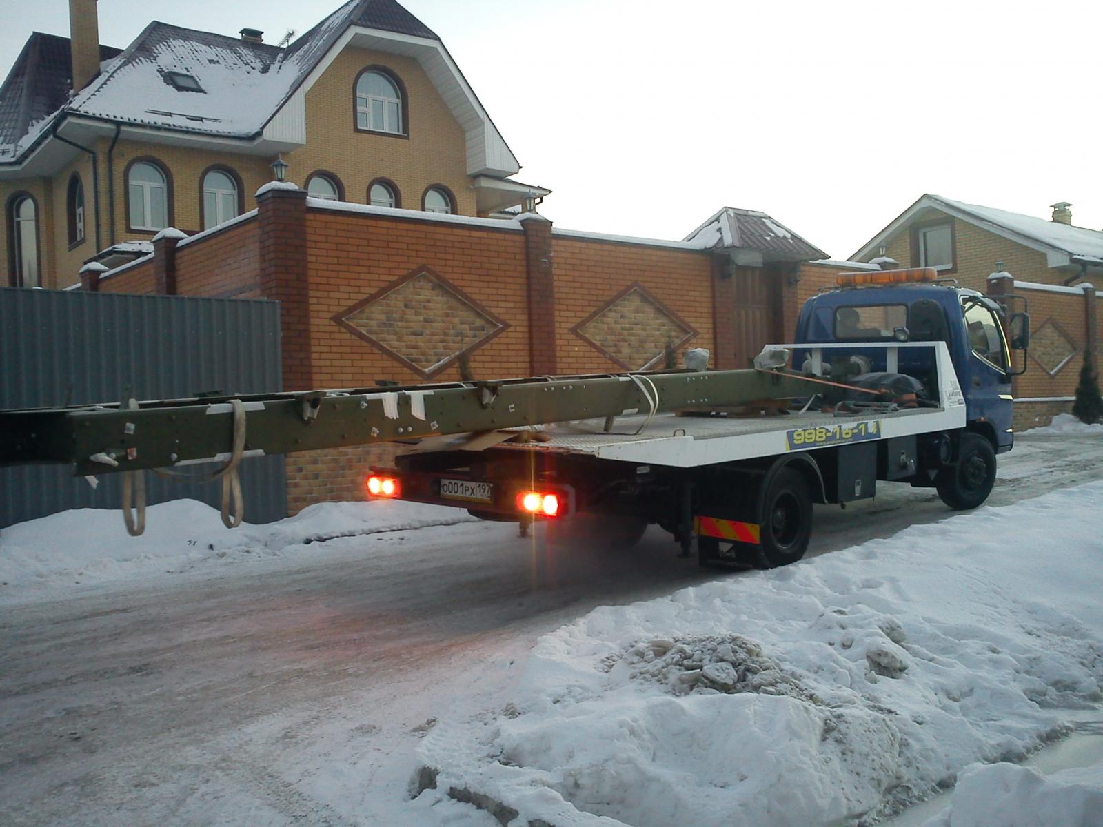

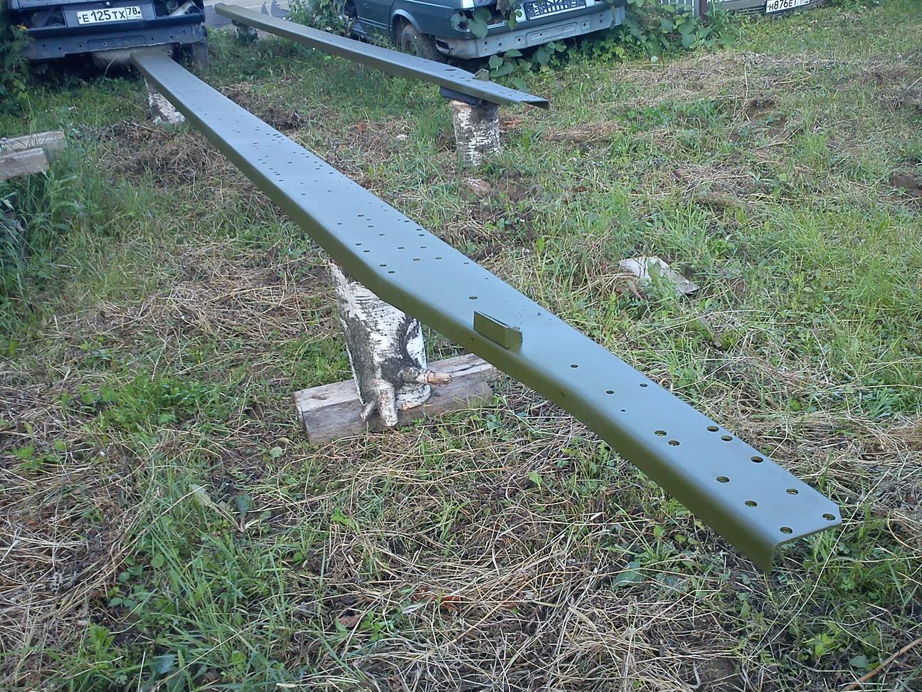

Needed to remove whole the frame from the cold shed into the garage because the cold time came.
Now it looks like on the last pictures, ready to put it on the bogie :)

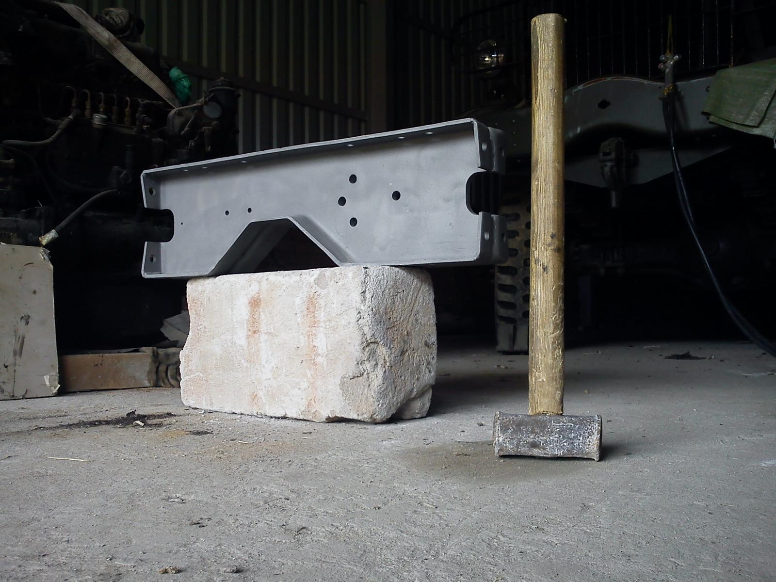

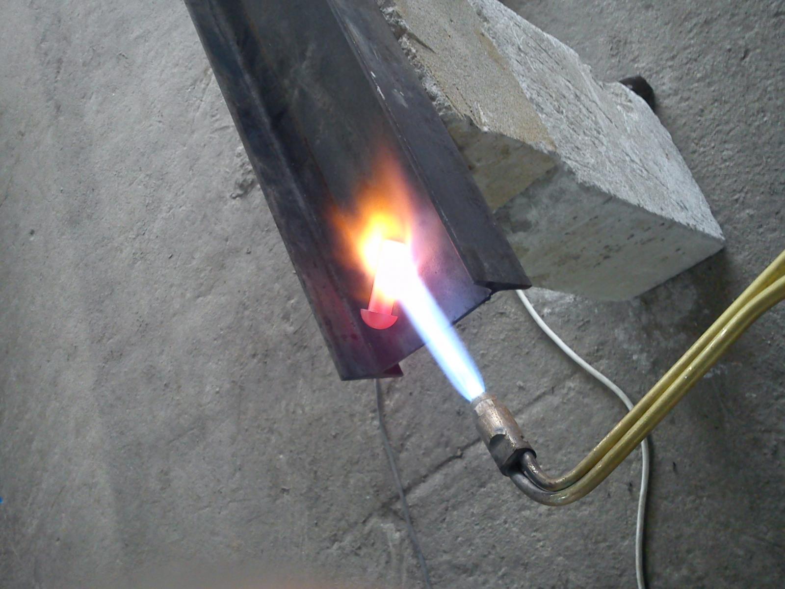

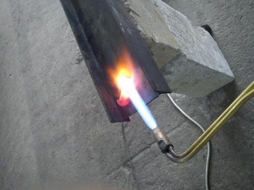

As about rivets, first one I tried I bet with a big Hammer.
Not the way to go. Bad shape and didn't pressed well.
Hand pump got formed head but after 4 reheatings up to amber in the position.
Also not the way because everything burns off.
I planned to keep paint at least on inner surfaces.
For those who like power equipement I would say that the press working pressure is 700 bars with force of 14 metric tons.
Power pump of 3 phase 2kW motor supplied oil under that pressure, a rivet is pressed in and formed it's head in 5 seconds.
And it's a bit much time, better to make it in 3 seconds because it started being cold.
So no chances with averege hammer, bridge builders used pneumatic ones.
