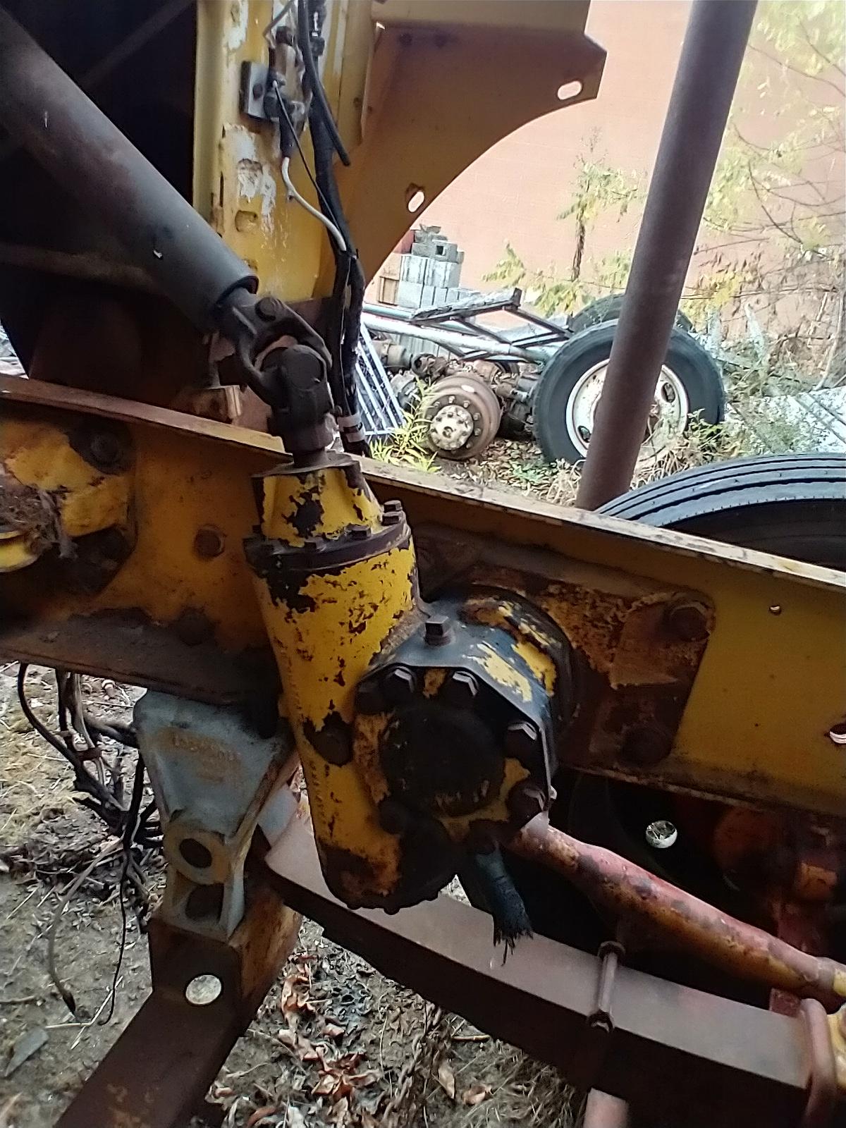

2006 granite rear end out of alignment.
D-Day replied to No1eaglefan's topic in Driveline and Suspension
It looks like the Spindle is bent where it is attached to the axle housing I have seen them bent before the older ductile iron housings had a replaceable spindle press fit with a retaining bolt on the back of the housing but all of the others are welded it can be repaired or replace the housing. -
