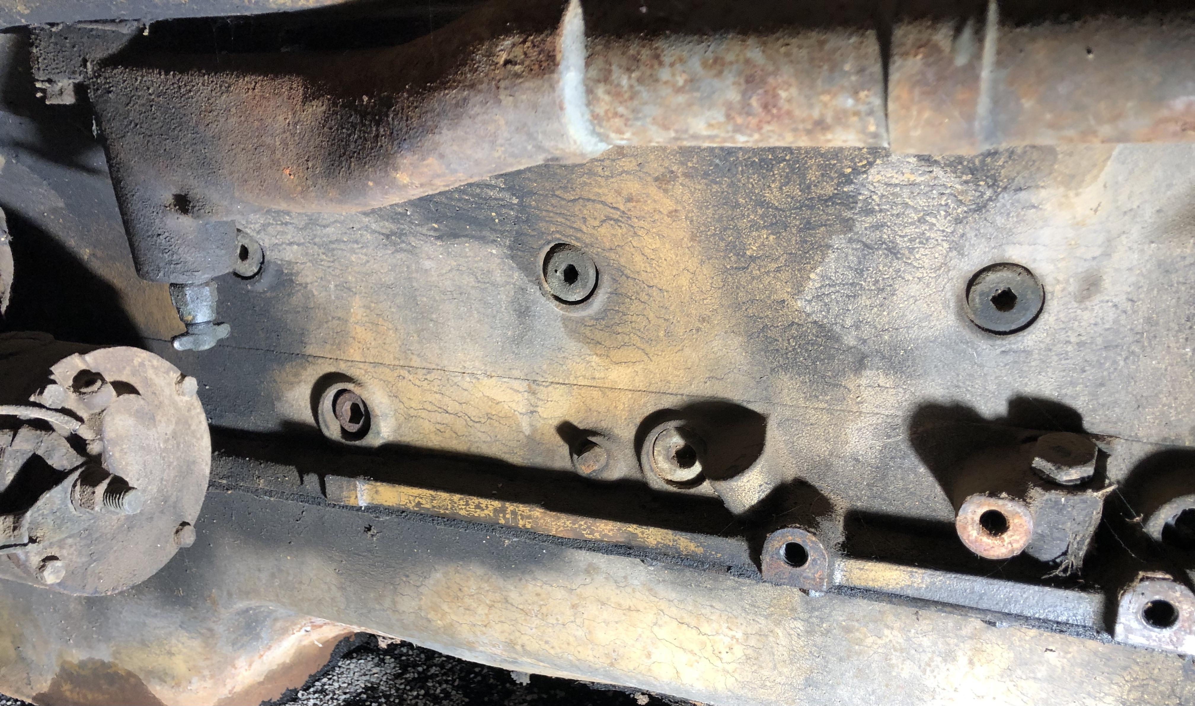

  4. Difficult to see for sure but I would say spicer 8341 not many other choices and very popular in the west coast trucks

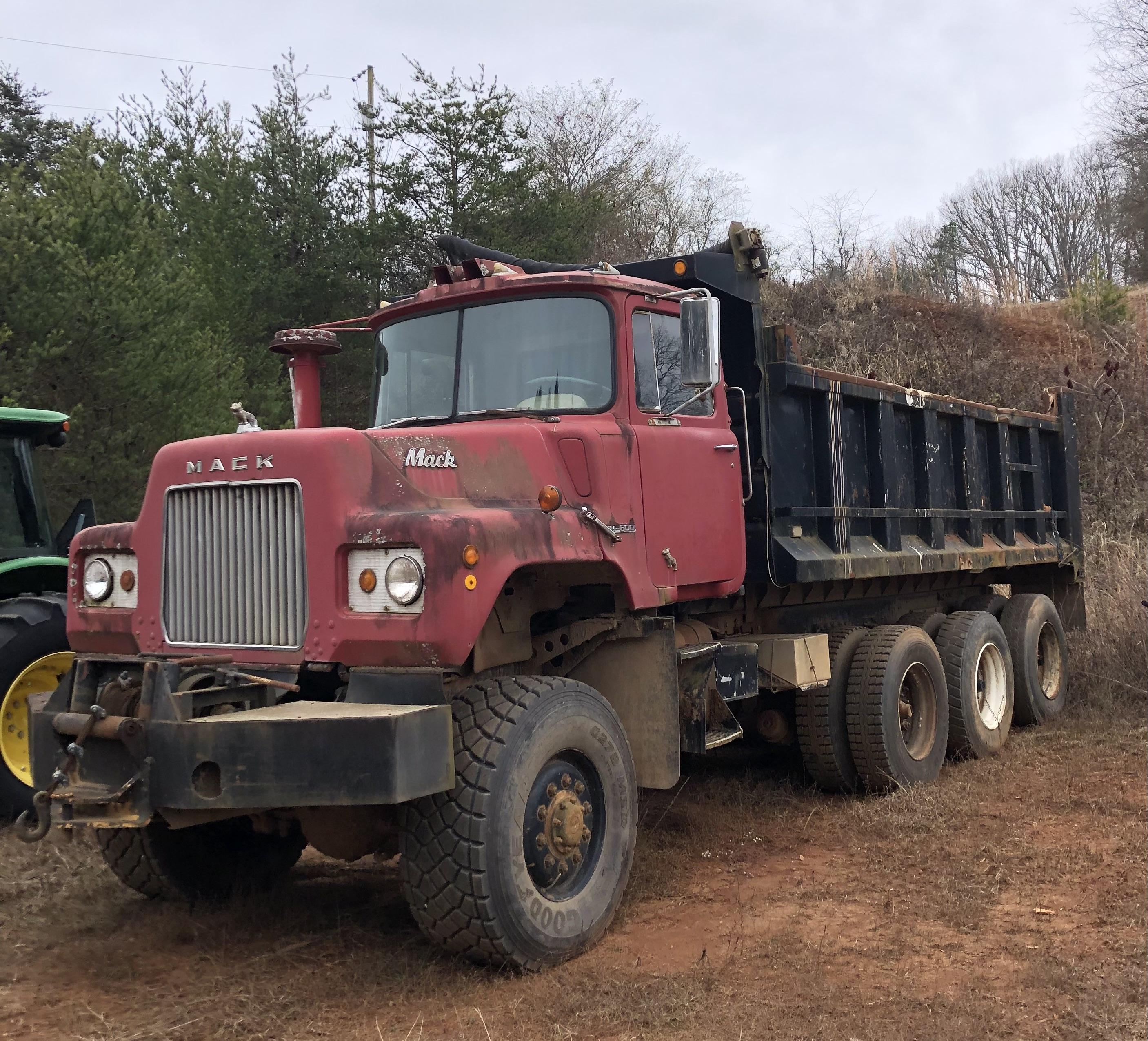

  7. Nice truck ,Your spoke hubs are a Mack thing not only stronger than budd rims but they also let more air flow around the brake drum which is very important, to change them out you would halve to locate some hubs that fit your spindle look for the axle number and check bearing numbers to make sure the hubs will fit there are a lot of variations out there changing out the front axle is also difficult with spring center spacing and steering knuckle offset for the drag link to the pittman arm
