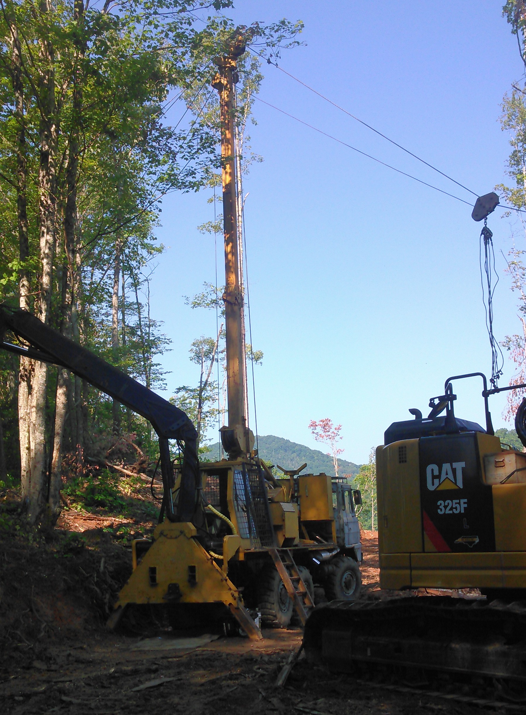

  21. Dang you all have wheels on the back I can’t use reverse unless I drop the load
