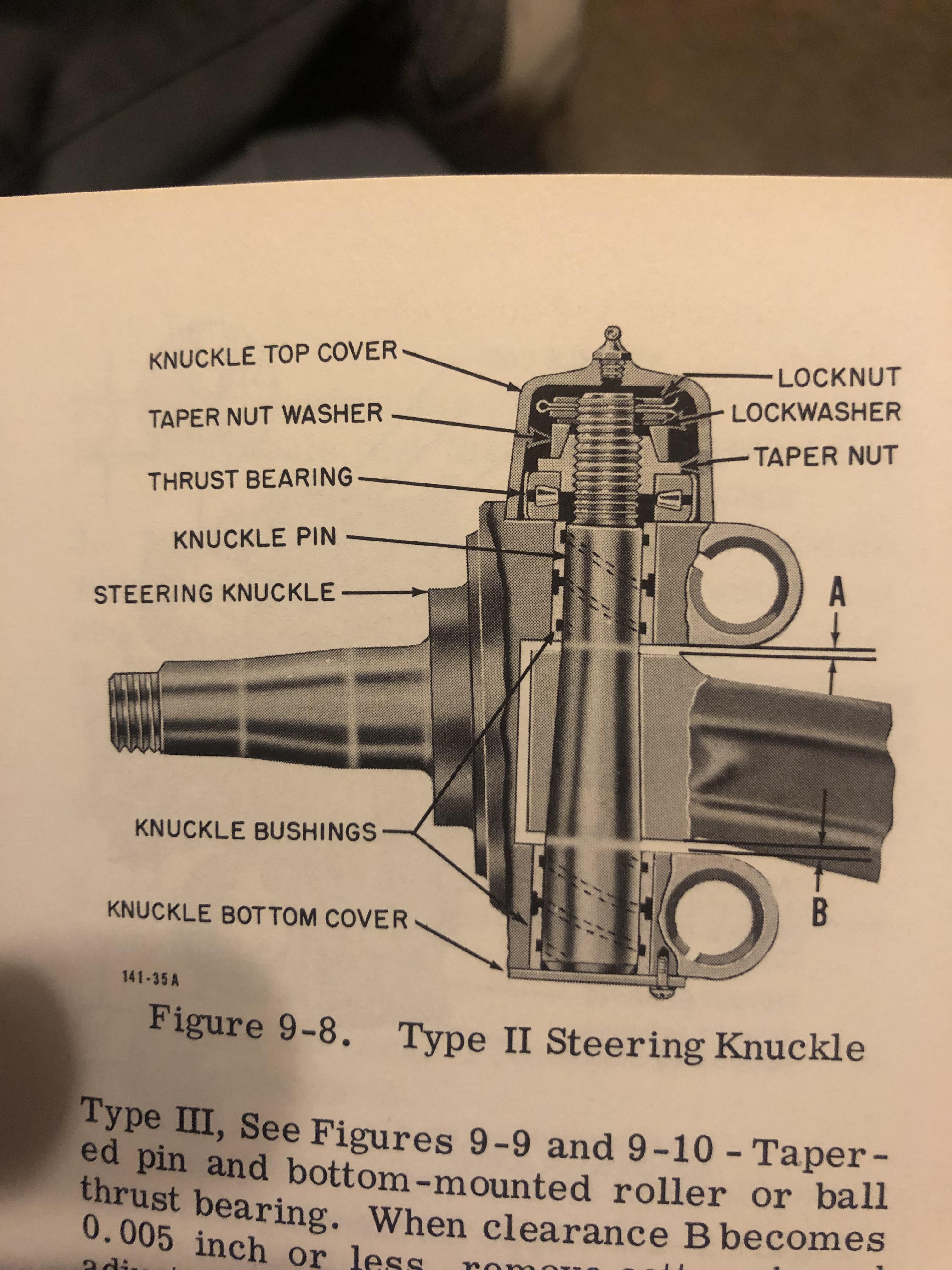

Here is a great picture of how the components stack up.  I hope this will help explain how the tapered pins work.  Like the man said above, the tapered part seats in the axle beam.  The bearings/bushings go into the knuckle.  And the thrust bearing is adjusted into place with the big nut on the bottom.

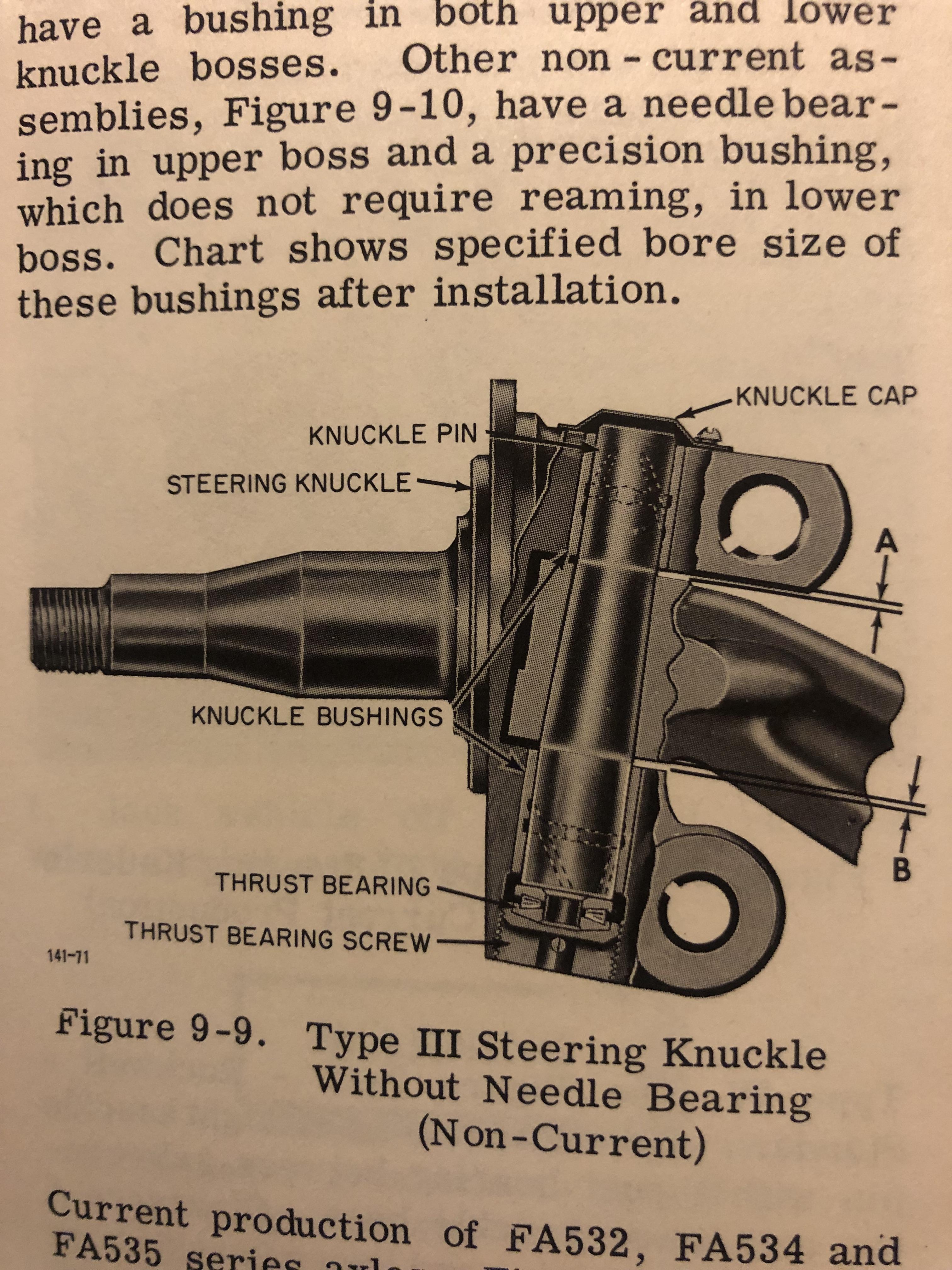

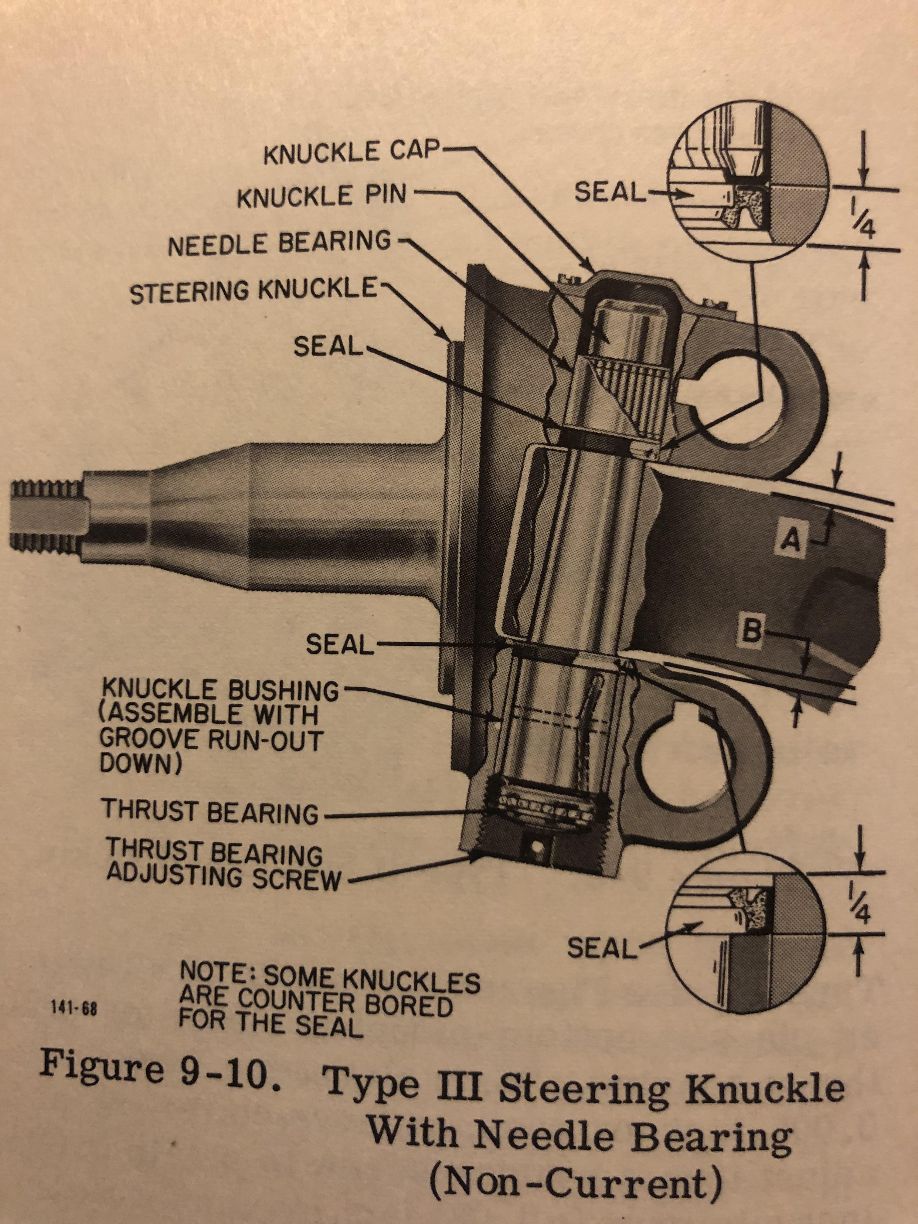

Here are pictures of “Type 3” knuckles, which I THINK is correct for a FA505. One has a needle bearing and the other doesn’t.  I am also attaching a picture of a “Type 2”, which uses a different thrust bearing setup.

Great pics,DCW,thankyou.I believe my truck has the Type 3,Figure9-9 setup.So the taper of the pin in the axle bears the weight,and the adjusting nut on the bottom moves the knuckle up or down slightly to maintain clearance w/ the axle?
Exactly.

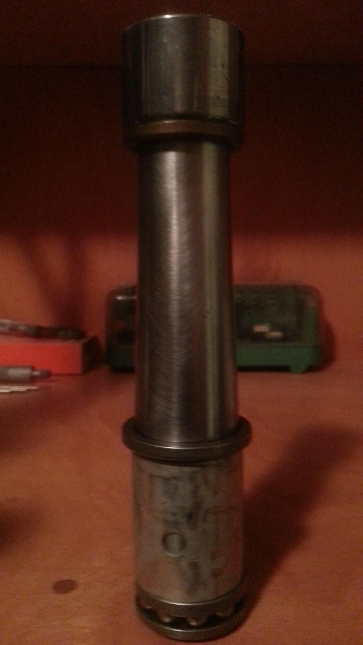

I didn`t gat any grease seals in the kit.I don`t see any in the Figure 9-9 pic that DCW posted.Can I re-use the old ones if I have them? If I spread the bushing seams by hand,they fit over the pins,but I`d think they would need reaming when installed in the knuckle,since they`re a no go over the pins when the seam is tight.

looking at the bushing pictures  even having 2 grease holes ;are the holes off center top to bottom ??  install upside down will the holes be off from lining up to zerk hole ?  possibly just the photo makes off set appearance. been a while for me doing bushings.
