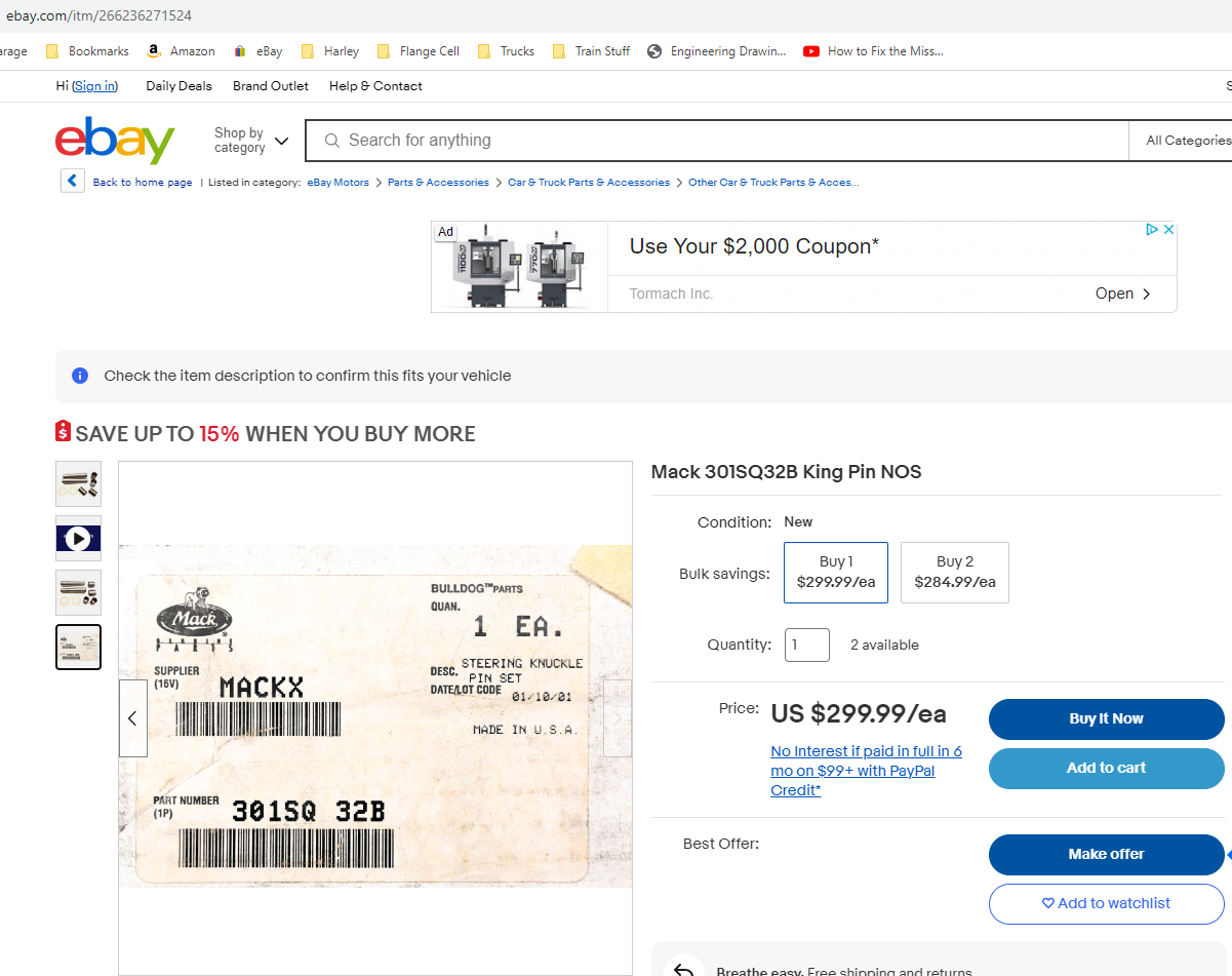

There have been several discussions on here in the past related to the early B model kingpin sets.  Maybe some of those threads will yield a good part number.  Or, the eBay link I posted?

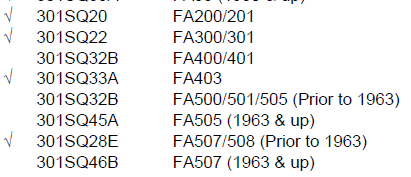

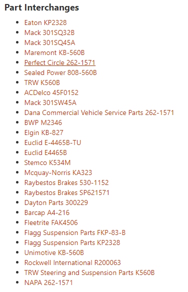

I've been looking at several cross references.  But, some of them circle back around to a different Mack part number when you cross reference them "the other direction" or through multiple suppliers.  I always feel better when that trip leads back to the same Mack number.  Wow.  I'm not sure that even made sense to me!
Personally, if the axle number and year matches up, I'd jump all over this one.  NOS Mack parts.  Or, maybe somebody could buy this one to use as a pattern for the new ones.  If I had them, I could probably do drawings for them.  And loo!  There are 2 sets available!  Maybe I should buy them as an investment!
I keep running into part numbers that are cross references for the 301SQ32B which also cross back over to the 301SQ45A.
Any chance the 45A would fit the 32B applications?  I kinda have my doubts.  But...
Anyway, here's something to think on.

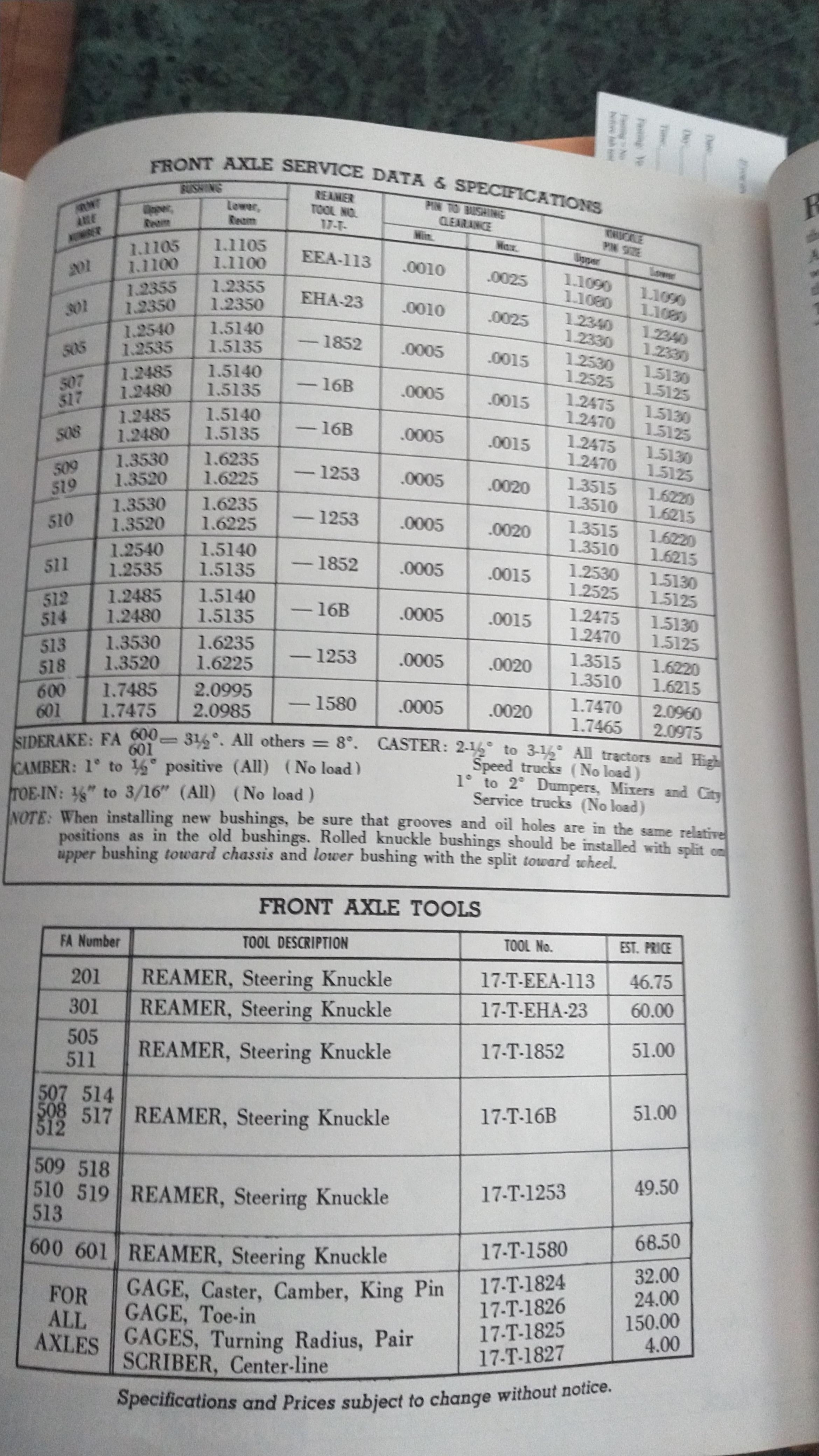

I am leaning towards worn king pin bushings, he said both sides are sloppy.  I hope these pics from a B-61 book I have helps, along with the great info DCW has posted.. Jojo
Looking at your post reminds me of when I did mine and had to set that nut under the thrust bearing.  What a killer setup these things had.
I hope his "early" axle has the same setup with the tapered pins and the thrust bearing.
Skydawg,,  Take a close look at the pictures I posted. the second one has specs that may be useful to the machine shop, when it comes to fitting the pins into the new bushings.  I can e-mail them to you so you can print them.  just post or P.M. your e-mail..  Jojo
