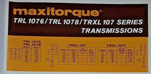

I don't exactly know what boxes y'all are talking about.  Might have been later versions.  But, there was a 5-speed with a single stick (TRL-107 series).  Then, there was a 6-speed "extended range" with 2 sticks (TRXL-107 series).  The "lo" on the compound was supposed to be used only in 1st gear.  That's your extra low gear.

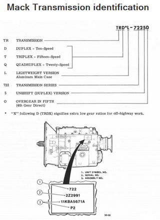

Here is graphic showing some detail on the ones I am talking about.  The TRXL-1070 (or maybe it was a TRDXL-1070) would have been the same as the TRXL-107, but with "direct in 4th", and an overdrive 5th.  The "0" on the end of the number is the "overdrive" designation.
Model numbers were on the left side of the box.  There are several discussions on here that have pictures showing the location.
Somebody on here had the one I am talking about (TRDXL-1070).  Check out this link.
https://www.bigmacktrucks.com/topic/56848-mack-trdxl-1070-questions/
