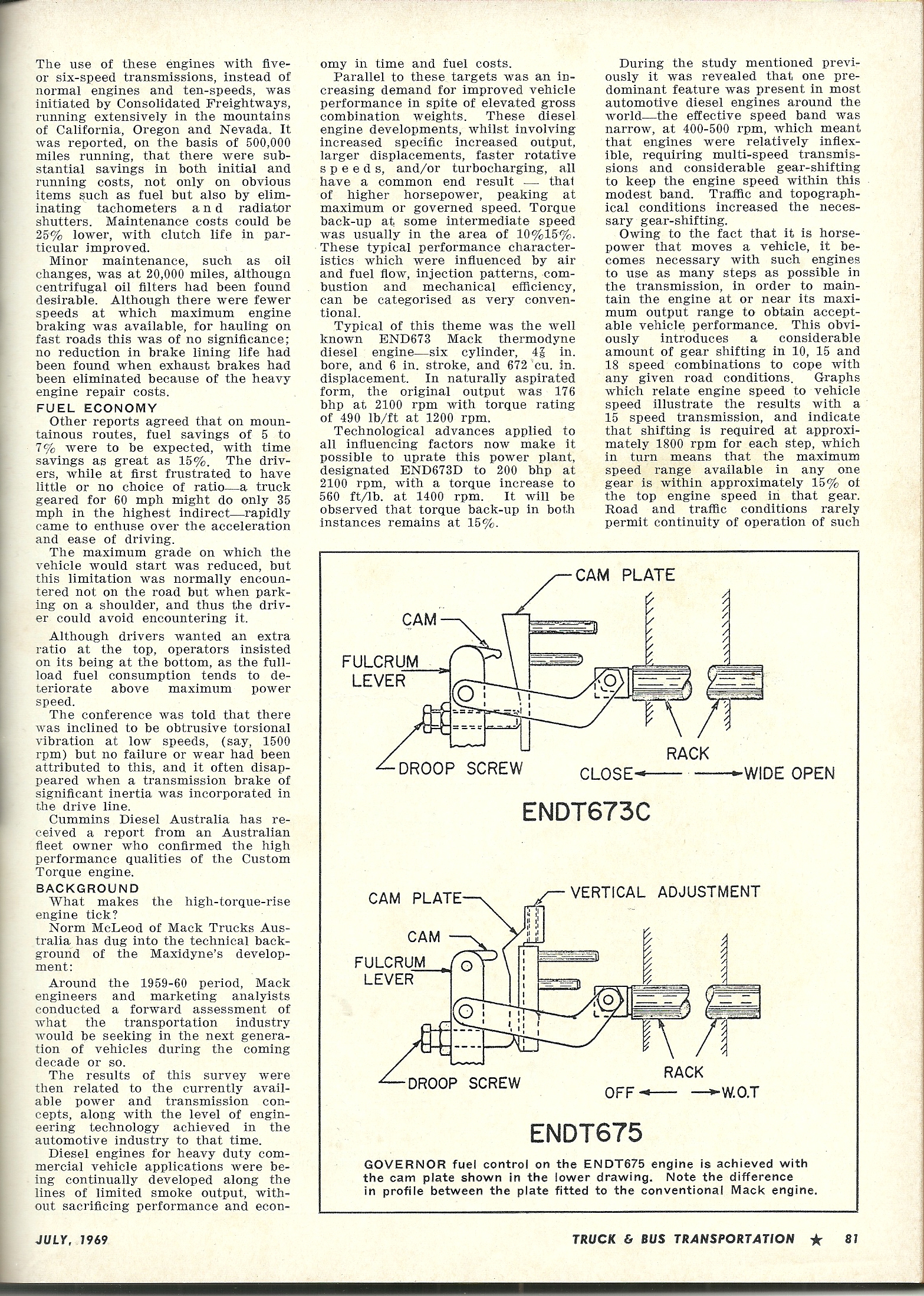

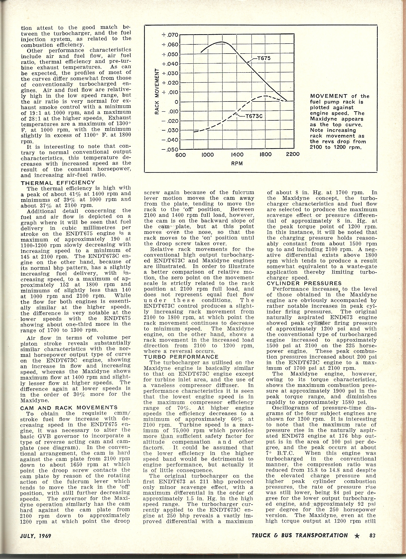

Plenty of information on how the Maxidyne works and the principal behind them

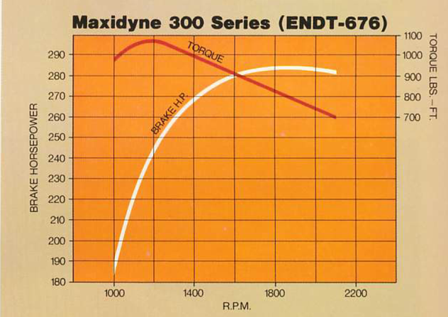

Exactly.  Keep the Maxidyne up in the 1800-2100 RPM range, and it is well off its torque peak, which was down around 1200 RPM.
It's only when the RPMs start to fall that the increased torque of the Maxi becomes prevalent.
And, like Terry said, if it's just a toy, and isn't too heavy, it probably won't be an issue anyway.  But, if you're gonna work it, just keep the RPMs up in the normal Thermodyne operating range, and drive is sensibly, and it should be fine.

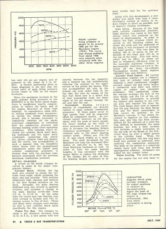

That being said, the 676 still is a monster, torque-wise.  Look at the graph below (for a 285 HP version).  Even at 1800 RPM, it's still got 825 ft-lbs on tap.  That was more than most transmissions of the day were rated for.  Hence the triple-countershaft Maxitorques.  I wouldn't jerk it too hard!
