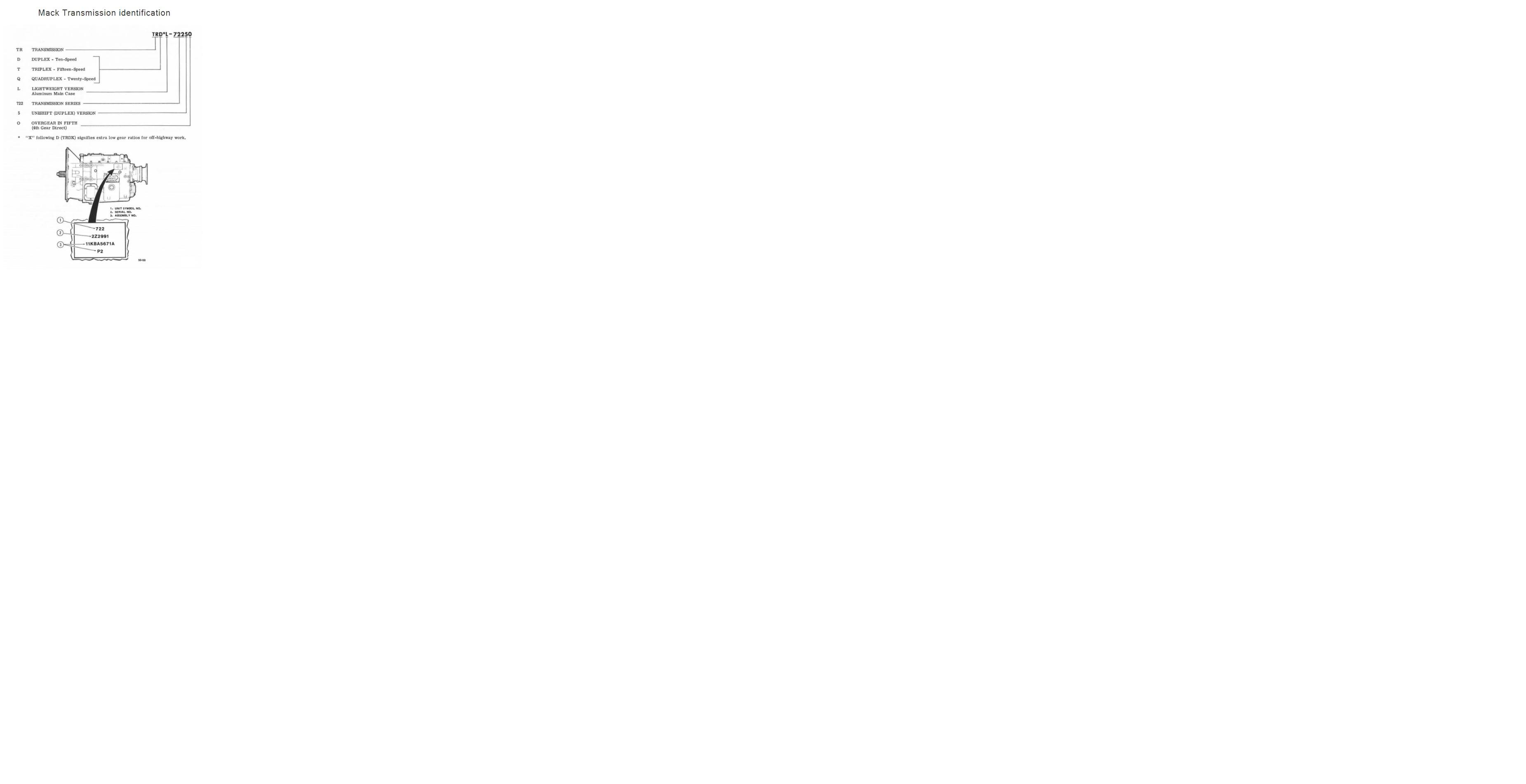

Yes, sometimes the "END" was omitted from the engine marking (ENDT-673 for instance), because ALL the diesel engines at that time started with "END" (ENgine - Diesel).  The ENDT-673 was a turbo (T) version of the "673-series" engine.  That would have been the venerable "Thermodyne" engine.  I know they were available in at least a 250-horse version.  The END-673 would have been the normally-aspirated (non-turbo) version of the same engine.  And, yes, it was 672 cubic inches.  The "672" series was an older engine.  The "673" was used to denote the "new" engine.  Another very common version would have been the ENDT-675...the much beloved 237-horse Maxidyne (still 672 cu-in).
Remember, the model number on the truck actually hinted at the powertrain configuration (R611 = ENDT-673 Thermodyne), (R685 = ENDT-675 Maxidyne).
There were also similar numbering "clues" on the transmissions.  Lots of folks don't remember that a "0" on the end of the trans model number denoted overdrive.  Like, TRQ-7220.  This was a TRansmission - Quadruplex.  I believe the 722 indicated the torque rating or the particular gear rations used...or something.  The "0" indicated that it was "overdrive in 5th"...making it an 18-speed rather that a 20-speed.  I used to have a list of all those trans model numbers and what they meant.  I need to see if I can find that...  The attached pic shows a little of that.  Again, elegant.
Sorry for the rant!  I guess I just miss being a part of the conversation!!!
I printed out the spec sheets from here many years ago.  It lists the transmission code and gearing.
