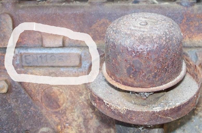

Yes, it is a Continental F6 226 cid made under contract with Mack and will have the Mack script cast into the block side wall on the drivers side.
The Mack EN 11 is a Continental F6 209 cid.
The engine number is stamped on a machined pad in the block to the left of the oil fill and above the generator.  EN 11 example.
Jim

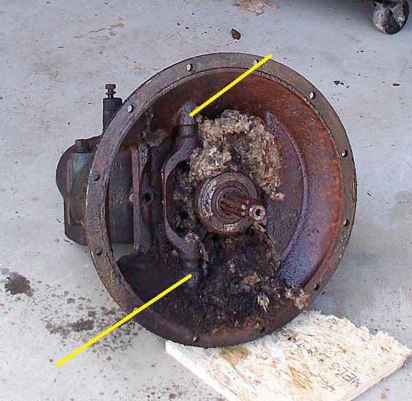

Hi, new here, I have a 1938 Mack truck frame with the gas flat head six engine and a four speed. My clutch would not disengage so I took the trans out and cleaned all the rat and mouse house out and all the old burnt clutch gunk off so the plates moved freely had the clutch rebuild, replaced the bearing. I put all back together and clutch still will not disengage. Is there some kind of adjustment? there are only 4 parts to this and don't see anything else broken or worn out. any help would be great.
