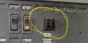

in need of a new power divider switch that goes on the dash. been 3 weeks. 2 different dealers and no one knows what im talking about nor can fine a part number so they can order one. when they run the vin they cant find it either.
does anyone know the part number? not sure if they changed between years but my truck is a 2000 CL713
thanks

19 minutes ago, terry said:
might be different switch, but would do the same thing, can you post a pic of yours?   terry:D
im out of town right now. ill see if i can fine a picture on google. true it does the same but i have no place to mount a which like that since my dash isnt setup for it. that looks like it came out of a RD or maybe a superline?
1 minute ago, 2000CL713 said:
im out of town right now. ill see if i can fine a picture on google. true i does the same but i have no place to mount a which like that since my dash isnt setup for it. that looks like it came out of a RD or maybe a superline?
Some of the older switches were the same, but with a round faceplate.    terry:D
Maybe try Peterbilt for your Mack parts?  Here is a used one on ebay that looks like yours.
Since Volvo doesn't want to make their customer happy, buy the part from PACCAR.
https://www.ebay.com/itm/Peterbilt-3200-2E-59C-Power-Divider-Airolectric-Switch-FREE-SHIPPING/282760070274?hash=item41d5d04482:g:o0MAAOSwjodaJZJ3&vxp=mtr
no lie. i was looking into buying peterbilts lol but as for the switch in my search they have a few different kinds but they look the same on the outside but the backs are different.
10-4
Velvac has a couple of listings.  032231 or 032227  primarily Mack
                                                        032229  or 032225  primarily Volvo
Maybe this will help narrow the search?
Jim
