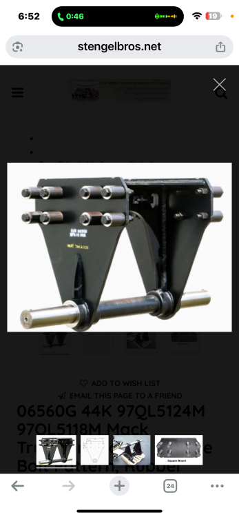

  2. Here’s a picture of the stand
  3. They are supposed to to be better the factory the design and build and of course easy of installation my truck came with rubber busing no grease fitting and it’s 4100.0” I opted for the brass busing with grease fitting 2200.00 I believe all parts and stand was cheaper then just the factory design stand with rubber busing shipped was around 3500.00 sigh all parts needed
  4. I’ve used 1 in my other truck before no problem with it heavier steel the other 1 and this 1 cracked in the same place right off the chassis in the bend and this 1 has a few more cracks

  7. Ok guys need some guidance on this had a trunnion replace in 1 of my other Mack dump trucks the shop that did it the owner passed so now it’s time to replace another in the Mack I have left I’ve ordered the trunnion should be here Monday any tips or tools you guys can tell me to assist in this I called around to get it done but everyone is at least a month out or more and 6/8 thousand dollars Ive owned and maintained trucks and equipment for almost 21 yrs I feel I’m over thinking it my plan is to get the front end on blocks get the back secured and cut it all out Left everything I can out with my excavator then jack the back up I also have to ream the holes out to 1 inch but like I said any tips or guidance will truly be appreciated Thank you
