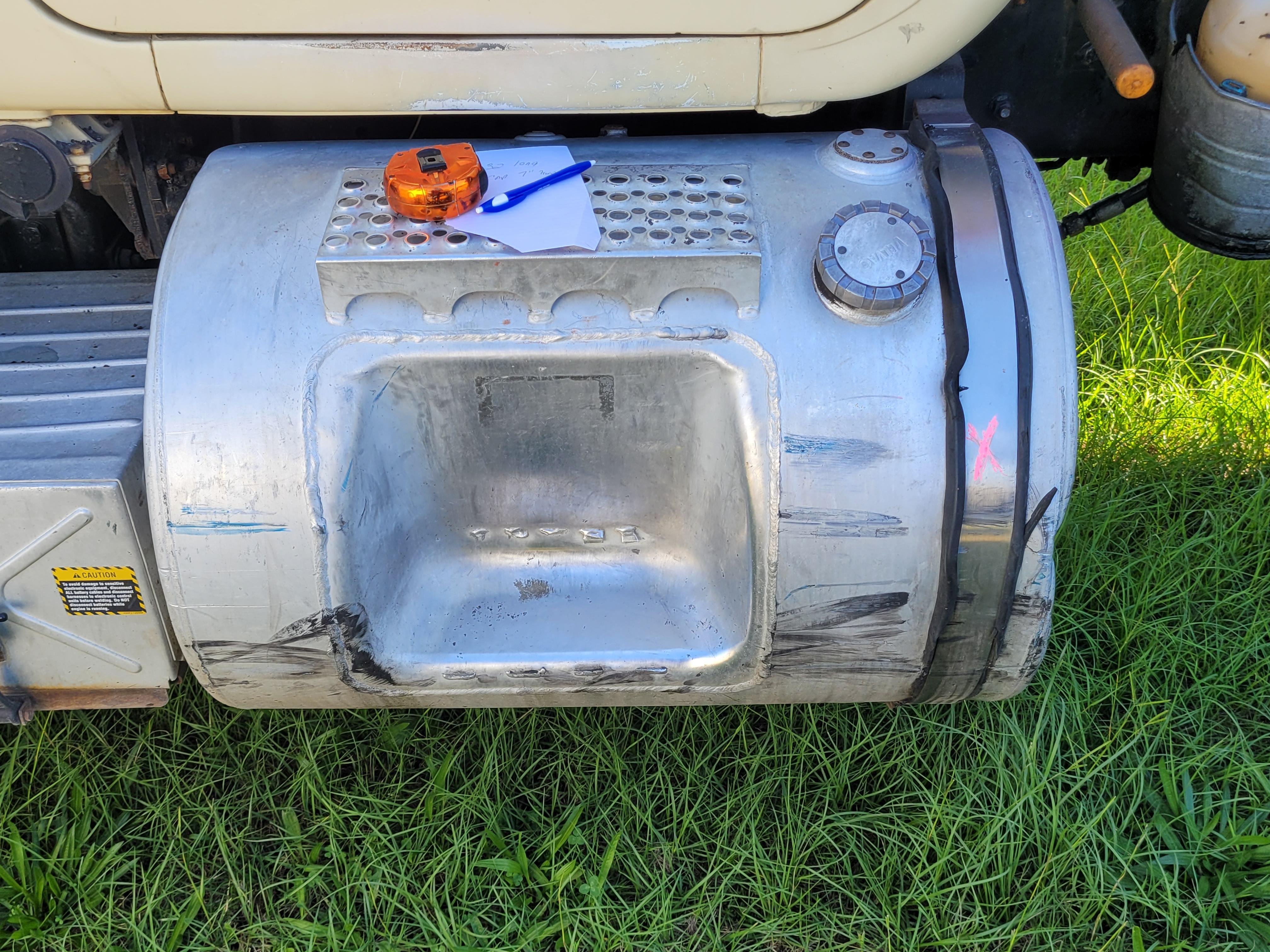

  18. 2000 rd688s e7 400 hp Eaton 8ll transmission truck is a great truck works everyday I have a new truck ordered and don't plan to deal with drivers anymore I've had enough rear bushing will need replacement soon truck has new floats on the front new clutch and flywheel demolition body with high lift gate I've replaced the turbo yrs ago and 1 eup everything else has been basic maintenance done I'm asking 40000 cause Bushing will need replacement there not walking but I feel a vibration or bump in the rear and a pay attention to the Rear-end
