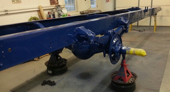

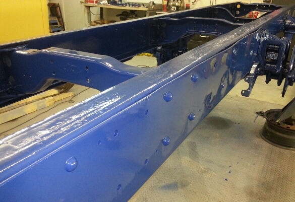

Looks good. Not being critical, just curious; did you put any kind of sealer on the frame where the outer layer buckles away to keep water from getting in there?
I did......I used POR 15 in the seam to stop what rust still remained and then sealed the gap with automotive seam sealer.

10 hours ago, Bigben89 said:
Just asking your andprocess since I'm just finish ing up blasting a 41' International frame..
You blasted, washed/prepped frame, primed frame, then POR 15 the spots you needed to and applied paint? Any Clear? (frame doesn't need it but curious)
All that is correct......just be sure to sand  and re-prime any por-15 spots.
I didn't use any clear. Just single stage acrylic enamel with a hardener.
Oopps. Correction.  I only used POR-15 down in the frame/fish plate seam. After blasting , all the rust everwhere else was gone so I didn't feel the need for it elsewhere.
Good luck on your '41! Share some pics.
