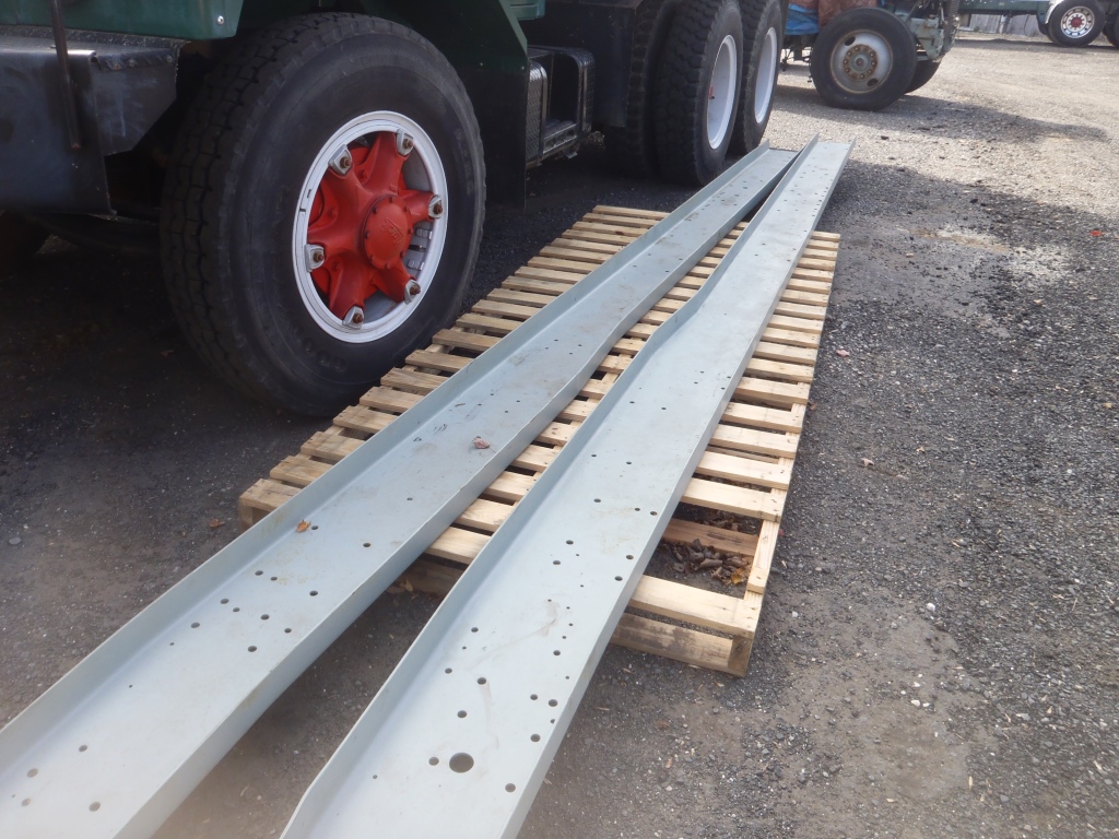

I'd like to know if someone can shed light on frame work ,
when you sandblast a frame that is old you have some crevasses ( or also called pitted metal) what product do you use to fill them before repainting ?
When we did the B Model be dismantled all three frame rails and after sand blasting they where as you said "pitted" so we primed all the rails then used a good body filler on the outside of the outer rail where needed and just the inside of the inner most rail. We then primed them again and then painted and they came of like glass you can't tell that they where ever touched.
yup, same with mine, blasted and used good body filler as long as its not rotten enough to be a structural problem. even welded up some extra holes and duraglassed them and filled over them. smooth as glass. there is another product out there called almost metal or something that's a two part body filler to
I would put two component glass wool filled body filler to work out deep pits.
Or just a common "soft" filler if the lay isn't thick.
