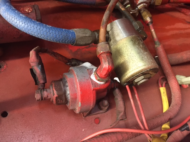

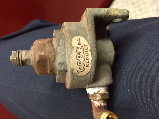

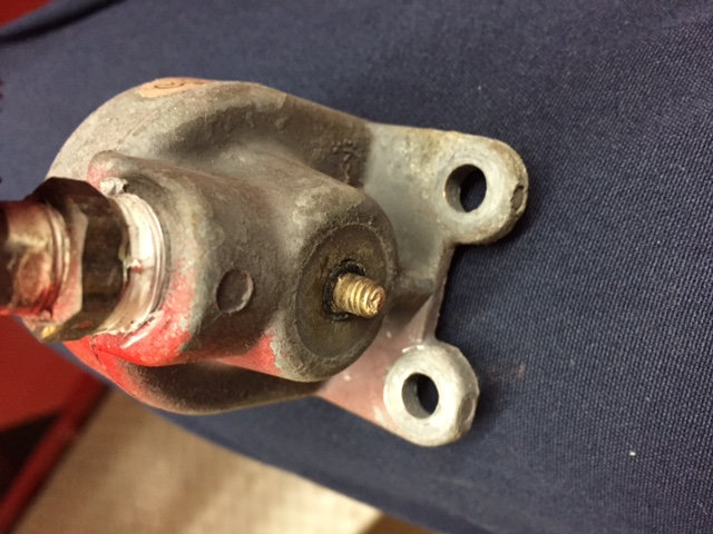

Tracking down some air leaks on our 52 LS125 with air brakes and broke a threaded post off the bottom of this valve (old red one) located at the passenger side firewall.

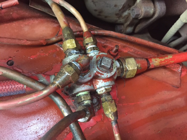

Air line goes to a 8 way air tee. Top wire goes to ground, bottom wire to the harness and then to who knows where.
I don't think it's the brake valve as that's at the frame rail on the drivers side IIRC.
Any suggestions as to what it is? Replacements available?
Thanks,
Dom

Almost as Maddog said, the warning buzzer switch.
The threaded post you've broken might be taken out from the housing together with isolating bushing and swapped out with a similar one.
It too probably the same part is also a contact terminal inside of the valve body and might be fabricated of a common screw. A brass one would work better.
I'm not 100% sure since haven't taken mine apart yet but it seems to me the way I said and worth a try.
Thanks for the tips. Nothing noted when wires are connected but our harness is a rats nest so no telling whether it's connected to anything at the other end. Brakes and brake lights work fine without it installed. I had to fix that once before and it's on the drivers side frame rail.
Still not sure what this is but I'll get a replacement and wire it back up. For now the air line is capped.

They HAD them. At least in 1945.
Buzzer reminder switch.
Military, Emergency and Bus Chassis had them as standard equipment and optional on standard chassis. According to my old time MACK PARTS MAN

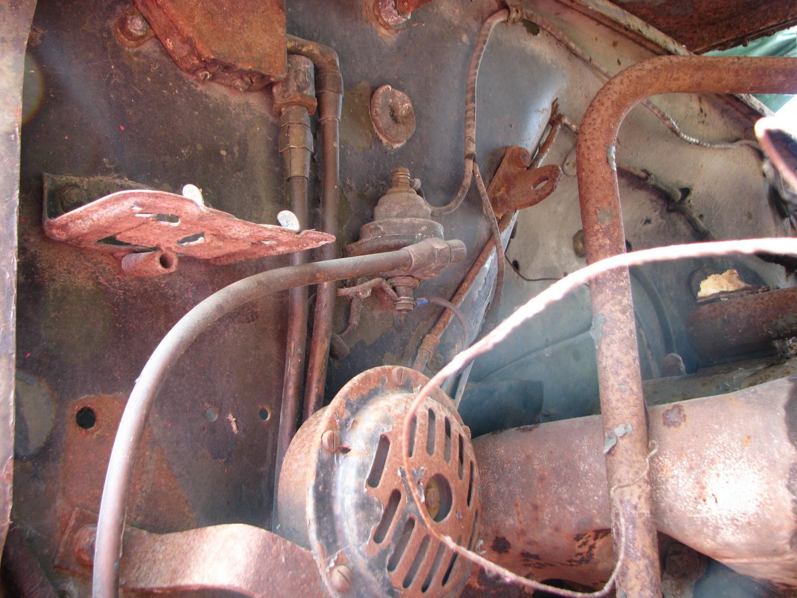

Anyone have a pic of the buzzer so I know what I'm looking for under the dash?
Ufff... I would say track down the wire and find it but you noted the harness is off.
My cab is currently difficult to come along. I might try that in a couple of days.
Try checking the wire going to the switch for voltage with the ignition on. If it has voltage you can then short the wire to ground to sound the buzzer so you can find it. I assume you have heard a buzzer when you start the truck after it sits and the air pressure has gone down??
