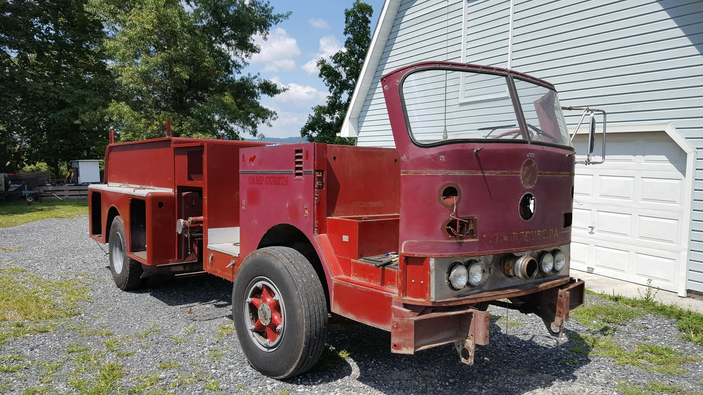

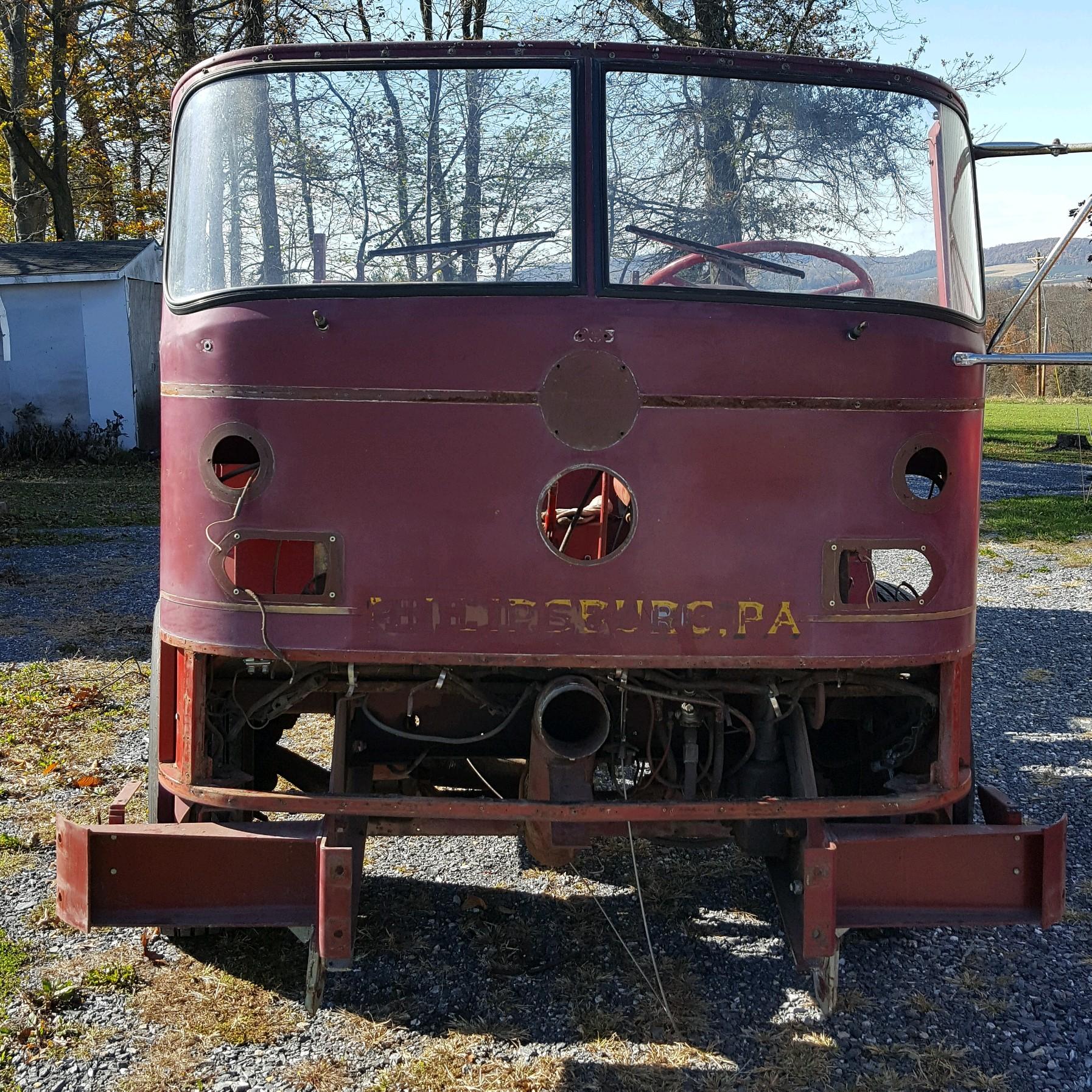

Quick little update; I have most of the items off the cab, and am shooting for a late September timeframe for painting.  I've been looking online for mounting strips for the chrome trim pieces, as some of them are rotted beyond repair, but haven't had any luck so far.

Not a whole lot to update on this project, a few weeks ago I managed to get the headlight panel off, opting to cut the front intake adapter off after many non-destructive attempts.  What I've found to be interesting is that as I removed a lot of the trim pieces, I found only primer underneath, seeming to indicate that the trim was placed before the rig was painted.  My plans of getting the paint done before cold weather set in never came to pass, but I'm hoping to hit the ground running again in the spring.

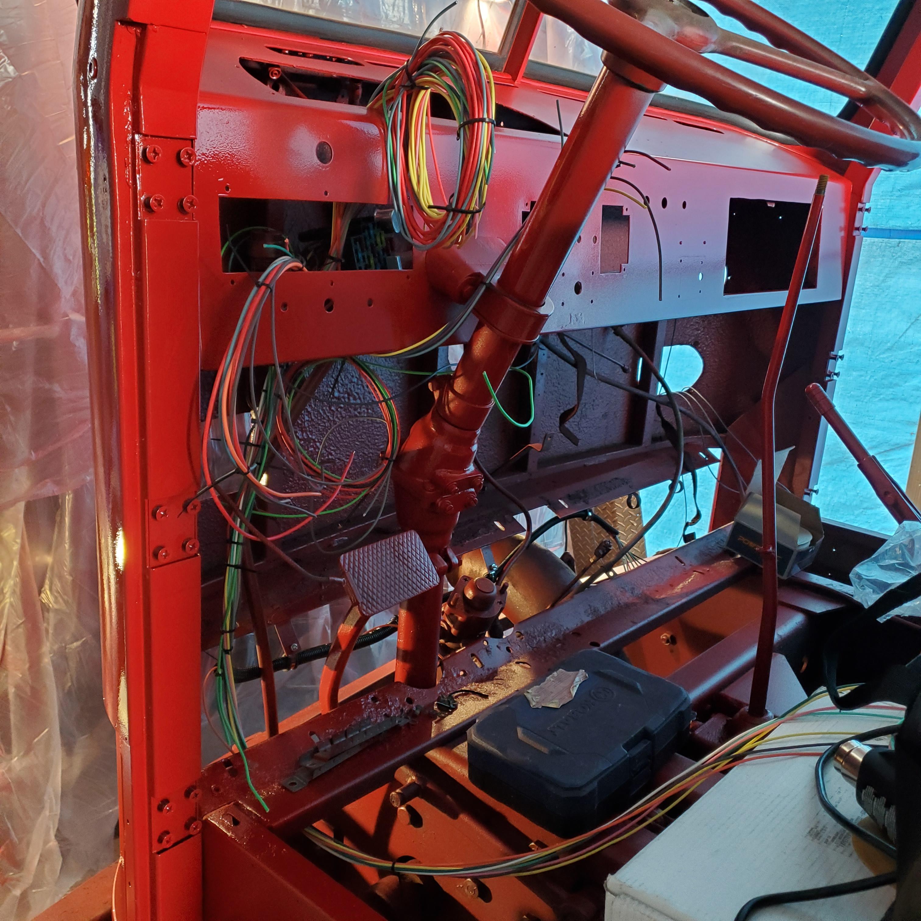

Progress continues.... slowly.  Life seems to be getting in the way of making any meaningful progress lately, but I have been getting little odds and ends done as time permits.  I was troubleshooting some things today, and would appreciate some insight/opinions.  A few weeks ago, I installed some of the warning lights and tested them with the ignition on, and all was working well.  A few days ago, with no changes to the system, when I turned on the ignition there was barely any power- not even enough to run the electric fuel pumps.  I tested the electrical from the batteries up to the ignition switch, and have consistent voltage throughout the system, until I get to the output side of the ignition switch, where it drops to 0.2v.  Am I correct in thinking that the ignition switch went bad?
