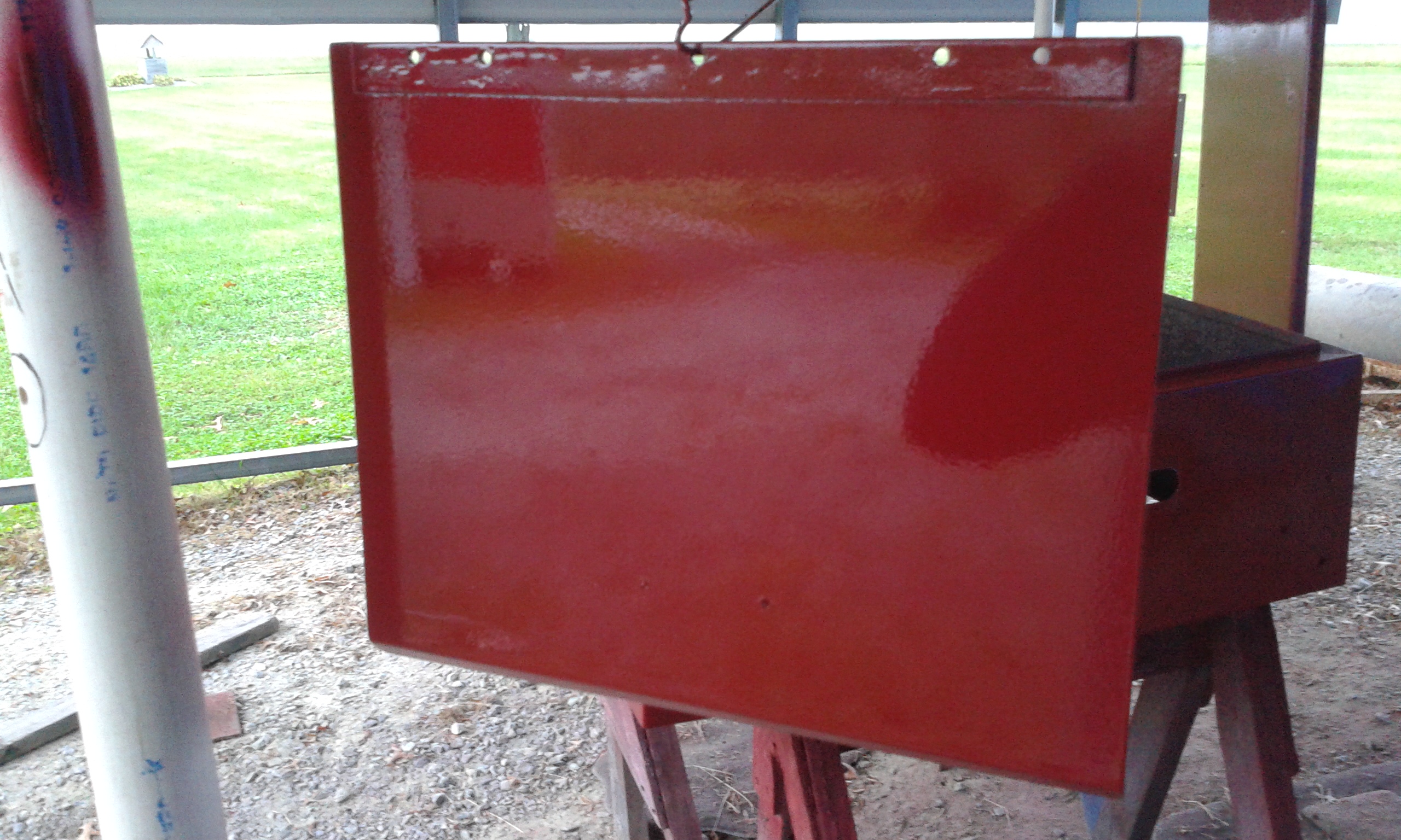

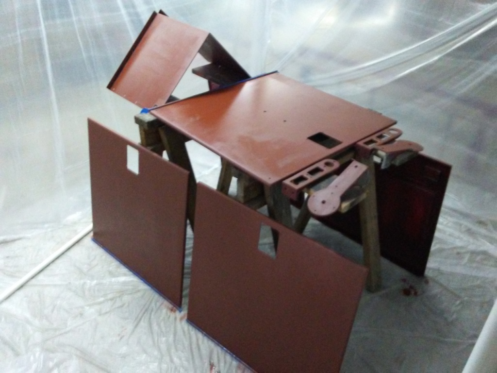

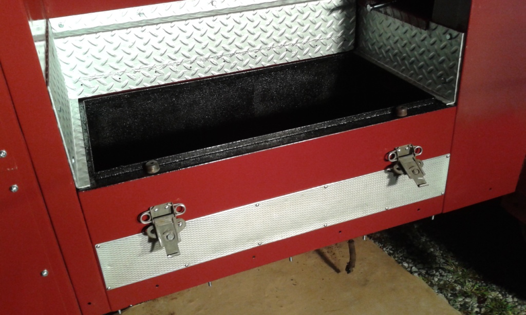

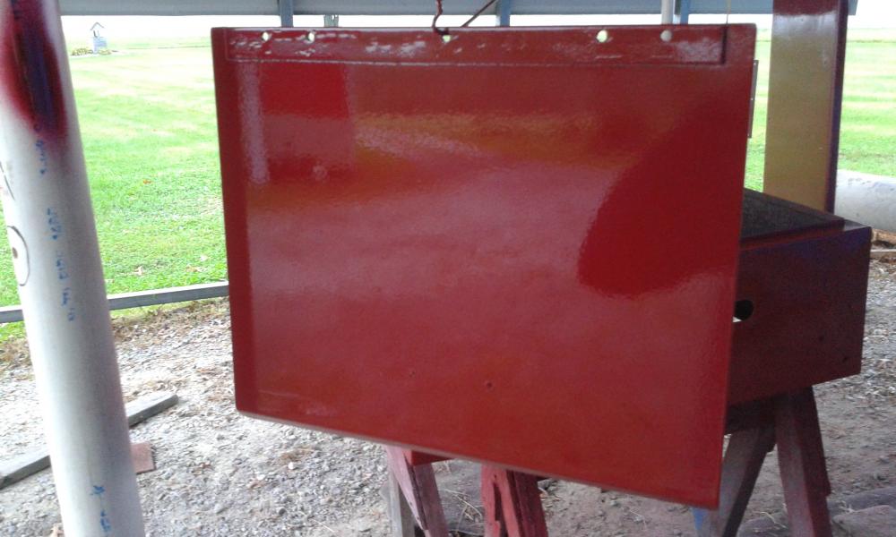

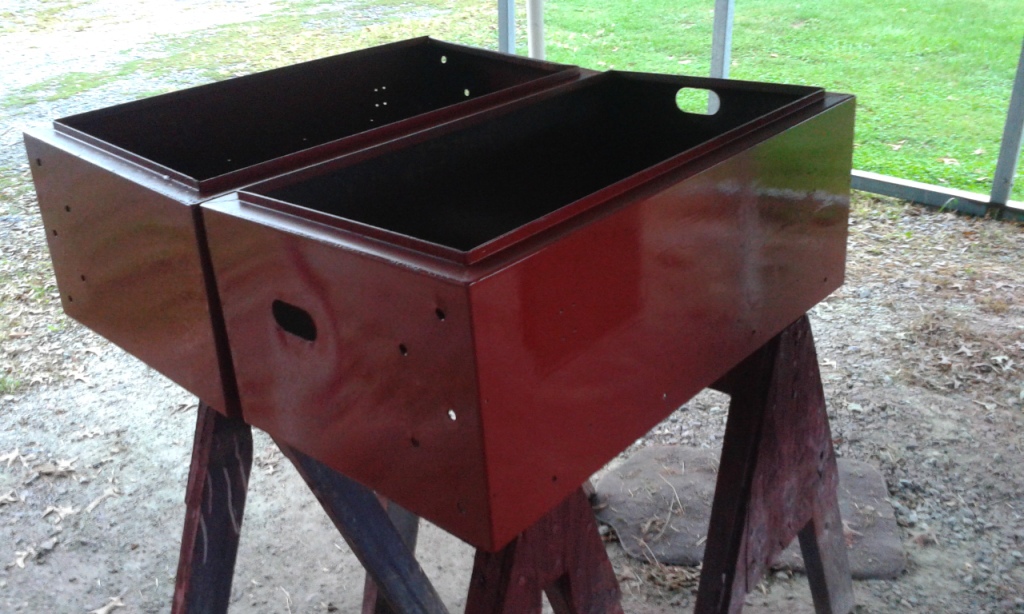

Did some painting:

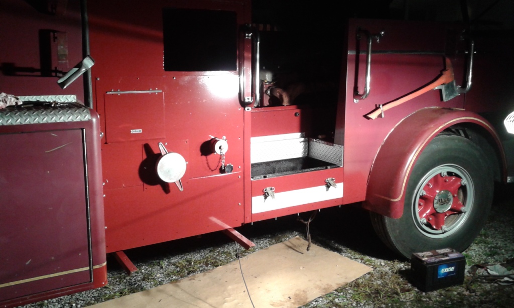

Put things back together before the York muster:

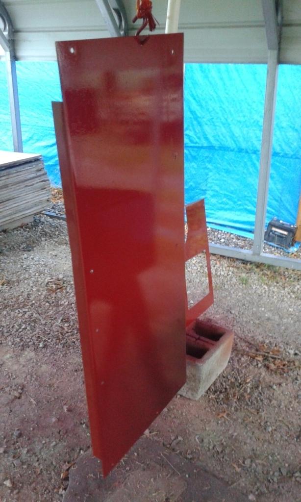

The big body panel suffered a little mishap after painting, and is a little scuffed and scratched, which I plan on fixing when I do the body.

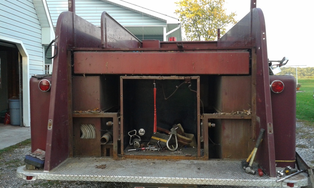

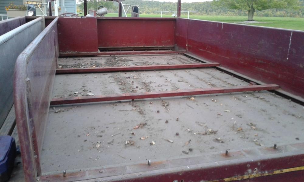

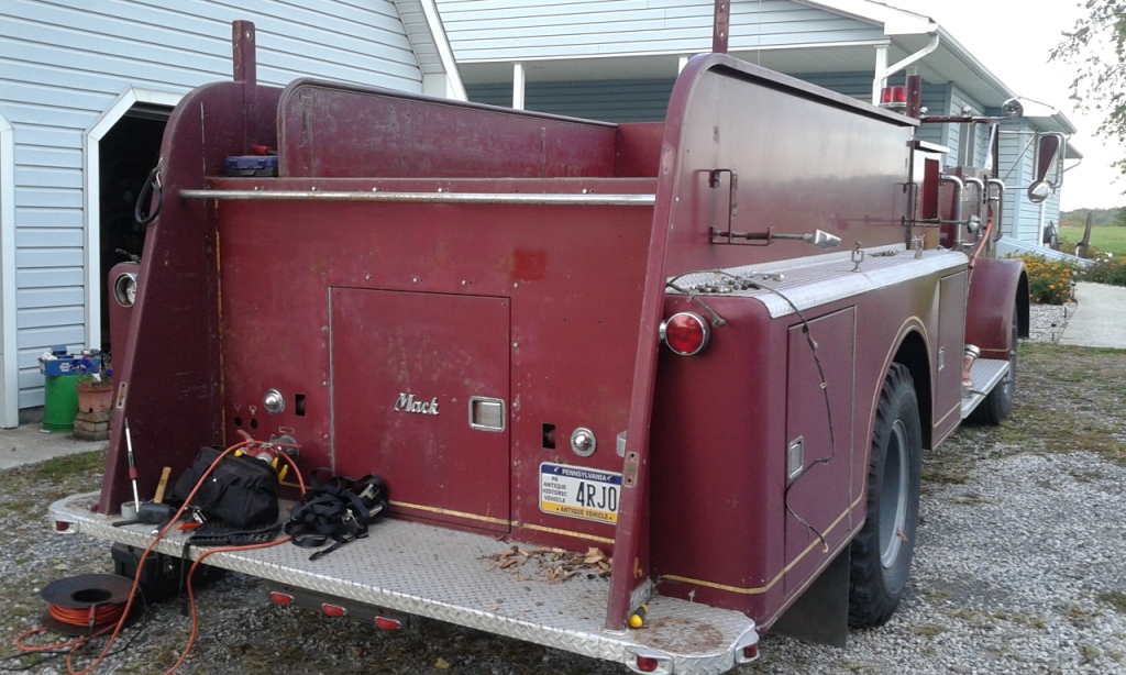

After the York Muster, removed the hosebed floor, grab handles, taillights, hard sleeve trays, ladder racks, rear spot lights and emergency lights.  Planning to rewire the lights on the rear, after I get the turn signals off and paint the body.  Any suggestions other than a lot of little turns with a wrench and small fingers?

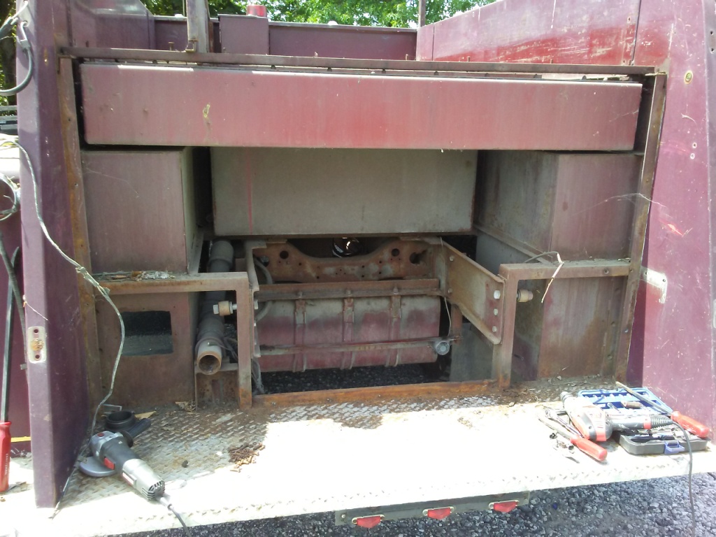

Removed the rear body panel.  I couldn't figure out any way to remove it other than cutting the welds and removing the bumper, so I decided to cut the body panel where it met the bumper instead I plan on removing the rear compartment before cleaning everything up and starting to prime and paint.

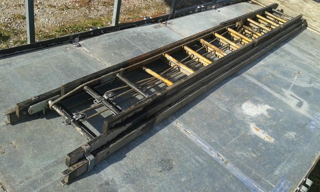

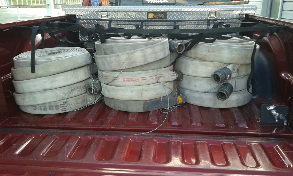

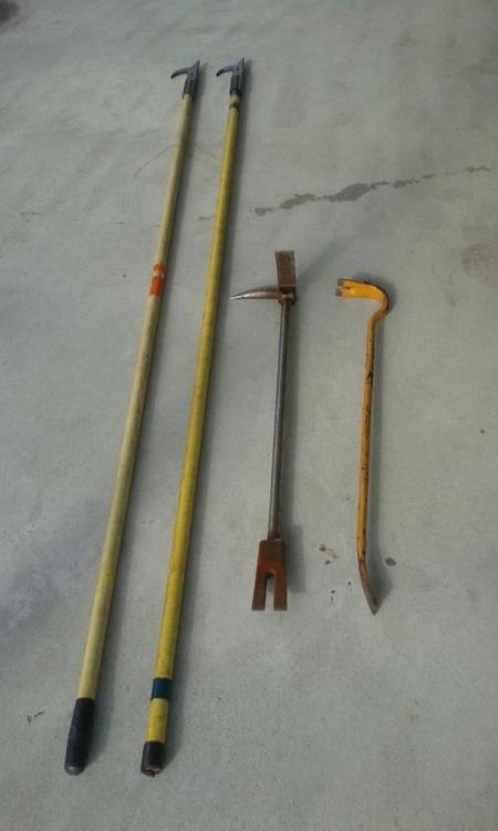

So I haven't gotten to do much work on the actual truck, but I did acquire some more equipment to carry on it this weekend.  Friday night I got some more hose (1-1/2" and 2"), and am planning on building "blitz boxes" to keep them in as crosslays.  On Saturday, I loaded up and headed to Hamburg to pick up some hand tools, and from there proceeded to Boyertown to pick up a ladder from @yarnall.  I then received the grand tour of the Yarnall truck collection, which made me green with envy and gave me something to work towards- if only I had the money, space, and a willing wife! :lol:
Nice!  I've got to get on the ball and start finding some tools for my truck.  Fortunately, I have a shallow hose bed, and I had snagged some retired 3" and 1.5" from my department, but I don't have any tools, nozzles, or appliances at all.  Hopefully in the spring I can start looking for some swap meets to start finding that sort of stuff.
Did that ladder come with a couple of people to help you lift it?!?!
I was pretty fortunate, a lot of hose, nozzles and other equipment came with this when I bought it, there were just a few odds and ends (like the ladder) that I needed to get
I looked far and wide for a ladder for my ALF a couple years ago, but everything I found was a million miles away, and shipping a full-size ladder generally cost a lot more than the ladder itself.  It's good that you found one within driving distance.....
Fortunately, my current rig came with a nice wooden ladder, so at least that won't be an issue.
If you need to have the wooden ladder re-habbed the Delaware Department of Corrections does that kind of work at a very reasonable price using convicts who are training in wood working.

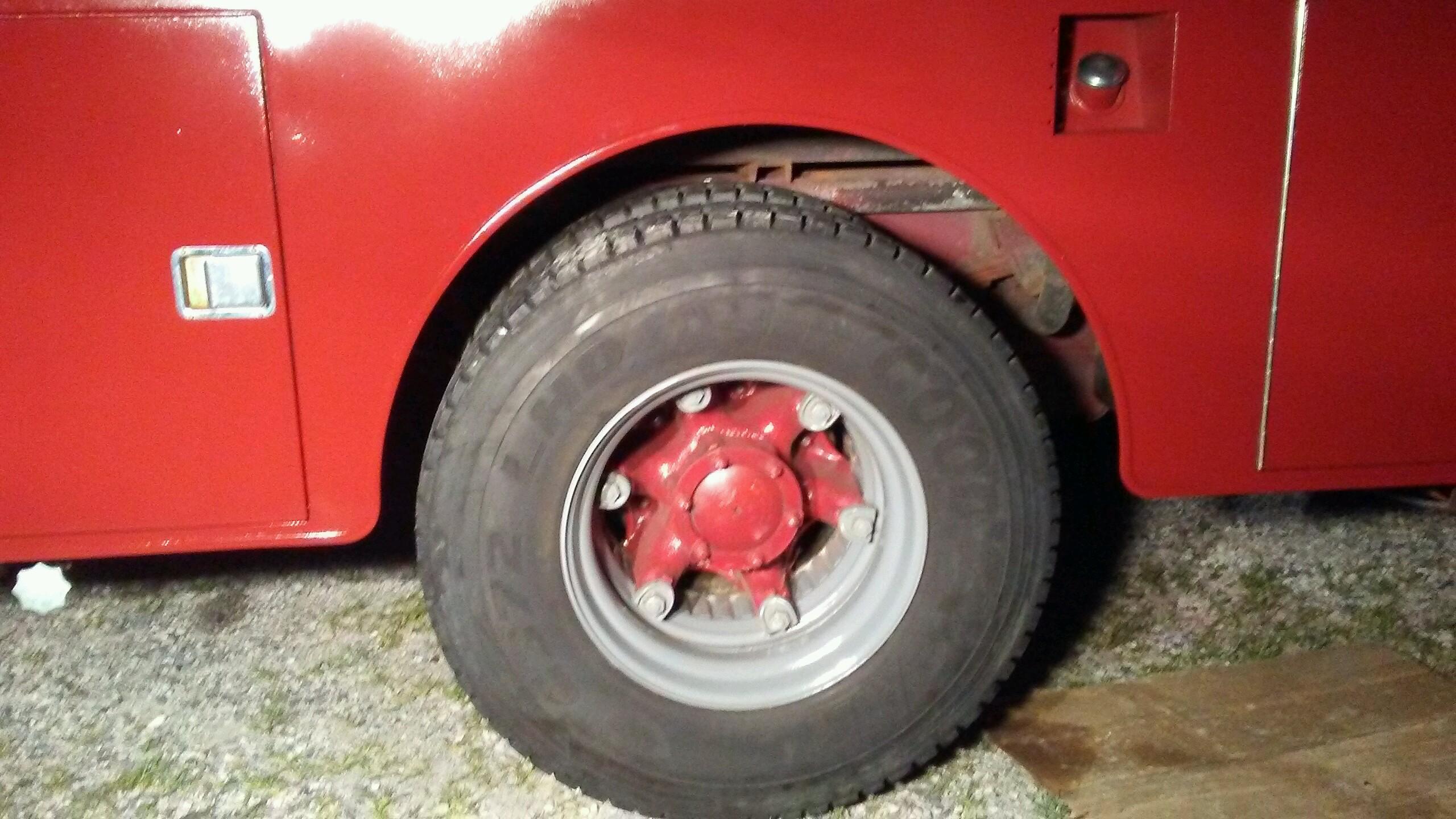

Alrighty, back to posting updates for this old war wagon.  My time to work on it has been limited due to the kids and overtime at work, but I have the painting almost done on the rear body, and got barely used tires for the back wheels from my parent's church, who had bought new tires for their bus and then decided to scrap it.  I slapped things together quick to get me to the Pump Primer's muster and back.  I didn't attempt to draft this year, but had a neighboring rig flow water through the pump for about an hour.  The night before the muster, I was planning on going drafting, but found the primer to be inoperable again, took it apart, tested the motor and solenoid which were both fine, cleaned up the gears and body of the primer itself and put it all back together, all for it to still not work.  There is no power getting to the primer switch, but even bypassing that with power the primer will not turn.  An air primer is looking better and better every day!  I've also been finding that since I painted the body, the rear lights (tail/brake lights, turn signals) don't want to work anymore; I'm figuring because of the new paint, they aren't making contact for grounding.

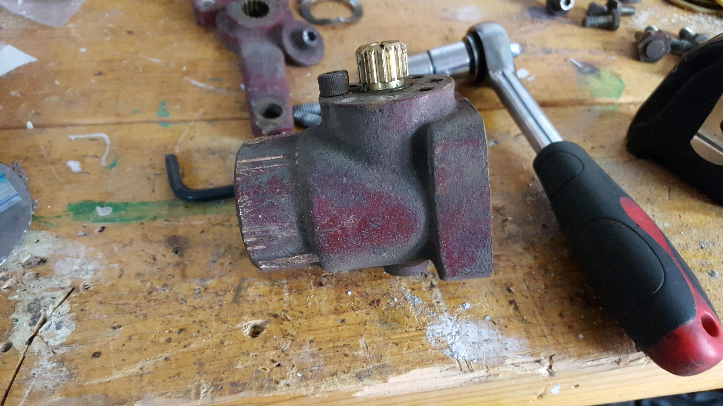

With some nicer weather, in between rainy days, I've been able to dive back into this rig.  I've removed the 1" discharge valves from the pump (booster lines and pump to tank), and found that 1 is an akron, but I am not finding any manufacturer name or number for the other two, which look like this:

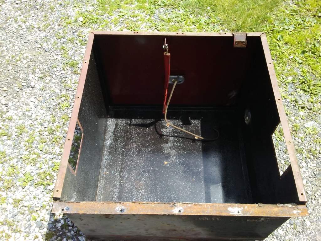

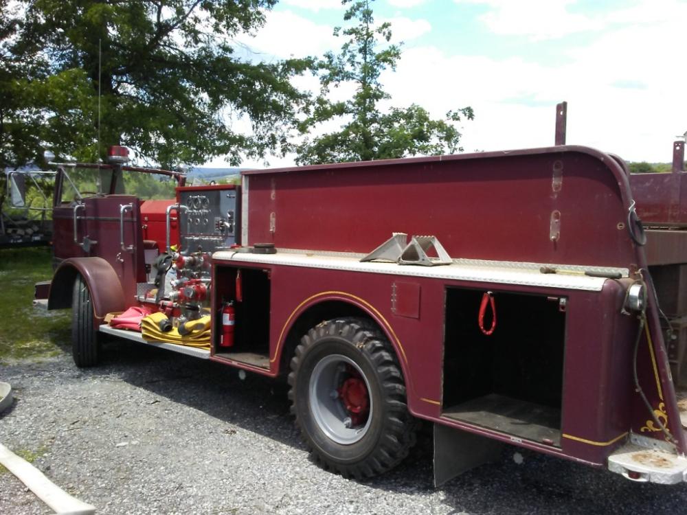

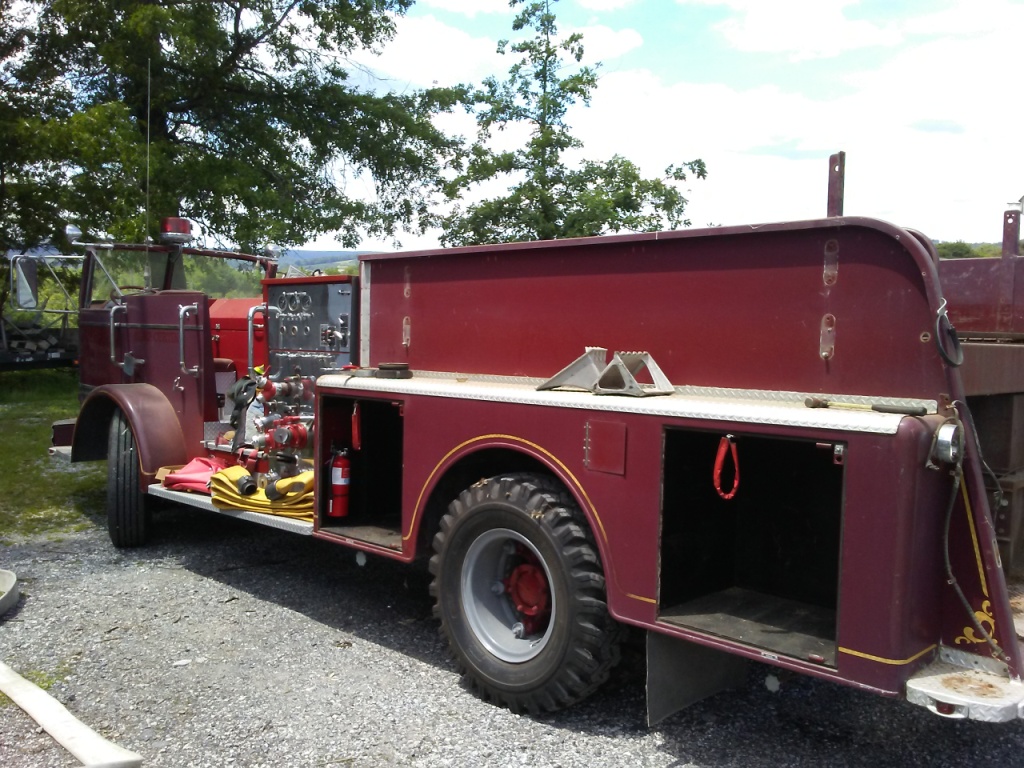

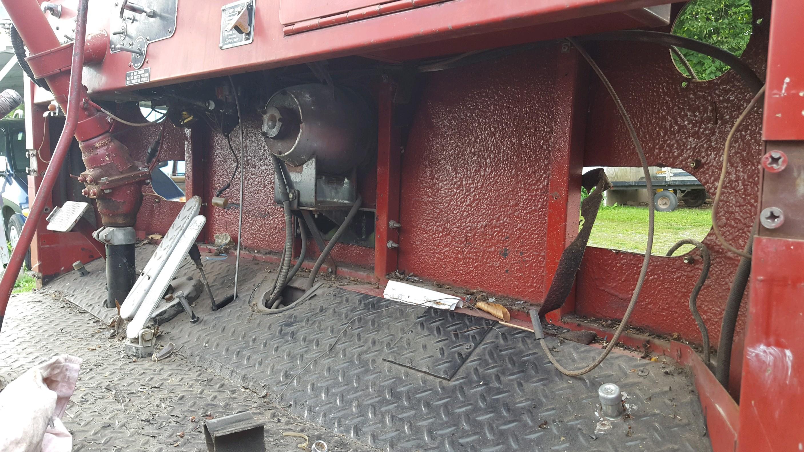

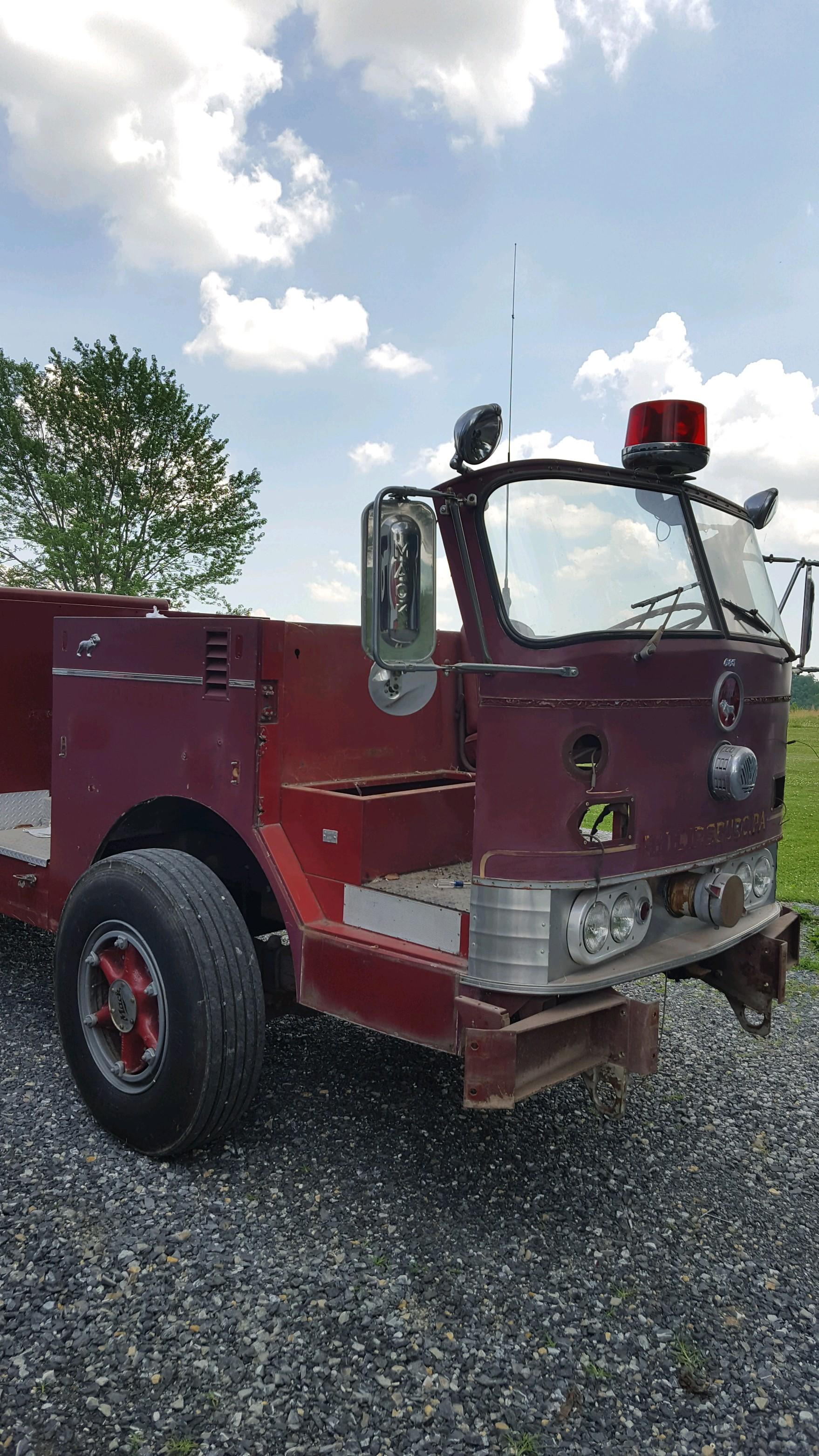

A little progress from the other day, didn't get too crazy because of our recent heat wave here in southcentral PA.  Removed the cab doors, front warning lights and turn signals, bumper, and the under dash panels to remove some extra wiring from over the years.  Also have the front fenders off, and most of the cab trim.
