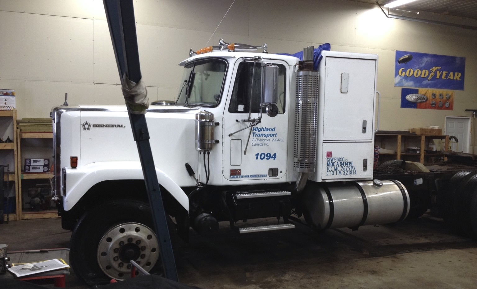

we have an 85 General small sit in sleeper that still has metric gages. The door says Canadian Dare Devils. Owner told us that the truck pulled the "wall of death" for the motorcycle team. It needs paint but we have started restoring it. Its a B.C. 3 Cummins 13 speed Rockwell 3.90s on Reyco. I can try to send you pics if youre interested. Truck runs and drives very good. And that's not a sales pitch
