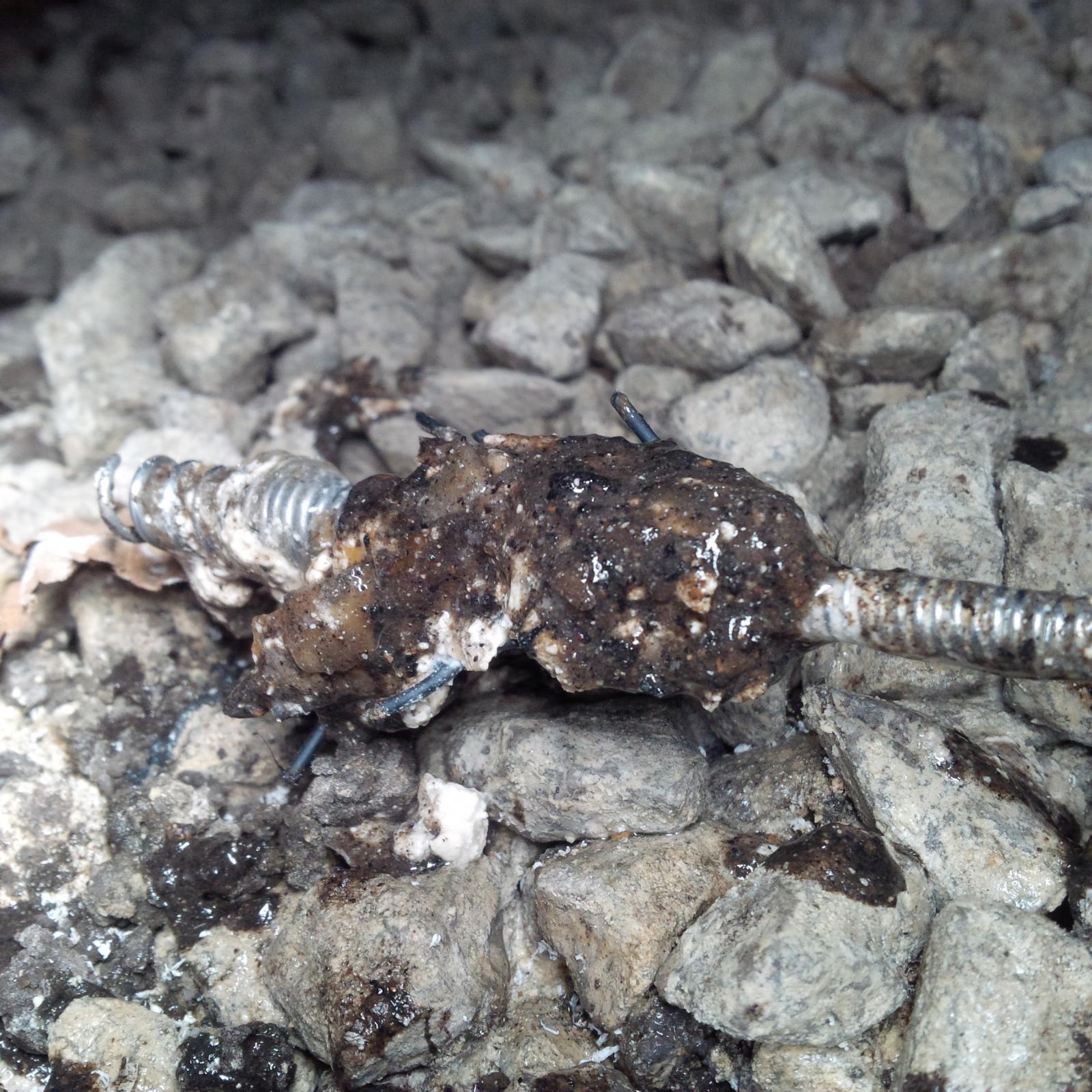

Kitchen sink quit draining...been messing with it since Thursday night. Run the snake 25' through the line, and the sink still fills up. Finally had enough & made a cut 14' from the sink...ran the snake backwards all of the way up into the sink. Wrapped about a dozen short pieces of bailing wire around the end of the snake to make a wire brush and then pulled it through the line. Removed a pretty sizable glob of goo...

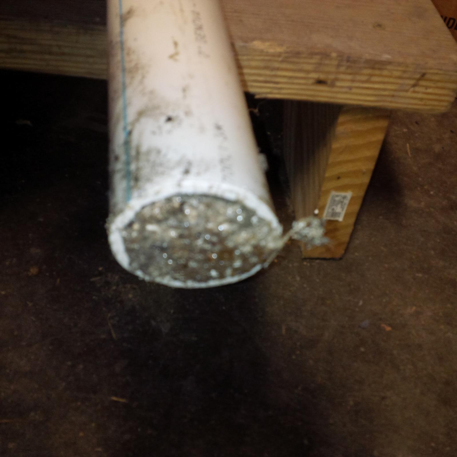

...so you'd THINK if I turned on the water, it'd flow out the drain pipe into the crawl space where I had cut it, right? WRONG! Sink filled up again. So I went back down there with the saw & cut the line over by the wall where it comes down from up above. Couldn't have placed the cut better...right through the clog, with about an inch of it still blocking the drain. It was enough that the water in the sink didn't push it out until I was done cutting and out of the way...then it puked and drained the sink.

I think it was greatly restricted, but still flowing...'til the tater peelings got sent through the disposal by the wife's aunt on Thursday. SHOULD be good to go for a while now, and in about 20 minutes or so we'll check to see if the glue joints are leaking...and if they aren't, call it a night.
BTW, the clog was right where the 1-1/2" pipe coming down from the sink opens up into a 2" run across the width of the house (27') before bending down again to join into the main line out. In other words, when the pipe opens, the velocity of the water slows and allows sediment to settle...and over time that builds up. That's the theory I'm going with, anyway...
your on to it here all drains must, hang on I will use bigger letters MUST have a constant fall and I do mean constant fall, and any change in fall MUST have a inspection point a blockage will always happen were there is a change in fall anyway sounds like you have it by the balls now happy draining
