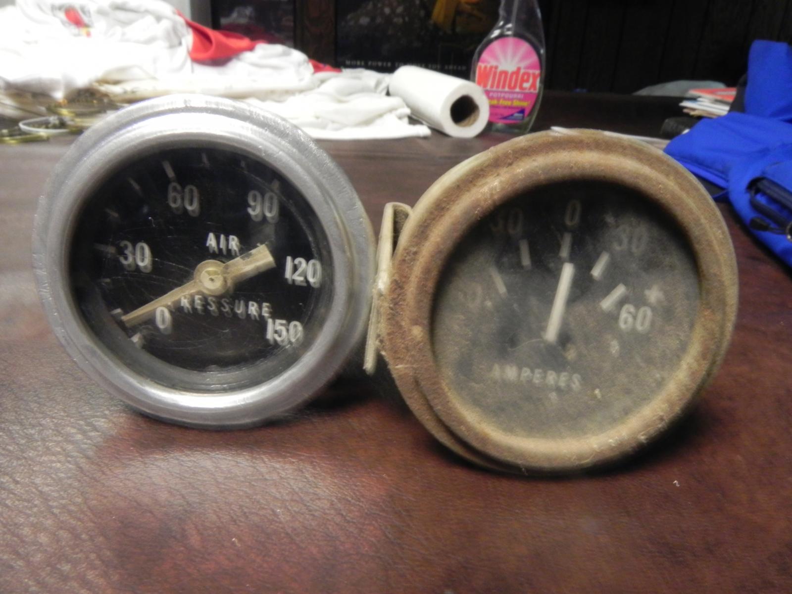

I have taken to trying to take my original gauges apart.The bezels weren't that bad to undo.I had to do this to cleanup the faces of the gauges.Will post some pics when I'm done.
Don't forget to tell us how to do it too.. Paul
It's not the best picture but you tell the difference between a before and after.After I cleanup the bezel with asome emery paper I used some silver paint on it.I am thinking about cutting a peice of plexie glass and make new lenses.Let me hear some comments.Good bad or otherwise.
It looks like day and night!! If they have a glass lens, you can polish it with NOVUS #2 cleaner / polish. A good hardware store would have it. It's similar to the old Glaswax
Looks awesome!!! Nice job
I would try buffing out the glass on a buffing wheel. Nothing ventured, nothing gained. Plexi will eventually yellow.
A glass shop could probably cut new ones at a minimal cost.
Nice job!
