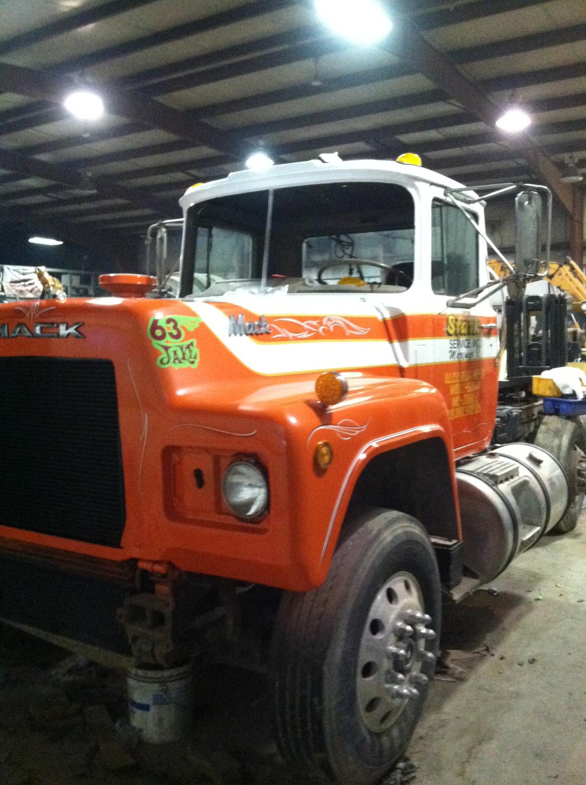

I hope you can see the difference in this pic.
What a beautiful truck storkmack!!!!
If my new addition turns out half as nice as yours I will be happy.
And your right, would never miss the trim when its cleaned up properly. GOOD JOB!
Keith
