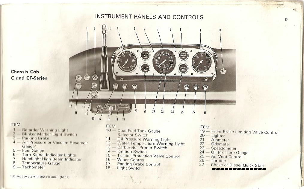

My cousin lives in Haynes Fall N.Y. and just bid on the Fire Department N Model ex Flood light truck. Told me on the dash is a switch labeled Diesel Quick Start. Never heard of it. Ether shot?
post-3242-0-88732100-1387992652_thumb.jp
Paul I have it on my Freightliner COE with 6V-92. The Detroit would loose prime if it sat for a week or so. I put valves in lines to prevent it but that did not work. Anyway it is hooked up with power to give a metered shot of ether. It goes directly into intake pipe after air cleaner. They work well. Ether canisters for them are pricey though.N-Model with a Diesel great find. Joe D.
