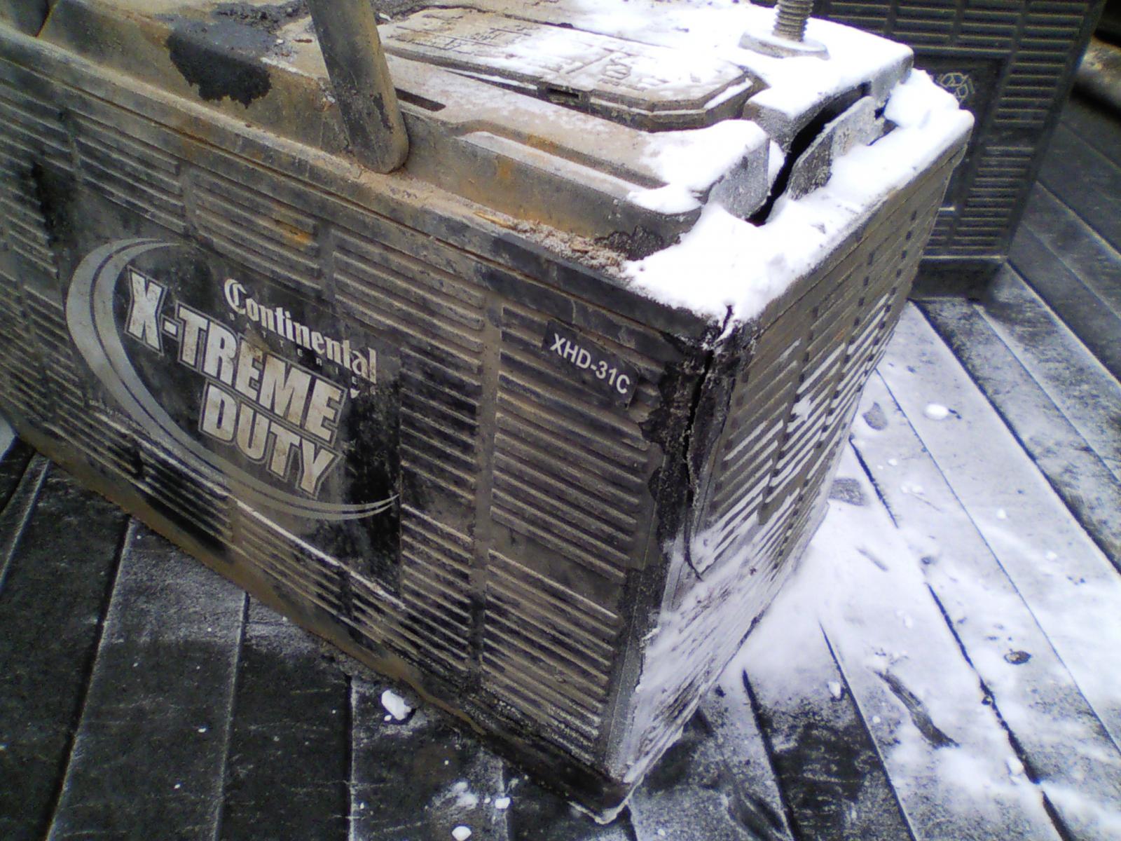

I'm not a fan of "cheap" batteries....not anymore. Not after I had one blow up.

When that battery exploded, I disconnected the cables to it and ran off the other two the rest of the day. Truck still fired up just fine without that battery connected. While I've never tried it, I would imagine the truck would also start with just one battery.
