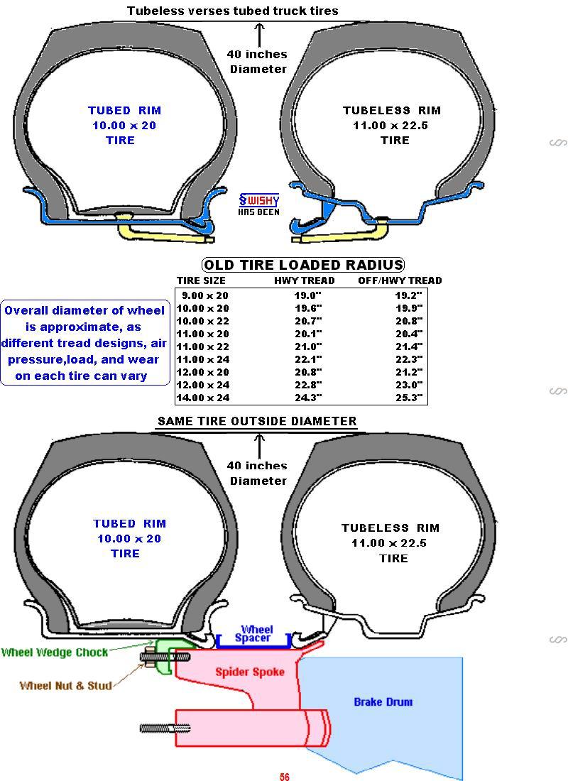

When a wheels is run loose it can wear a few items to make it un tighterable we build up the wheel spacer to take up the slack the wear created
PIc 1 is correct Pic 2 wont fit on spoke [img]http://beamish.beamish.biz/pictures/w/w233-s.jpg[/img]

When we converted 1000x20 to 11R22.5 we also ran tubed and tubless side by side in a dual set up with no worries the Diameter is the same and no worse than running different treads, wear, PSI etc the cost of tubleless is a lot cheaper than tubed + Tube + rust band cya
