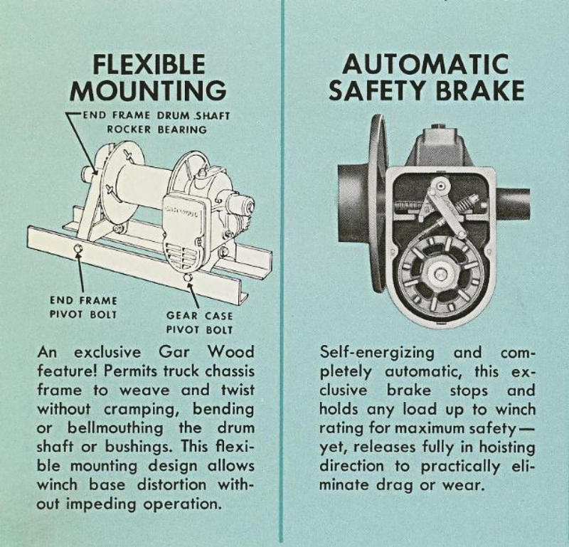

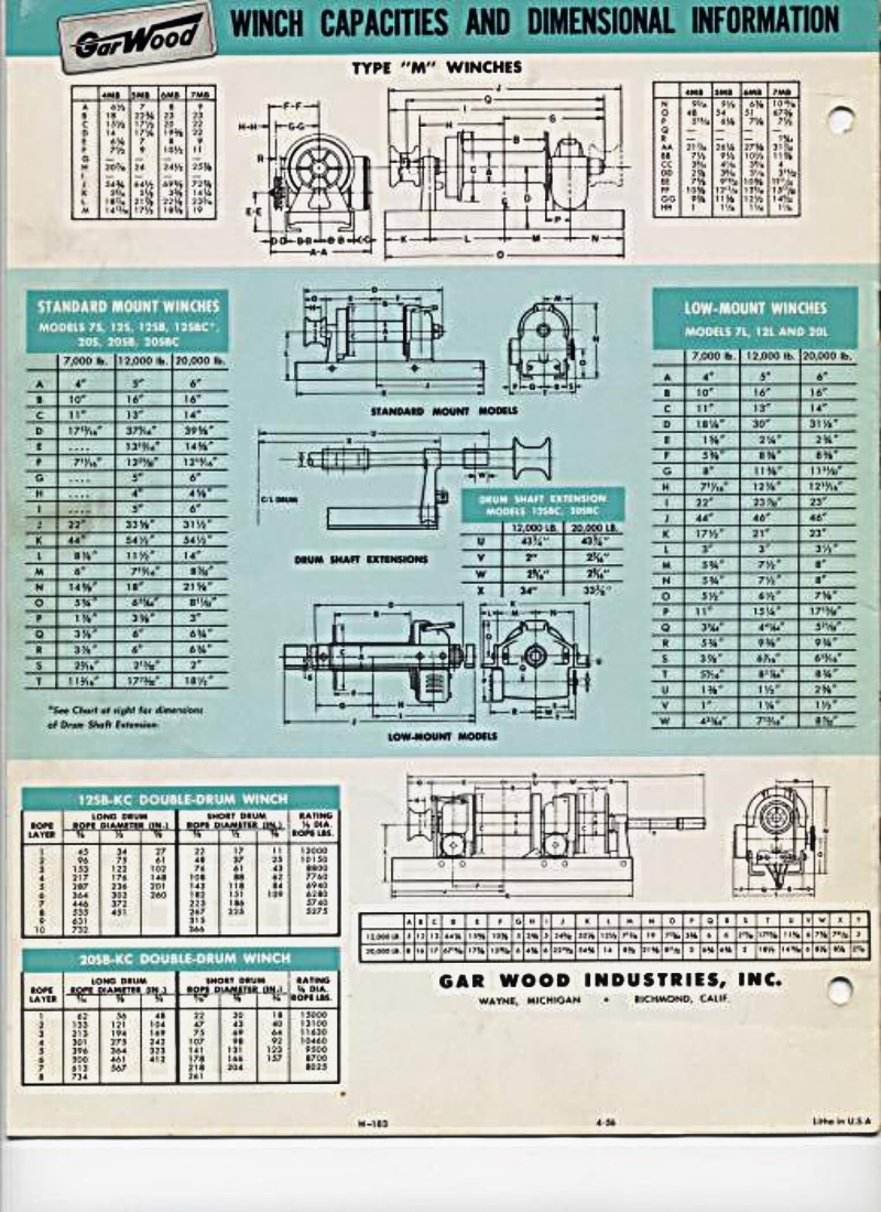

4 0f our trucks have a Garwood 4MB Winch mounted BHind the cab they all have a 3/4" cable that we able to break @ idle revs with a mechanical drive thru chain & Sprokets they all set up with a PTO that has UP - Nuetral - Down control Cya
The standard PTO openin has 6 bolts chek if the gear to run the PTO is a straight cut or helical cut gear cya
1WonTon gudday m8 we have 6 trucks with chain drive winches mounted BHind the cab What R U going to use the wich for? cya

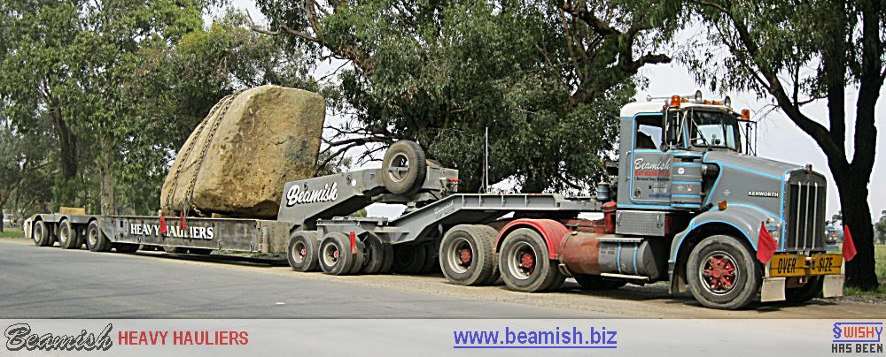

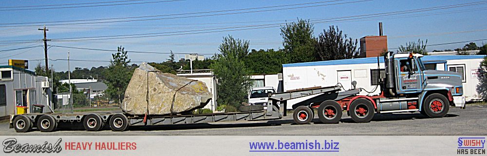

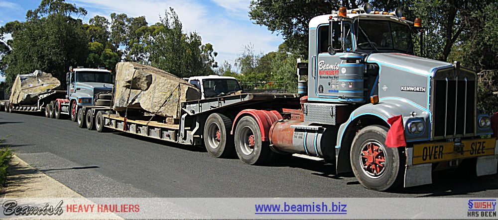

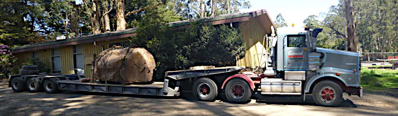

rocks on display @ front gate Hoo sez there aint no money in horse racing https://www.google.com.au/maps/@-38.2035351,145.0670527,3a,75y,51.64h,91.81t/data=!3m6!1e1!3m4!1s2NLXE710Ei5_I12waxoDVg!2e0!7i13312!8i6656 https://www.google.com.au/maps/@-38.2071436,145.0664586,458a,35y,53.93h,44.83t/data=!3m1!1e3 1st time me ever seen a tilting Guillotine gate LOL cya
