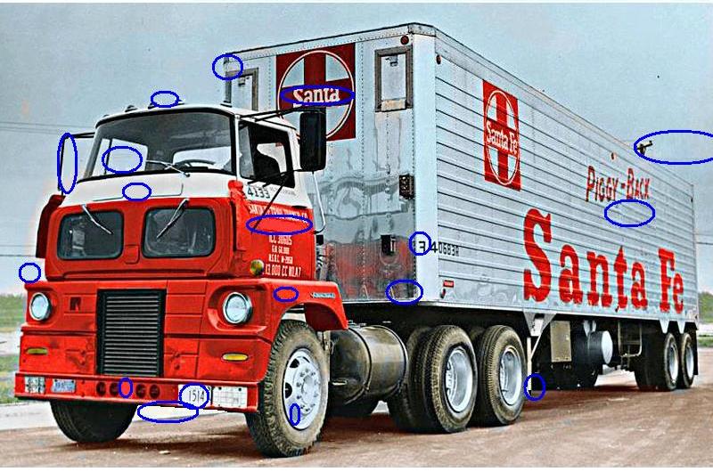

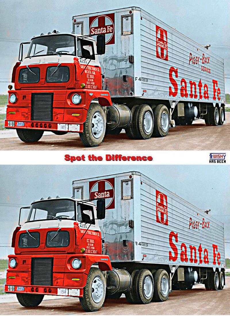

  20. OK here we go Not 4 getn thr top pic is original the lower pic is the pic eye molested U may have to clik a cupla times to get a biggr pic cya
