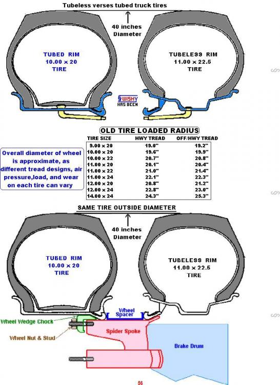

  5. some have questioned interchangerability of Tubed to Tubless tires we changed 10.00Rx20 to 11Rx22.5 and on the changeover was not unusual to have one of each running as duels WotSezU? cya

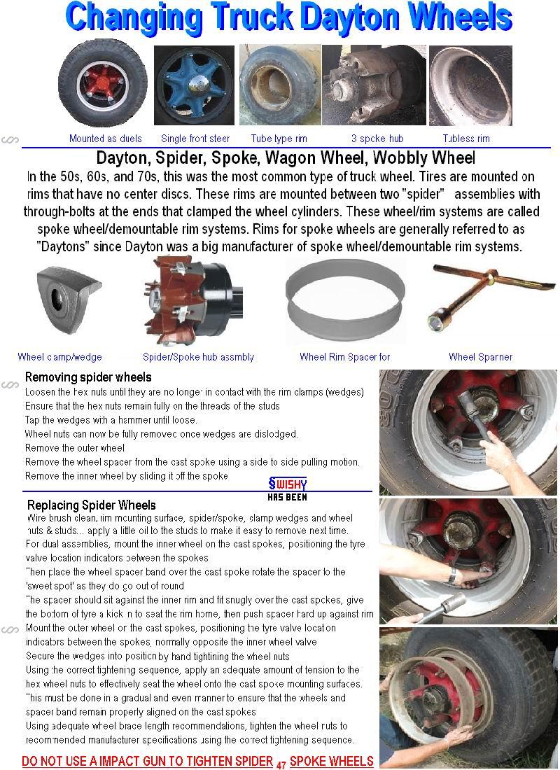

  9. All the tyre shops have rattle guns ....... so theres u're problem right there NEVER use rattle guns to tight spider spoke wobbly wheels (Dayton)

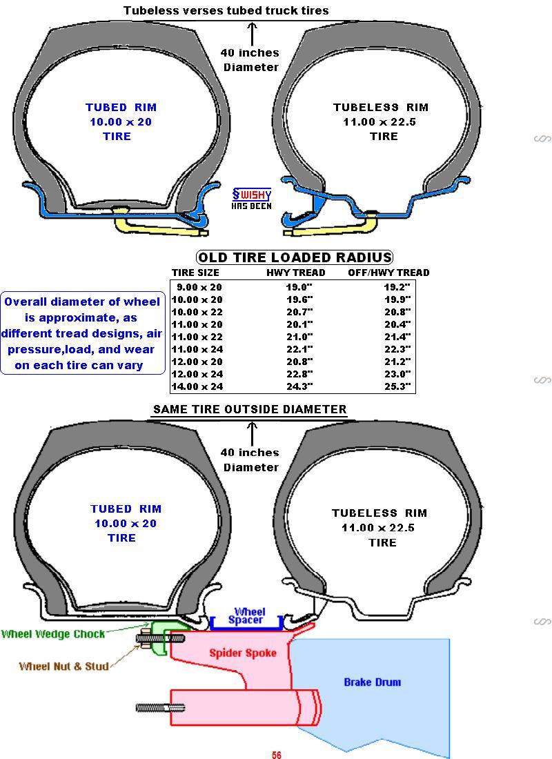

  11. Phildirt gudday m8 a 1000 x 15 is 10inch + 15" + 10" = about 35" a 11R 17.5 = 36.4" dependin on make n tread as they all vary a little https://www.otrusa.com/shop/truck-tires/11r17-5-14pr-sumitomo-st717-tl/ cya
  12. On trucks we changed from 1000Rx20 tubed to 11Rx22.5 tubeless = exactly same diameter on floats we changed from 8.25Rx15 tubed to 9.5Rx17.5 tubless = exactly same diameter No need to swap dayton spider spoke hubs all interchangeable and U can pare up tubless with tubed the following info is not an indorsment but good info cya 2019FS43.bmp 2019FS44.bmp 2019FS45.bmp 2019FS46.bmp

  18. Thanx Mrs About 1974/75 we purchased 2 new trucks to the fleet White Road Commander & Atkinson they both came with tubeless 11R22.5 tyres and all our other trucks were 1000x20 tubed tyres we were informed we can gradually update to the tubless as the diameter were the same and you could run a tubed tyre/rim along side a tubeless
