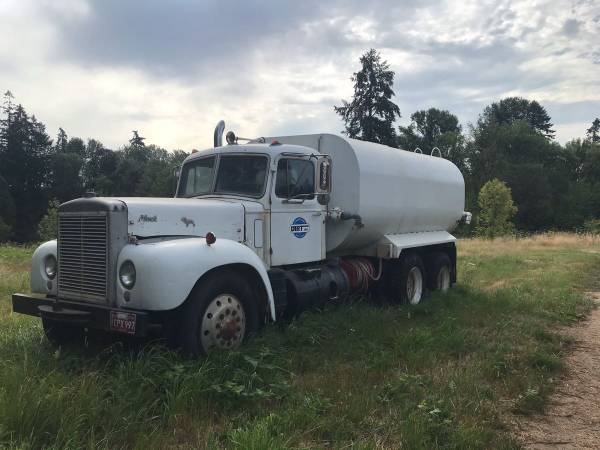

  10. Not mine-ebay https://www.ebay.com/itm/1981-auto-car/293896247938?hash=item446d94da82:g:jtgAAOSwoShf1qHf
