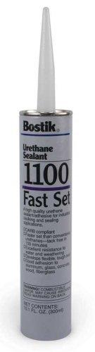

  22. One other thing I used was Bostik 1100 urethane/adhesive to hold the weather striping in the register tracks and the two vertical seals in the vent windows. Those were originally riveted but using the 1100 and letting it set 24 hrs you can't tear them out. We use the 1100 to patch the inside of our refer trailer walls. When it drys it's stuck for good.
