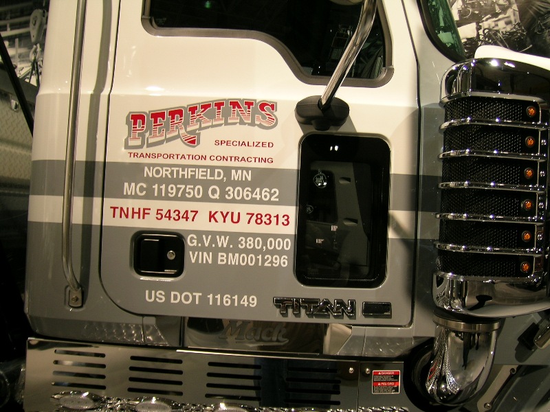

	Is Volvo Good Or Bad For Mack Trucks?daveigou replied to Barry's topic in Modern Mack Truck General Discussion I don't know about you, but there aint nothing shabby about a frame rated for 380,000# GVW. In the past, the corrosion between double frame rails was the only thing that would kill a Mack, with the new generation frames, a double frame is no longer needed in most applications, but assuming your truck is going to be a long wheelbase straight truck with a loader, you can't get away without it. And for power, I don't know anything out there I would rather have than the Mack - Volvo engine.
