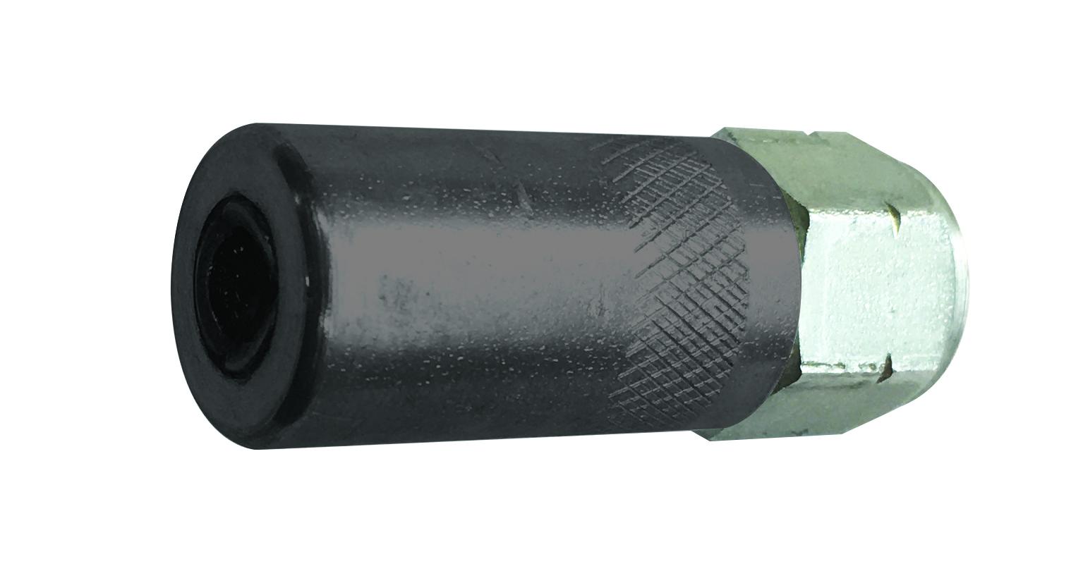

I use a old air tank off a trailer
Mount it vertically and half fill it with diesel
Then a small 1/8th connected to a grease nipple fitting, Zerk fitting you lot will call it
Anyway, compressed air in the tank and forcing diesel under pressure in to the slack adjuster
Slack adjuster needs to be off the truck and clamped in a vice for this
Then on with the rattle gun and all the dry old grease spews out the sides
This pretty much always works and then just pump full of fresh grease
Make sure the locking doohickie (collar) on the adjusting bolt is free to click in and out
This should solve your problems
If the slack adjuster is backing off it isnt locking in the collar
