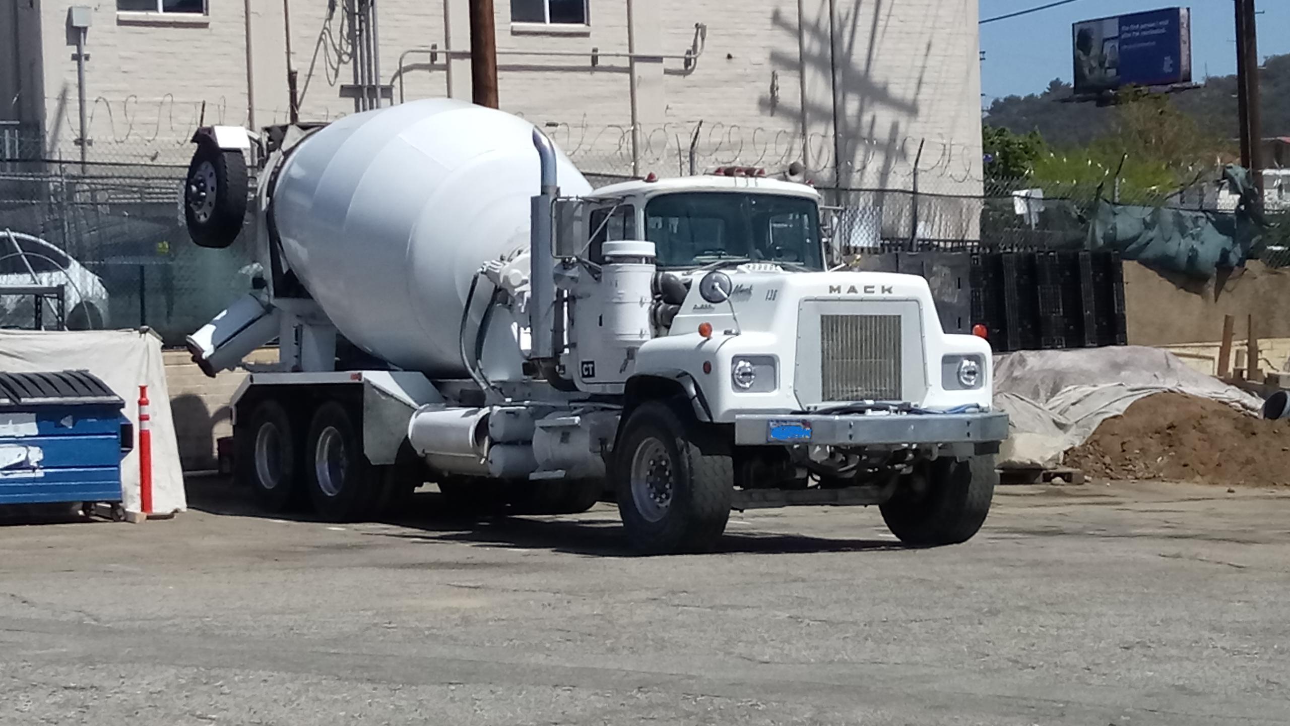

Its a 1976 RL685 with a 9 yard Challenge Cook Mixer, I work it 2 to 4 days a week and love my truck. Last week it broke the rt front main leaf spring and I cant find one anywhere. Its a 20,000 lb front axle 11 leafs 3.5" wide,  Triangle Part # 62-734.  I might have to send it to the scrap yard if I cant find or get one made

Dunno were you live but most major cities should have a spring place that can roll you up a fresh leaf to suit I would of though
Or just take a tape measure and wander around local truck wreckers to find something close enough

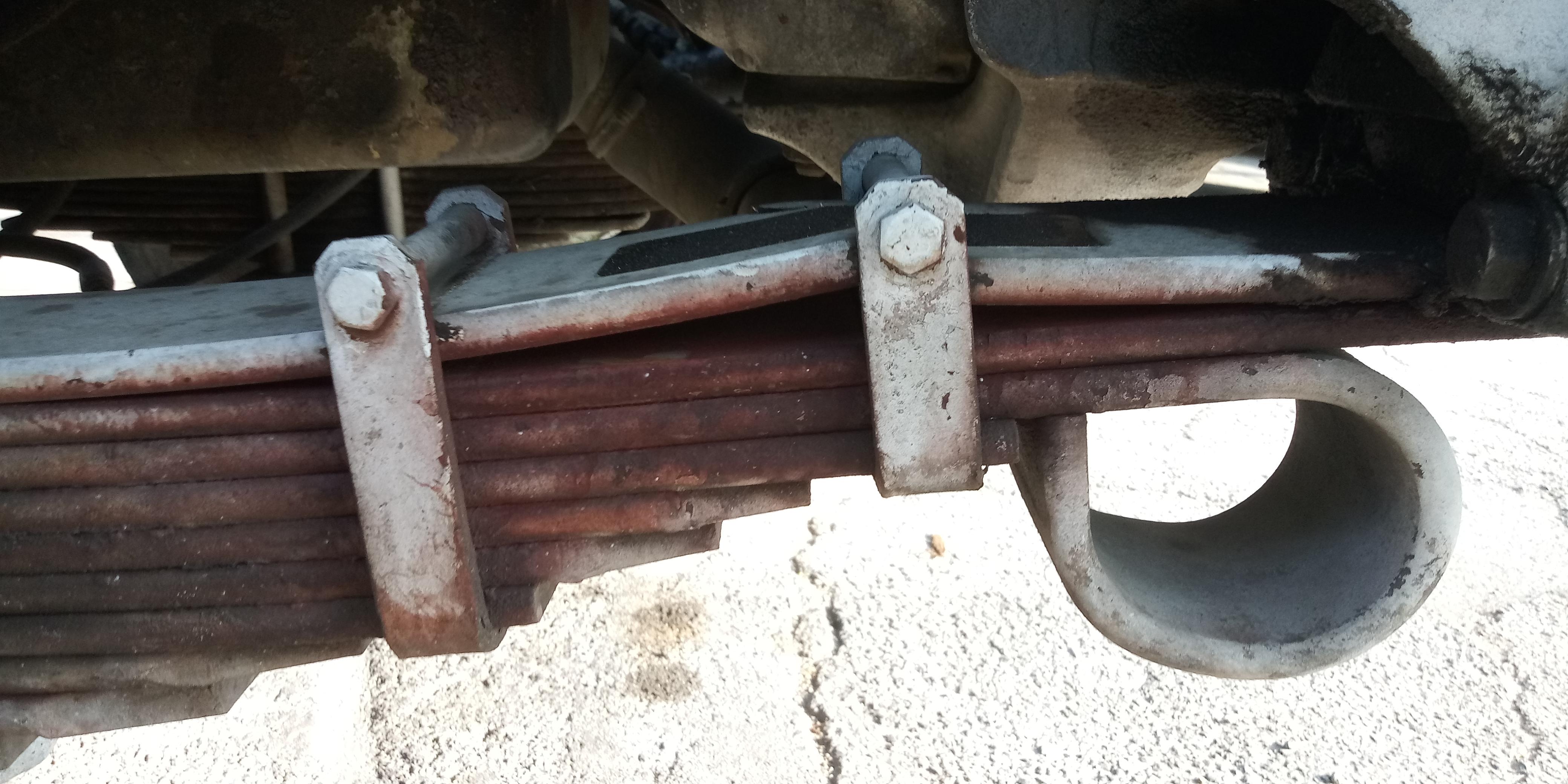

it looks like the main leaf the one with the eye to take the pin is the leaf below the broken one
the top leaf only goes for the ride

I had a broken top leaf on my B model.  They bent it for the eyelet and presto-chango I was back in business.  They rebolted all the clamps too.  Its just a "width, length and thickness" thing.
Edited by Freightrain
