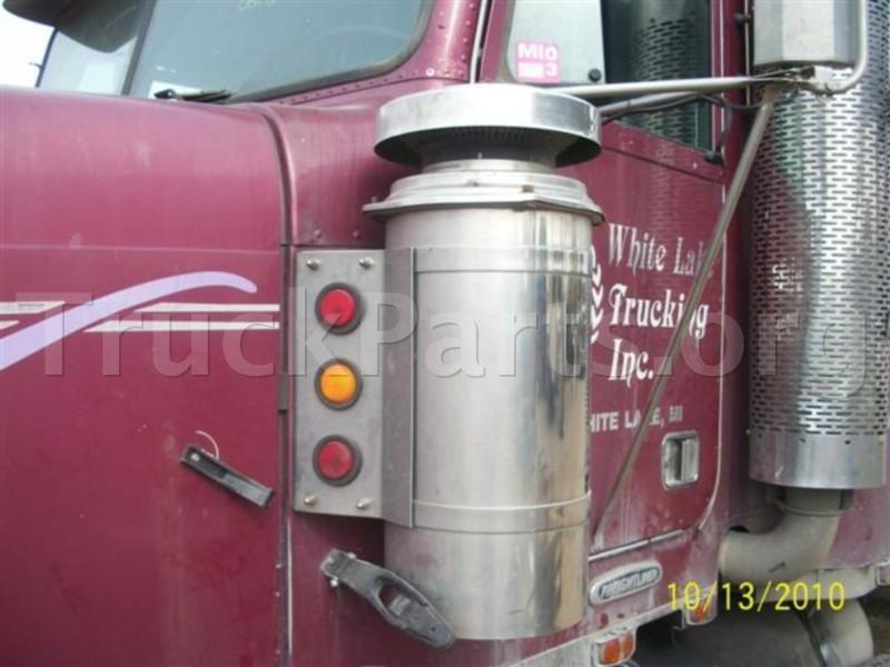

I have three years running an oil bath with my 237.  No problems.  Has not sucked it dry, though I know it does have some oil film in the pipes.  Nothing catastrophic, but I would like to put a dry filter on it someday.  Hopefully a stainless model from something newer.
I did hot tank the filter years back when I painted it so I know it's clean mesh.
Edited by Freightrain
Larry

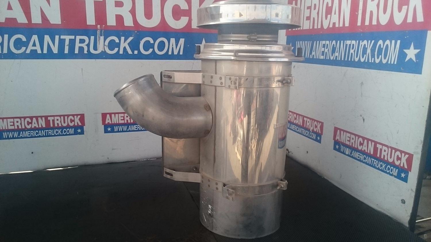

The R model oil bath air cleaners are constructed differently internally than a B series was. They are larger and the oil level is maintained lower in the sump. They too pull oil at times but the plenum being longer doesn't allow much to be sucked into the piping. That is just what I've noticed from being around and servicing both types in my earlier years.
That’s what mine is.   It’s a Nelson.   On mine a buddy shortened it 3” or 4” so it fit right and didn’t go way up the window.    I have it as close to the fender as possible about a finger thickness.     On the 70 series B’s you have more space to slide it lower.  Idk about a b61
on a side  note my buddy is a welder/fabricator.   He said this was the worst stainless he ever welded and was not at all happy with his welds on it.

I am thinking about switching over to a dry air filter system on my B61.  I am still trying to figure out the exact engine specs on it but I know it is the in-line 6 turbo diesel.  What do you guys and gals think?  Keep the oil bath or convert to dry?
Well I  guess you need to ask your self why you want to change it
Oil bath lasts for ever and work as well if not better than a paper element type
Only down side to a oil bath is you can get a bit messy when service time is due
Oil bath are cheaper to own and operate and work far better in extreme conditions
Dunno if -40 changes the efficiency of them as I have never been anywhere that gets that cold
So I would just leave it
