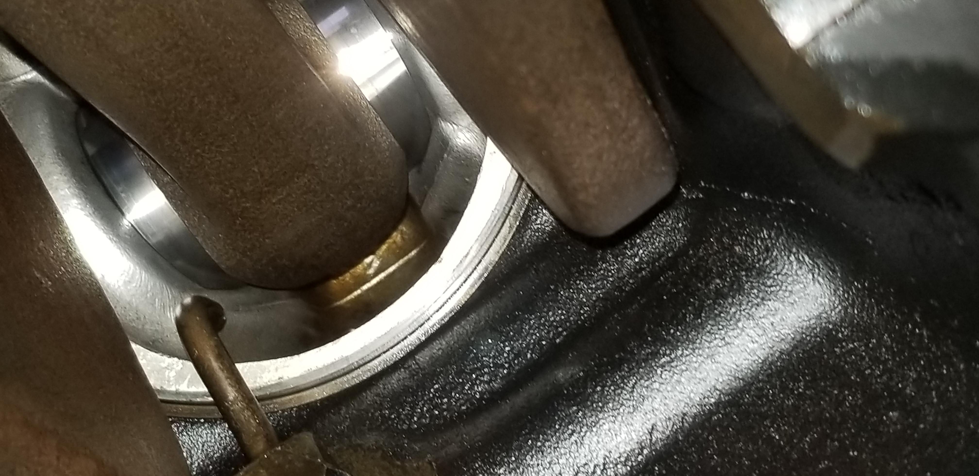

It will take all of these parts plus someone that knows how to size the parts and do the work. Once you past 300hp piston cooling is a must to have it live. The 237 is not piston cooler equipped.
Better to get a 300+ or a 350 and save a lot of time and money in the end.

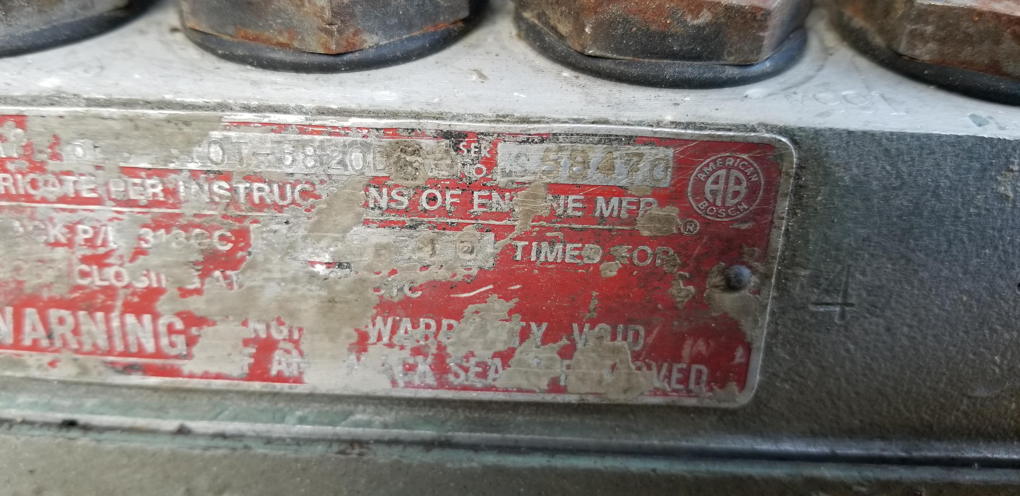

I will get you some numbers from an AMBAC pump book today to have your injection pump calibrated to. Your existing pump will have 11mm plungers and barrels, and the existing injectors should recalibrate to match the new pump output characteristics with minor parts replacement. I will also include the injector numbers suited to the pump output you will be emulating. It is getting difficult to obtain some of the parts for the governor section, but a good pump shop can build/modify existing parts to work. If doing the work yourself, be careful following internet advise as there is much erroneous in nature posted routinely. The turbocharger would best be changed as the "mapping" of the original is incorrect for the recalibration. However, it would still work in the application.
What transmission are you running? A five or a six speed would best be replaced with a nine, 10, or 13 speed with the revamped power output of the engine although either of the aforementioned will work.
This work you are wanting to accomplish is not something you do in a bench vise with a hammer, screwdriver, pliers, and crescent wrench, but will require a fuel shop or you stand a real good chance of a short lived engine.
